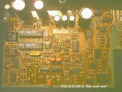

                        Pi and nuts
                        Fellas...Fellas..
                        This is a real Pulsestar II
                        Price was 3000 usd some time ago.
                        Best PI detector in the middle range ever.
                        Someone mention MC68H...processor in it.
                        No it is not.There are two PIC's.
                        Aparatus is not hard to copy and make as
                        U see on picture, but where to find a HEX's
                        for those PIC's. Besides I own PSII for some
                        years and I am not thrill with it. In the air
                        it can detect a Volkswagen Golf II at 3.5m
                        range,but in the ground ...??? It is very
                        unstable on some fields which makes it
                        unusable.I am sorry to splash somebody's
                        imagination and dreams but this is naked
                        thruth.With its coil 45cm radius it is
                        suitable for occassional finds like any other
                        detector.When U test it in the air U be very
                        satisfied ...but in the ground...average.

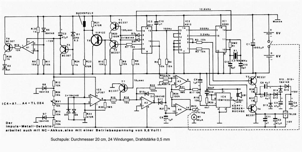

                        And for the end, if U want to make usefull PI
                        and not to waste Your time and money try to
                        make a PI which somebody claim it was Pulse Star I
                        (which is not).It is early German design(kit costed
                        120 DEM in 1990.)and there is schematic

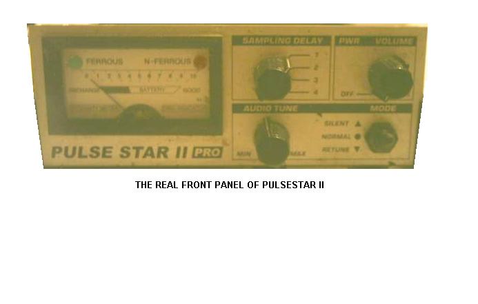

                          Pulsestar II
                          snapshots of Pulsestar II

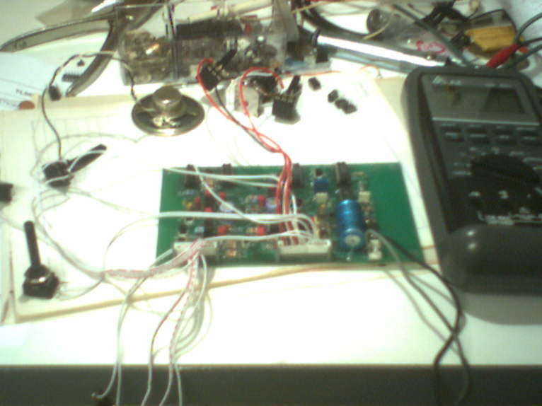

                            I made XR71 and Delta pulse 2-3 years ago.
                            It worked but very unstable.Maybe I am not
                            good constructor,but there are very critical
                            points in the project which U just can't
                            adjust without high tech equipment and
                            instruments as big companies have in their
                            labs.
                            Sorry but i think that you are not good constructor. Last week i finished XR71 and it is very stable. It is not so sensitive as Lorenz with coil 1m x 1m but it is very stable detector. All detectors must have good and clean pcb and good quality capacitors.
                            Have a good day
