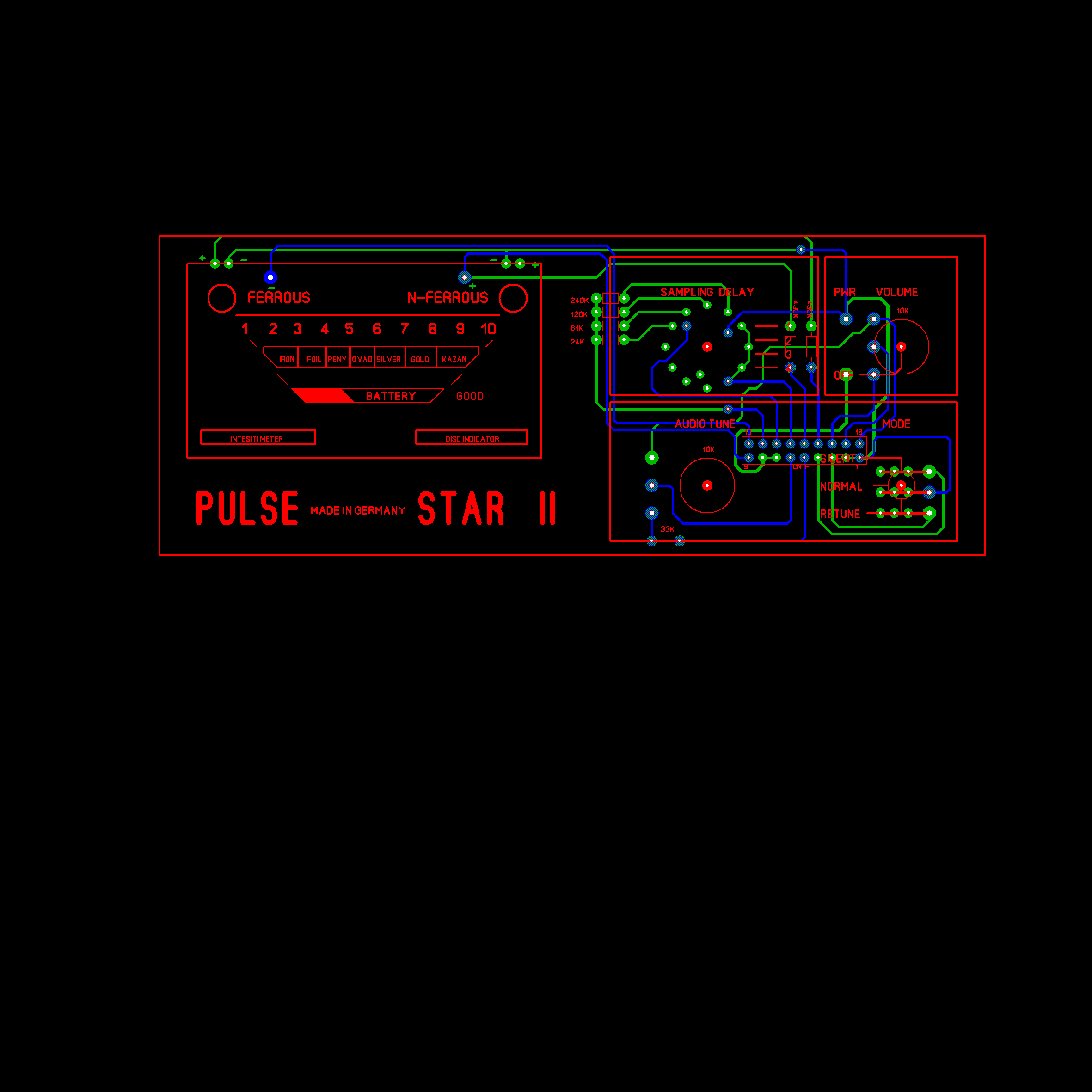

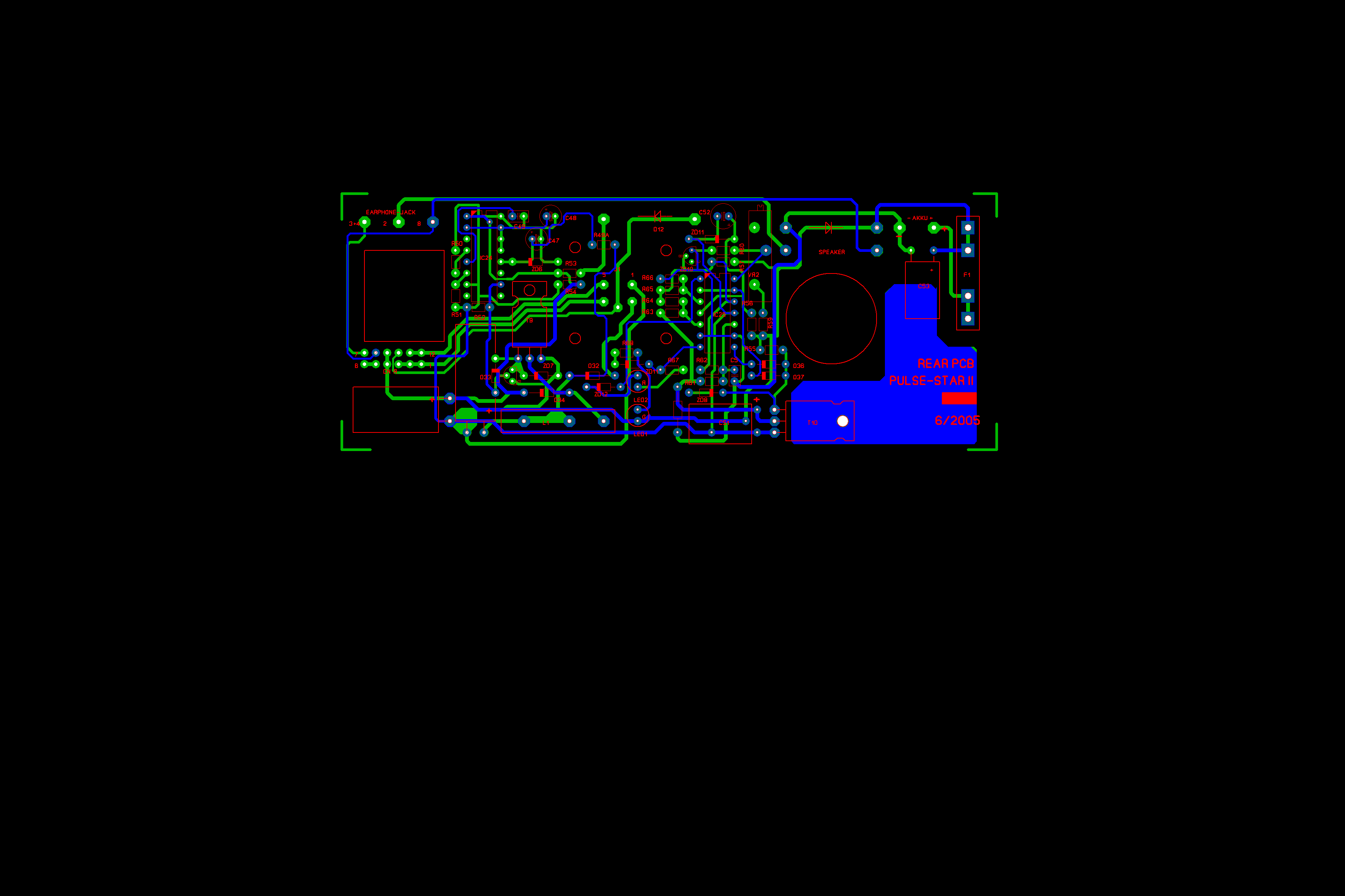

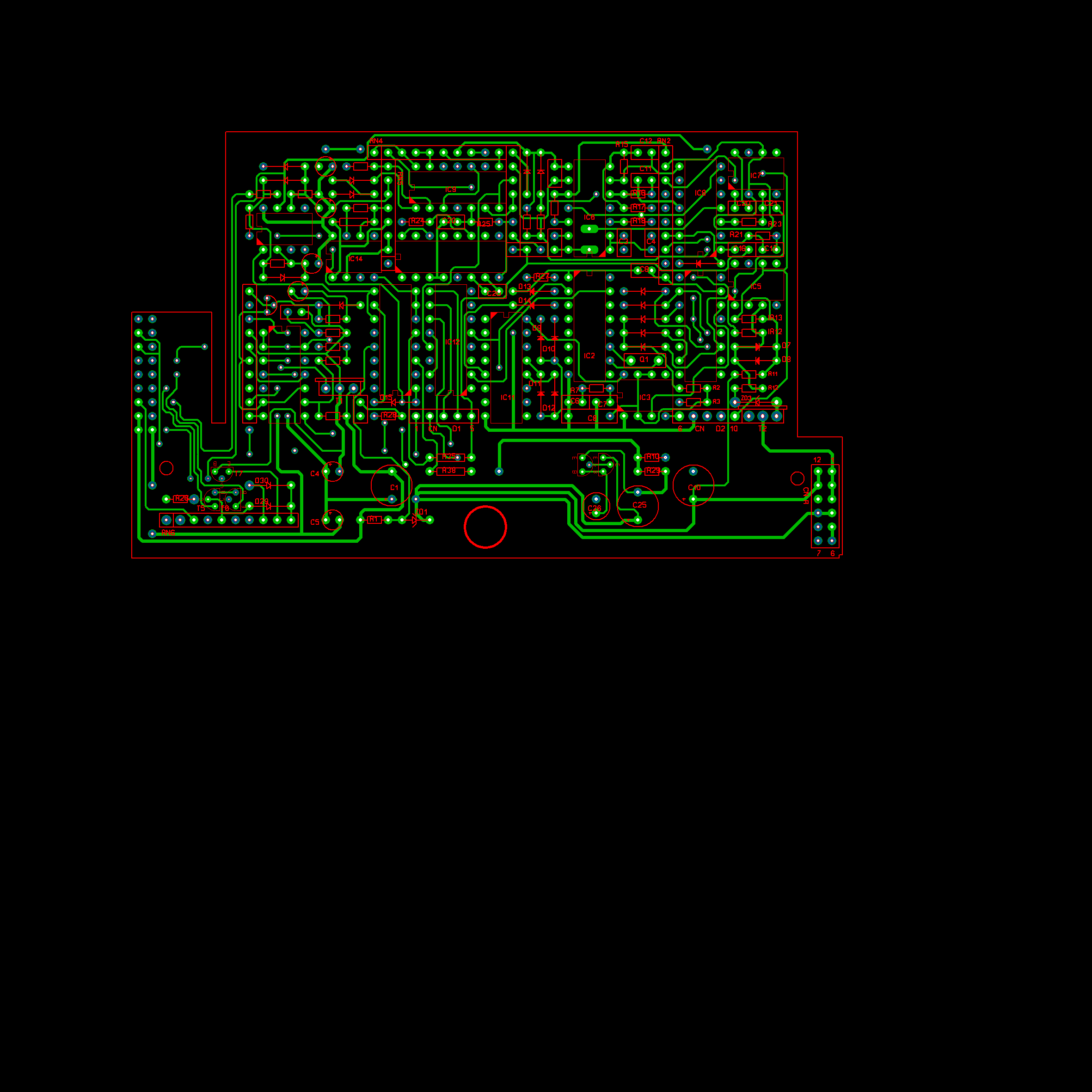

              PSll
              Hi,the puls star l and ll have kinds of versions 1 and 2 and 3 to up.I have some version of it`s shematic and pcb.I upload some files one of the versions.

                  Now about PS II . If u look at the meter it says Discrimination. So it must be a version with microprossesor? I am not familiar with PIC ..AT90s.. so i can not build one of them. Aban may tell us about the versions of PSII that he have. At the forum there is a schematic of PS with 2 meters. Can somebody say to me what is the second meter?

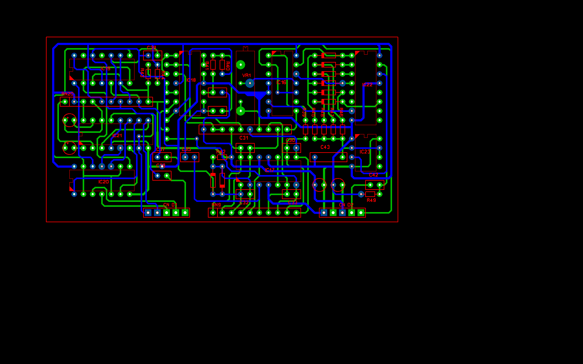

                        • #72
                          help
                          Any body can send me a both sides(but separate) of pcb for XR71?
                          I would like to try to make it.
                          Or any other good PI project.Even is better if it is one sided pcb.
                          my mail is:
                          [email protected]
                          Thanks in advantage.I want to exchange schematic....

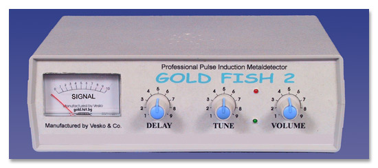

                              GOLD FISH 2
                              Hi Aban,
                              i know PulseStar II and Lorenz 3 & 5. What is Gold Fish 2 ? Is it PI detector? Please send us some links and pictures of GoldFish 2 PCB. Have you some info about this device - PCB or schematics ...
                              Best Regards: FLEX
                              • #75
                                GOLDFISH2
                                Yes,it is pi disc detector and it can detect at 5.5 meters in the ground.
