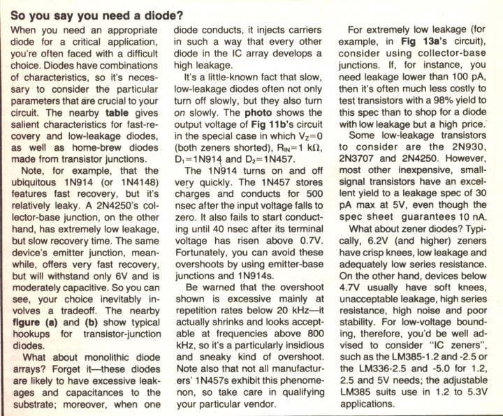

                  Bounding, clamping techniques improve circuit performance.
                  Found the article. It is in EDN Nov.10th 1983, by the famous Robert Pease, title as above. Tells you nearly all you need to know.
                  Eric.

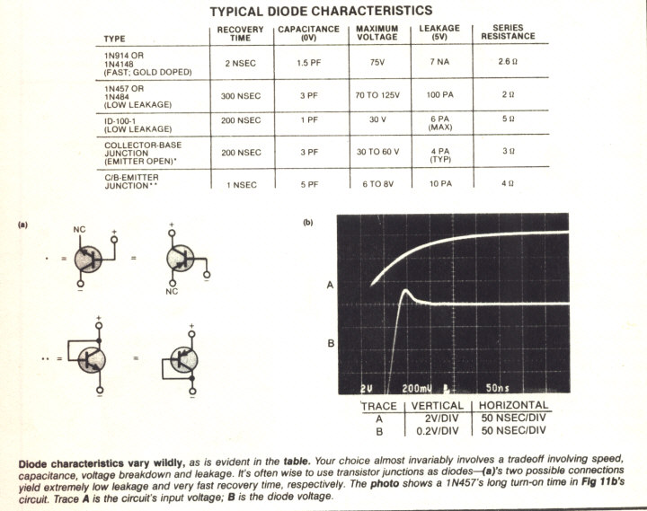

                        Hi Reg and All,
                        Here are a couple of extracts from the article I mentioned. There are too many pages to scan and post, but these two parts give some relevant information for choosing clipping diodes. The article is 1983, so there may be other sources of later info.
                        Eric.

                          Hi Guys,
                          And if you look at the schematic diagram of the 5534 opamp you will see the clamp transistors on the input. Also see other diode transistors through out the circuit.
                          Alot of IC diodes are formed by making transistors in the silicon (since they are doing that anyway) and then short the base to the collector to make a diode.
                            Hi JC1,
                            I've actually run a 5534 without any external clamp diodes. It works fine on my low power detectors, where I am pulsing 0.1A through the coil, but on a standard unit with say an IRF740 pulsing at a few amps, the internal diodes blew. Or at least one of them did. This goes back to my point about peak diode current on the back emf spike.
