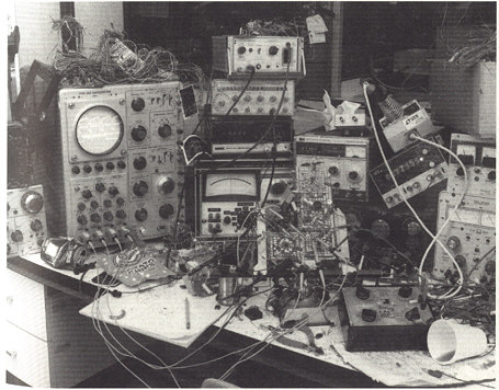

          I can't.

            Hi Eric,
            Think I know the source of your noise.
            Really like the soldering iron perched on top. Too real.

              this chaos in a field? ... originally!

                  Hi JC1, and all who might be worried about my bench.
                  The picture came from a book on analog circuit design. It's always amused me, as I had an engineer whose bench looked just like that - after he had tidied it up!

                      Seen the bench!
                      Hi Eric,
                      Yea, I have seen that bench before. Don't know if that was Jim Williams or one of the other EDN, Electronic design, or Analog Devices books. But I've seen it before, and spent some time myself sitting infront of a 555 oscope.
