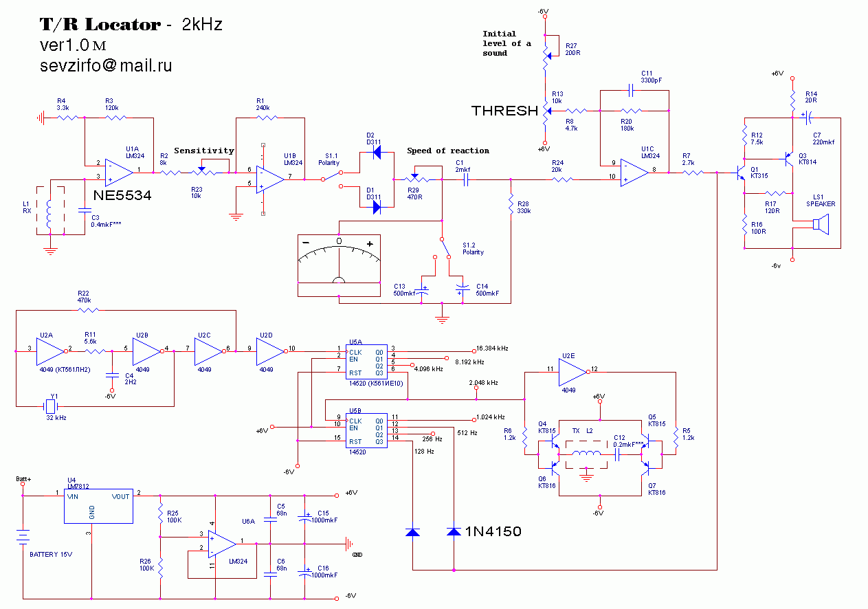

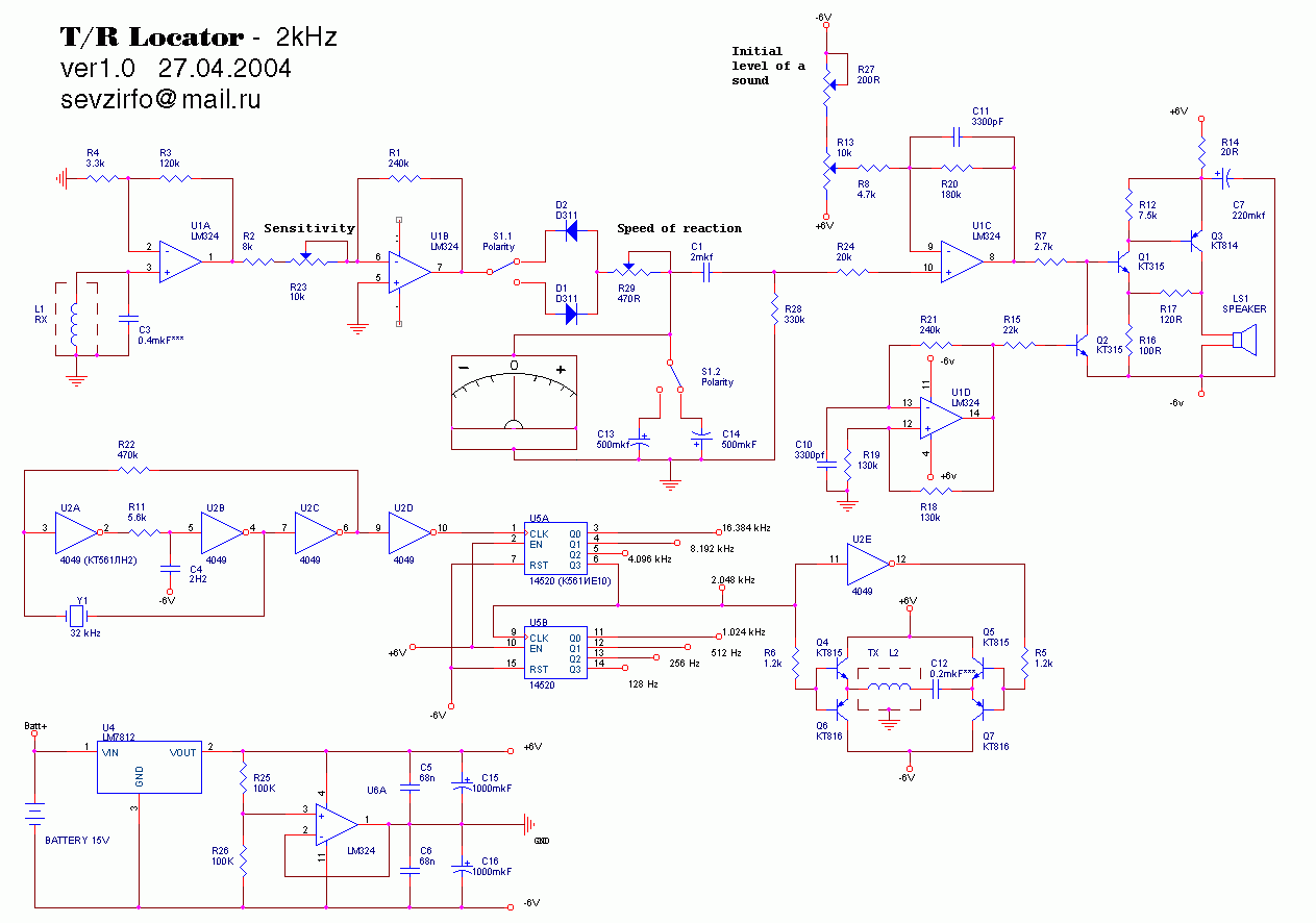

Hi Igor MN. Why you don't build Servirfo's two box metal detector. It looks very good with easy components
Geo
Hi Geo
Thanks for advice, but i can't find Servirfo's two box metal detector on the net,even google doesnt saw him.It will be a huge help for me ,if You have his schematics post it here for everyone,please! Long live Helas
WOOW!!!! GREAT SITE,LOTS OF PHOTOS,GOOD SCHEMATICS,JUST WHAT I ALLWAYS WONTED ))
RUSSIAN BROTHERS ROCS! MY RUSSIAN IS VERY RUSTY(LIKE ENGLISH ),BUT I WILL MENAGE SOMHOW. GEO YOU MAKE MAY DAY HAPPY )) THANKS
Kt, while you're at could you maybe translate some of the Russian part numbers, such as the transistors, diodes and U5. This looks like an interesting machine.

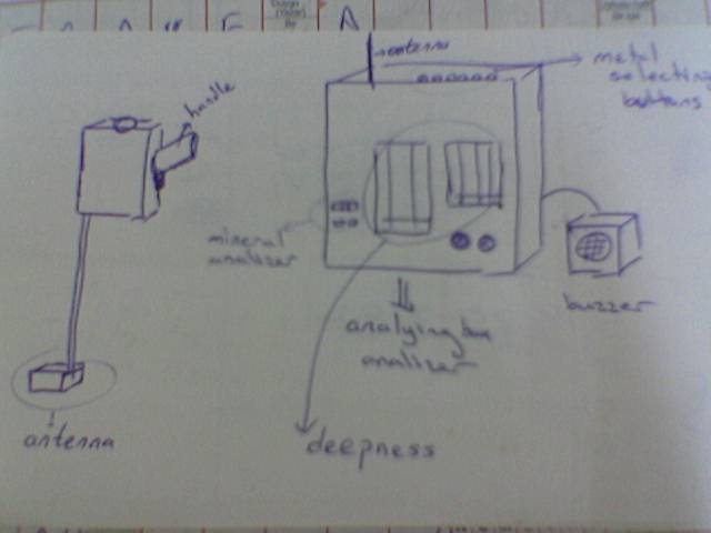

is there anyone who knows this machine.I heard it is used in russian army.
I searched but can not find anything about it.mine was stolen .it was really good that we find gold coin at 4 meters dept.I want russian friends help.
I think that nobody really believe that there is detector who can find a coin at 4m depth (I believe that the max depth for a coin on air is 50 or 60 cm). Geo

Jungle Law reads : if you wish to buy nothing, there will be nothing. in any words, what you really wish to get out - the capitalizm or the socialism system?
so Ivan (sevzirfo) HAS given you up only the schematic. because he built it on one montage PCB, for himself. because he does not sell PCB's. because he simply has not the PCB's for the selling.
anyway, you have full Right to use EAGLE or another CAD soft for the layout tracing (sic!)
