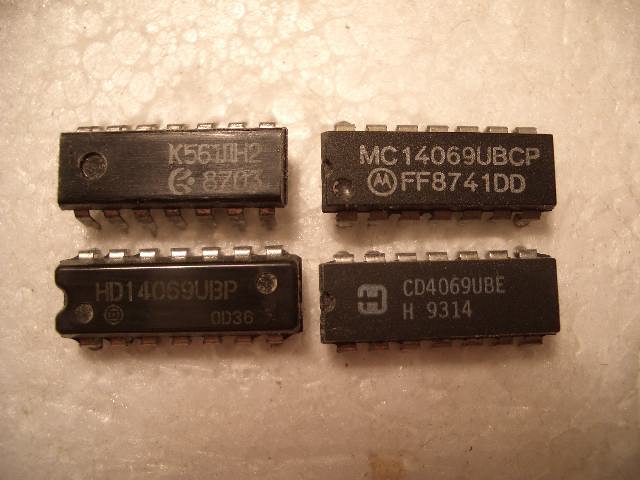

            Hi KT315 and thanks for the corrected schematic.
            The detector circuit is almost finish, but i found one more problem. U2 (4049), is a 16 pin IC, and the schematic show that this is a 14 pin IC.
            Looking the PCB from Sprint Layout, it saids that is a 14 pin IC.
            Can you help me with this?
            I read data sheets for 4049 and all saids that is a 14 pin IC.
            Please help me.
            Nelson

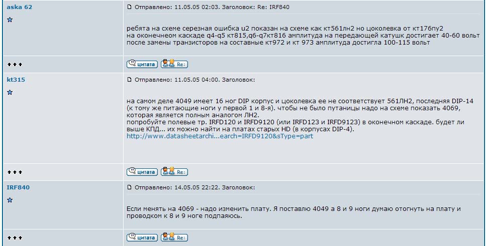

            • The detector circuit is almost finish, but i found one more problem. U2 (4049), is a 16 pin IC, and the schematic show that this is a 14 pin IC.
              good question Nelson! you are right. this problem is because Ivan takes IC's model from ORCAD library and does not the correction. a main his target is to speedy demonstrate the schematic and that's all but really he uses analog IC (in our electronic world) K561LN2 in DIP-14 on layout. not the 4049 in DIP-16! so K561LN2 is really full analog of 4069. 4049 and 4069 has different pins' basing but functionally equivalently. please allow this, compare the datasheets, and look attached photo.
              regards.
              • TR locator
                To bad to hear that.
                Ok, i think this it´s gona be more work trying to find the correct IC.
                I was looking data sheets of CD4049 and CD4069. Aside the number of pins, everything looks like the CD4069 has everything inverted. My knolegment of electronics is very limited, so if you can help me, i request a copy of datasheet for KT561LN2 in 14 DIP version.
                If anyone can help, please let me know how to proceed. Should i have to do mods to my PCB.
                Here i can get CD4069, but i´m not shure if it will work. First view is telling me that it won´t work.
                My work has almost finish, but this thing is real rock on my way...so please help me with this.
                Nelson
                regards.
                            Nelson
                            Hi Nelson. There is not problem, just little work more. Take a small pcb, put 7+7 pins, put the 4049 and connect the pins of 4049 at the pins of pcb so to match with the pcb of T/R locator.
                            • hi Nelson and all. you must not be embarrassed. this mistake, I mean anyone can expects that K561LN2=4049, are repeated in all reference books in russian. but really K561LN2=4069. if you do not want to correct PCB then you can order 4069. I wrote about the mistake in forum of Ivan, but you may be know that when people married they disappear from WWW on very time I hope Ivan will be back...
                              ... I must also note for all that main difficulties will be for you the tuning of contours in resonanse (then you can get maximum possible reply reaction on metall). you must do prelimenary tuning in your room (I hope your working place is not kitchen) but final tuning out of your house. better way will be if you will do the operation in a field.
                              • TR locator
                                Ok KT315 and one more time, many thanks for your support.
                                Tomorrow i´ll get CD4069 and place it on the board.
                                Also, i´ll look for TIP32A. Now for testing purposes i´ll put TIP34 that have a bigger case, but i´ll run it away from the pcb board.
                                On my next message i´ll send a picture of my work.
                                Nelson
