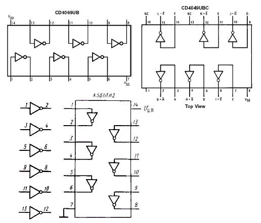

      Plaseeee, let me know if i´m correct with just placing on the board has it, the CD4069 (U2)
      I don´t whant to make any mistakes on the circuit.

        My question: If i don´t make this , can i replace 4049 by 4069 and just place it on the board has is marked or should i have to do the same thing that you explain to me if i ll use 4049?
        There is not problem, just little work more. Take a small pcb, put 7+7 pins, put the 4049 and connect the pins of 4049 at the pins of pcb so to match with the pcb of T/R locator

        Hi Nelson. There is not problem, just little work more. Take a small pcb, put 7+7 pins, put the 4049 and connect the pins of 4049 at the pins of pcb so to match with the pcb of T/R locator.

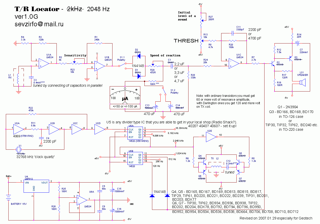

              Hi KT315, today i try to run the detector, but after i turn the power on i noticed no sound. After taking a look to the board i found a very big error done by me. On the place of C7 (220uF electrolitic capacitor), by accident i placed a 100 ohms resistor. Of course this short circuit could have done some elements damage on the board.
              Now i which to know wich elements could be damage. I think that Q1, Q2 and may be Q3 are burn.
              I measured U4 (LM7812). Input voltage is 12 volts and output voltage is 8 volts, not 6 volts.
              Taking a look to Sprint layout file i checked all tracks that comes from negative pole of C7, and this show me that may be other components like U1 and U6 (LM324), U5 (14520), Q6 and Q7 (TIP32A), may be are damaged too.
              So i need your opinion to get the problem solve. By know i remove resistor from C7 position and i placed the correct capacitor (220uF).
              Regards.

                        "Hi KT315, today i try to run the detector, but after i turn the power on i noticed no sound. After taking a look to the board i found a very big error done by me. On the place of C7 (220uF electrolitic capacitor), by accident i placed a 100 ohms resistor. Of course this short circuit could have done some elements damage on the board.
                        Regards.
                        Nelson"
                        But not answer yet to this stupid mistake made by me. I need to identify wich components are burn or damage. Can you or anyone more skilly than me help me.
                        Nelson

                        • Hi Nelson,
                          one thing you can check is your battery voltage. The input voltage (battery) must be more than 12V for sure....14,4 or 15V is okay.... otherwise the voltage regulator doesn't work propper.
                          Chris

                            Hi Chris and thanks for your information. What about if i just eliminate the regulator and use direct 6 volts.

                            • I measured U4 (LM7812). Input voltage is 12 volts and output voltage is 8 volts, not 6 volts.
                              Nelson, 7812 gives 12 volts. very simple rule - 2 last numbers are output voltage. 7805 - +5 V. 7806 - +6 V. 7809 - +9 V. but 7908 - -8 V. 7912 - -12V. 7915 - -15 V. etc.
                              Chris is right, you must use input voltage with some reserve, so Uin>12+2=14=Uin min.
                              no problem, you can eliminate the regulator and to use 6-12 V of input voltage.
