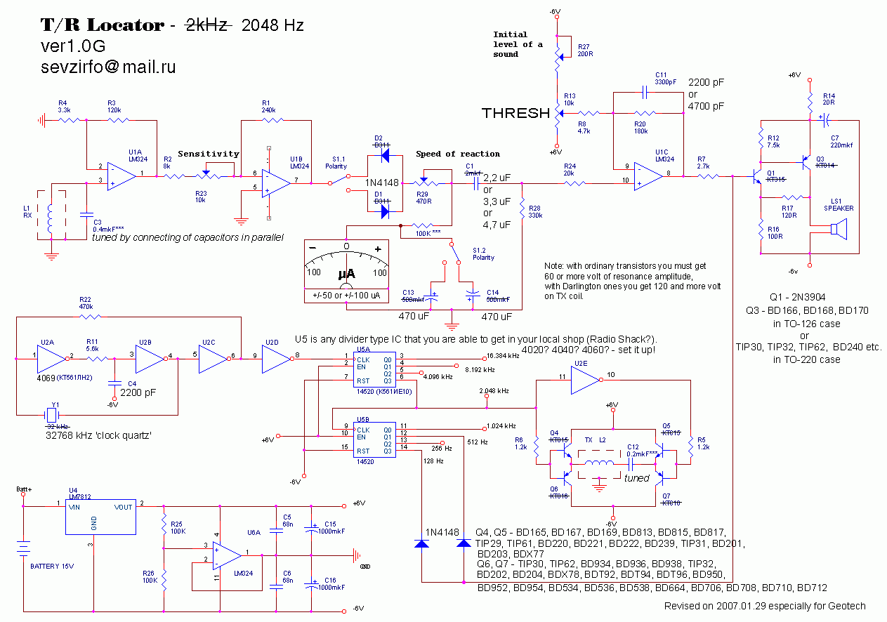

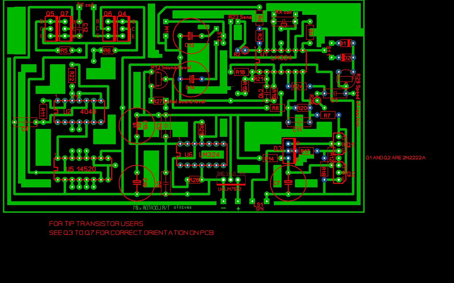

    Hi to all.
    Here i´m sending the pcb that i made for TR locator.
    My question is if there are any way to know if the unit is working before instaling the coils?
    Instead of U2 (4049) i installed CD4069, that KT315 saids is the same. Phisically was installed has is noted on the PCB.
    The detector make no noise, so i really need to know if this is working.
    I request to KT315, Geo, Esteban, Detectoman or anyone that can really help me with detail information, because my electronics knolegment is too basic.
    Nelson
    Can anyone tell me if is possible to test the sound of TR locator without the coils placed. i mean on the table is there any way to test it before i go to the field.
    Nelson
    • Hi Nelson. Maybe if you put your finger on R13 or on R29 to hear a noise. If you hear the noise then the audio is ok. But if you don't connect the coils you can't test the locator to see if it works.Also you can make 2 coils with small dimensions only for the test. I don't know if you have the full pcb with jumpers. You must connect some jumpers to work the detector. For examle the 4069 wants +6v at pin 14 and (-6v) at pin7. If you have not the pcb schematic with jumpers write me to looking for it and to mail you,

            No i don´t have the pcb with jumpers. This is the version made on Sprint Layout and i don´t know if there are another version with jumpers.
            Also, 4069 was mounted exactly has show on the pcb for 4049, is this ok?

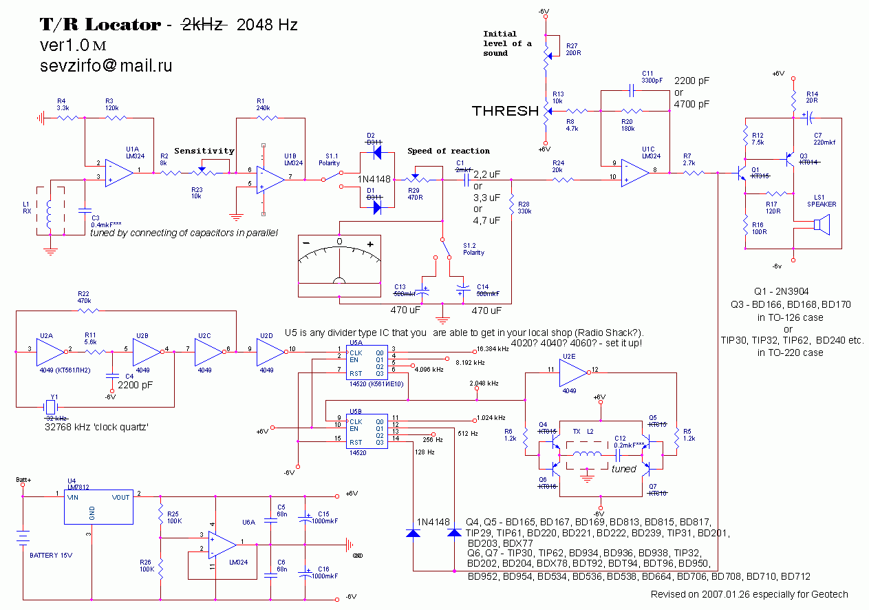

                          Ok, let´s see, i have check the original schematic, the last one corrected by kt315, the pcb with jumpers made by Gary and the conclusion is, i m confused. You said that 4069 wich is the replacement for 4049, on pin 14 needs +6 volts. Now if you look to Garys mods on pcb, the original schematics and the one modify by kt315, none of this show +6 volst on pin 14. Also if you take a look to the last schematics and parts replacement that kt315 show us with details, we can see the same thing on 4069 (U2). Look to the shematics with 4049 and the other with 4069.
                          So Geo, Gary, KT315, Carl or anyone that can help, plase take a look to the TR Locator information posted here.

                            Hi Nelson,
                            I'm not surprised that the digital inverters do not have the power supply pins shown. This is quite common where digital gates are concerned. However, there is often a table somewhere on the schematic listing these implicit power connections. Personally, having briefly studied this design, I cannot imagine that this detector will work very well.
                            You probably just need to take this one step at a time. The first step would be to check the power supplies are generated ok. In other words can you measure +6 and -6V at the power pins of all the relevant ICs?
                            For step two I would check that the oscillator is working, and (if so) does it oscillate at 32KHz? Check this at U2D pin 10.
                            Step three - Check the outputs of U5A and U5B to determine if the dividers are working ok.
                            Step four - Check there's a signal across TX L2.
                            Once you have the TX path functioning properly, you're nearly home and dry.
                            After that we can start debugging the receiver section.

                              • Ohh another error . At U5 you must connect pin8 to -6V and pin16 to +6v.
