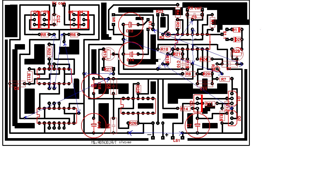

            Geo,after lots of hours on net,i found PCB LAYOUT OF T/R LOCATOR !!!!!
            needed to download few programs for layouts,and experiment with them.Finally,succes! but,some tracs(shorttrucs)can't be displayed when pcb is changed into a BMP.not a big problem for those who know to read a schematics.

              Convert the BMP to a JPG.
              There are numerous programs that will convert formats.
              If you can't, email it to me and I'll convert it.
              I can also edit the tracks if I know which ones.

                  I finaly made it!!! here is lay out for T/R locator(IN BMP formate!).simple,no doubt!
                    Here it is in JPG
                      Guys,need some competent opinion about this layout,to me seems ok.
                      KT315 ,can You please specified what is most common(europian) replacement for each part(in russian)
                      For those interested coils are each 38 cm,150 turns of 0.4mm elamed wire(looks fat ),dont understand if shilding is necessary( kt315 must help here)
                      enjoy
