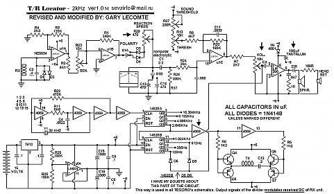

      What about Replacing Q1, Q2 and Q3 with an LM386.
      (Possibly also a Trimpot for a Preset Volume adjust, which could be a changed to a regular pot if someone wants that.)
      good idea, Gary!
      I Don't have that Crystal, the Closest I can come to it is a 27 mhz CB Crystal.
      All that will probably do is change the resonant frequency and coil size a bit.
      clock crystal 32 kHz is very commonly used. you can find it on old system PC board without a problem. all old and new China hand clock with LSD has it. but if to use [xx] mHz the divider will take some additional power loading I see 26 kHz crystal in Whites schematics. is it accessability in your world? I do not see a problem, if you will take 100 kHz crystall. ceramic crystalls on 300-400 kHz you can try to ask in a shop, used in TV remote control.
      Other than that, I believe I have all the parts in my stock.
      ALSO:
      Chris2 WROTE:..but you still need the GATE IC for the TX circuit!
      use 4069 or 14069. no a risk!
      I Assume that is where these Two, 1N4150 Diodes are to be used?
      1N4150 is such as 1N4148 but on more low voltage. there are not a big difference what diodes you want to use in this schematic. again, no a risk.
      WOOPS, Sorry I Mis-Read that Frequency.
      Always Thinking in Mhz.
      But No I Don't have easy Access to a 32 Khz Crystal.
      I live in a LITTLE Town, Population 485, Far from any suppliers.
      Yes I know that 1N4148's will Replace any of the diodes.

                          Here is my Revised Schematic:
                          http://www3.telus.net/chemelec/Proje...TR-Locator.png
                          The PCB is Now Completed and I will assemble it and see if it works over the next few days.
                          The PCB is done in "Quick Route 1".
                          Its an OLD, Registered PCB program I bought years ago from England.
                          It was made to operate for Windows 3.1.
                          Does 8 Layers, plus top and bottom screens, plus much more. Even has auto-routing, but I never use it.
                          The Entire program is under 500Kb and has good graphics.
                          The Schematics are done in "IPPlus" a software program that came with one of my Digital Cameras.
                          I personally have no use for this detector, Just Doing this for you guys.
                          Take care....Gary

                              • hi All. I did revise Gary's schematic, my viewpoint you will note there. I hope now schematic is clear.
