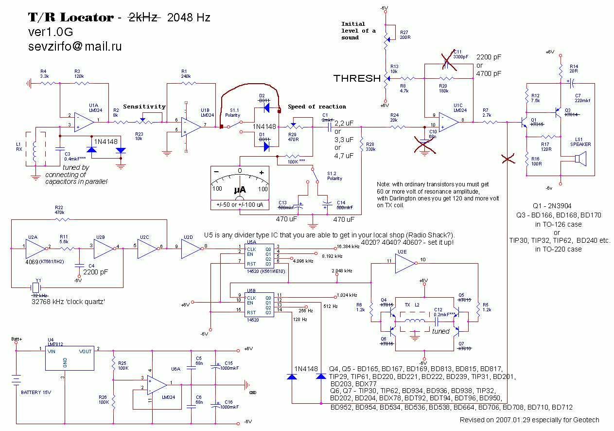

  • I have found the Error I made on the Board and corrected it, so It Now works good.
    Without actually making Full Size Coils, I would say its better than any other designs I have tried or designed myself.
    I will now Print off this new corrected board and assemble and test it, Just to be sure.
    One thing I didn't realize till now is Speaker operation is Not Practical. The Tone Changes are too Suttle to be heard from a speaker.
    However, Headphones work well, so I will add pads for a Current limiting Resistor on the board.
    This is the best way to protect against damage when using headphones.
    Even though I will Post the PCB Design and my final schematic, I realize not all persons can make there own PCB, So I would like to know, All the persons who are interested in getting a board from me.
    Take care.....Gary

      • hi Gary. some experiment you can do. if you will change of the schematic to what I did image here you must get good acoustic effect like to microphone howling.
            I Already Get That ringing effect.
            The PCB is now revised and it works fine.
            I will post all the info as soon as I get some time to scan the PCB and Re-do the Schematic, Showing the parts I Used.

                  • Here is My Revised Schematic, Including the Parts List, As I built it.
                    http://www3.telus.net/chemelec/Proje...ed_T-R_Sch.gif
                    PCB and Parts Overlay to come soon.
