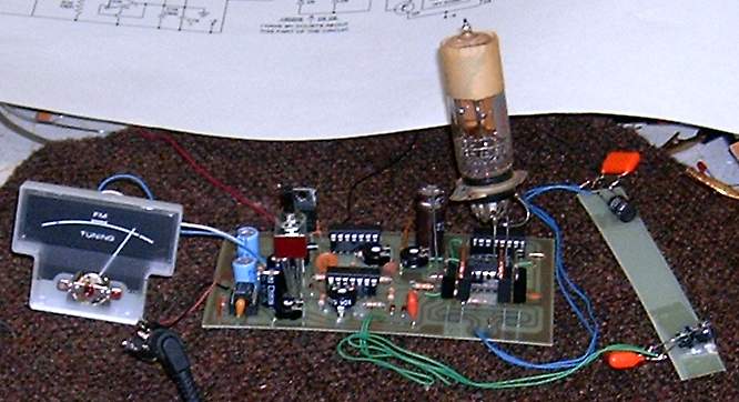

    HERE IS THE COMPLETED ARTICLE:
    (My TEST SET-UP, PCB, SCHEMATIC AND PARTS OVERLAY.)
    http://www3.telus.net/chemelec/Proje...-R-Locator.htm
    Nothing better to do on my Birthday, but this for you all.
    Hopefully No Errors on it.

      Just for Curosity, I tried a 50Khz crystal in this circuit.
      Works Well also. See Picture.
      Sorry For the Slightly LARGE Crystal. Its a Dual crystal of 32Khz and 50Khz, +/- 0.001%. out of a Watch Timing Machine for OLD Mechanical Watches.
      By the way, Typical Non-Resonance Current Draw of this circuit is about 90 mA. with a 15 volt supply.
      Sorry, Forgot to Look at it When I had it in Resonance one time.
      Enjoy, Take care...Gary

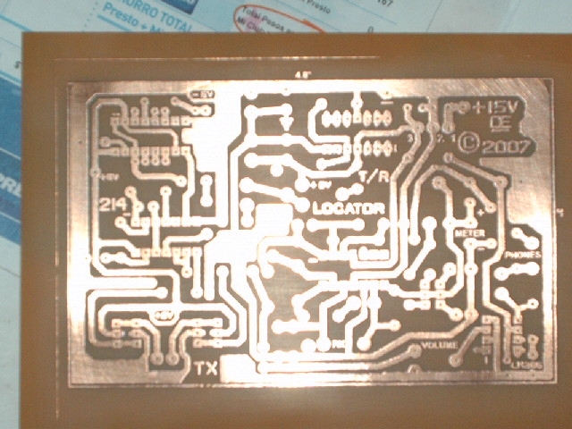

                • TR locator PCB
                  Hi Gary.
                  Here i m showing my PCB for TR locator.
                  Tomorrow i ll do holes on the board and after that i ll start to place components on it.
                  Nelson

                    Looks Good.
                    NELSON, By the way, You are the ONLY PERSON to try for a FREE BOARD, So Far.
                    So Probably you will get another one.

                          • TR locator
                            Hi Gary.
                            Ok is nice to heard that about my PCB. This was transfer to a laser printer and after that i use a combination of two chemicals to remove copper. The result was a nice PCB.
                            About the free board, i whant to thank for that. Indeed if i have success with this detector i ll make another one to go threasure hunting with my son.
                            The only think i canĀ“t get by now is the meter (hard to find here). But Geo tool me that this detector will work without it.
                            Nelson

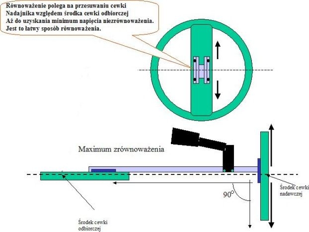

                            • TR locator coils
                              Hi Shahab, here are details of TR locator coils.
                              I m also building this MD, so when you get yours, let us know test results.
                              Nelson

                                Hi, I suggest you go to my Website to the Calculators.
                                http://www3.telus.net/chemelec/Calcu...alculators.htm
                                Just use the "Revised Inductance Calculator" to determine the winding for a 15 mH Coil of the diameter you want.
                                Any wire gauge between 24 and 28 AWG should be fine.
                                Possibly 8 to 16 Inch Diameter.
                                The Coil really isn't that critical because you need to tune it with the Capacitors. That is the More Difficult part.
                                My Coils were really Small, But I'm not actually interested in making a Fully Working detector.
                                Just trying to help you guys out.
