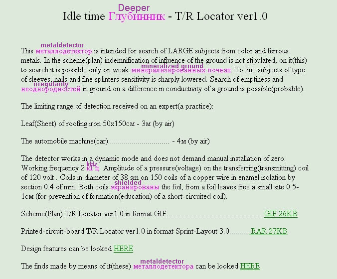

  • hi Geo! does everyone know ALSO that brands do NOT use the foil and use GRAFITE ANYWHERE may be THIS WAS YOUR MISTAKE TO USE THE FOIL?
    YOURS
    • Hi KT315.
      I usually make mistakes. Maybe i can't tell us right because my English are not so good. Anyway i attach you a file that yesterday you attached here on this forum. It says about "shielded the foil". It don't say Shielded with Graphite ????
      Any way the shield is shield. There are a lot of ways to do it. We look at the results.
      But i said that at 2Box detectors there is not need for coil shielding. What to do the ground? It is not able to destroy the coils balance. Who is your opinion about it ?? I wait

        • What to do the ground? It is not able to destroy the coils balance. Who is your opinion about it ?? I wait
          strange people. IT IS DEEPER! do you see GEB in TM-808 schematic?! NO there is NOT! so why you are worry about ground does HERE?
                            You don't understand me or i can not to give you the right words to understand me. It is the same, so let it............
                            Bye
                                Bye
                                sorry, may be I bad interpreted your words. if you will not use shields the coil untuning will go more than if in case you use the shields. but big problem would be not because a finish tuning must be done in a field as I had wrote above. you write 'balance' but I think this is not right here, because here is not IB principle similar to ordinary metaldetector with DD or planar coils.
