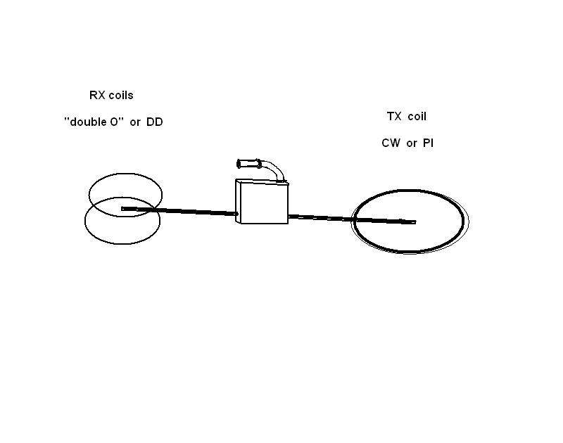

  • Who is your opinion about this idea?
    it will work???
    • Γεια σου Bill. Δεν ξερω τι ενοεις CW αλλα σαν παλμικο θα δουλεψει με ενα πηνιο στο δεκτη. Εννοειται πως σαν παλμικο δεν χρειαζεται τα πηνια να ειναι καθετα μεταξυ τους.

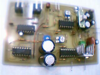

      • Hi
        Nelson,What did you do with TR circuit & coil?
        • Here is my TR circuit:
          • TR locator

            • Nelson,i hope that you finish your circuit.
              I built some PI detector but TR Locator is my first detector in TR mode &
              I don't have any experience with these detectors.

                Hi Nelson, YES, Those Caps Mount on the Coil, Not on the PCB.
                And There are No pads for them on the board.
                Your T/R Board and REG1117A will go out in the Mail Today.
                You Should get them in About a Week.
                Take care....Gary

                  • Originally posted by Bill512 View Post
                    it will work???
                    no. because coils are in one plain. you will get overloading in RX look on TM-808; TF900 and Gemini-3. their coils are orthogonal each other.
                    • To Geo and kt315, thank you for your replies.
                      to Geo: CW is continuous wave ( γεια σου Γιώργο , εδώ Pytheas )
                      to kt315 : I know about the “standart” two box design. I had the TF900 but it seems these detectors (TF900, TM808,Gemini, Garrett…) are not good enough for treasure hunting in real conditions. The TF900 it will easily pick up a (25cm x 25cm ) iron sheet in 60cm inside the ground (tested) , but olso it will easily pick up “ ground signals”. The 90 degrees Tx-Rx placement it seems perfect only on air tests. Also do not believe that those reports from companies ,about depth capabilities, is truth.
                      Some other tests on ground (metal mode) :
                      A) iron sheet (30cm x 15cm) in 120cm depth : not detected
                      B) iron sheet (35cm x 37cm) in 155cm depth : not detected
                      C) two aluminium engine cylinder head’s, say (43cm x 30cm x 15cm) in 170 cm depth (top) : not detected

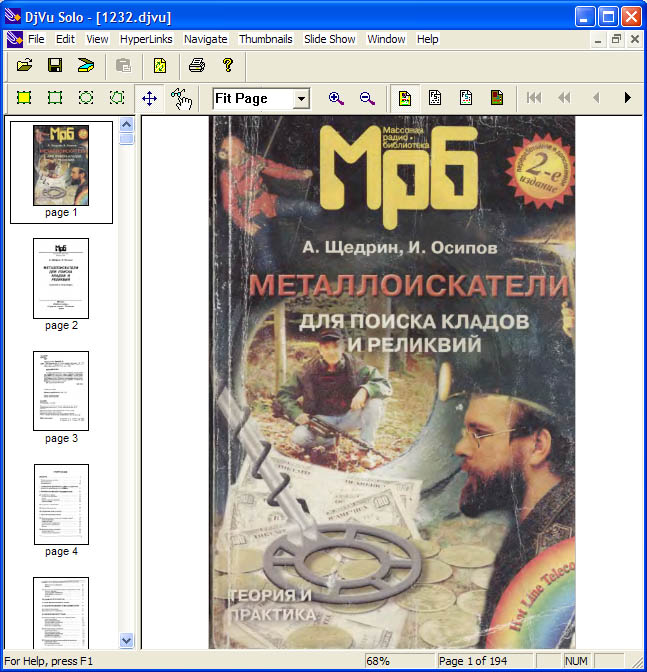

                      • hello Bill.
                        try load this book. it is in russian, but you will find the copy very informative in particular of two box design of Andrej Schedrin.
                        http://publ.lib.ru/ARCHIVES/M/''Massovaya_radiobiblioteka''/''MRB'',v.1232.(2000).[djv+ocr].zip

                            How can I read a ".djvu" file?
                            What program is needed?
                            • amazing that you do not know about this format. all www archives use only the format. magazines, books, schematics etc. - all I see in it.
                              visit http://www.lizardtech.com/
                              really for DJVU there are very much kinda converters, viewers, plugins etc.
                              I think you can try to ask your neighbour anyway. because I can give you only links on russian resourses. I even do not aware what is a best soft for it... a standart is SOLO.

                                Hi kt315,
                                Yes - it is amazing, but I have never heard of this format.
                                I have downloaded the Internet Explorer plugin and now it works ok. With the assistance of Babel Fish, I can even understand the text - more or less.
