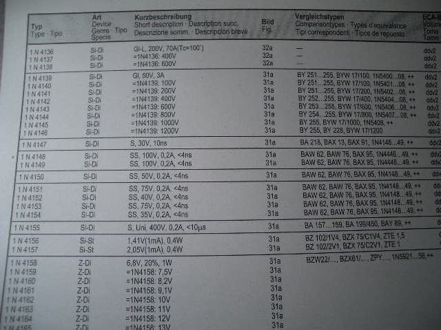

              Yes, i decided to build the TR locator, but i need to now a few things:
              1.- Replacements or correct value for D1 and D2 (both are marked D311)?
              2.- Value for the meter
              3.- Correct values for C13, C14, C1, C7, C15, C16 and C3. This are marked number plus mkF, what is mkF?
              4.- Need details for both coils
              5.- On the modified shematic, there are two diodes marked 1N4150. I don´t have this, so wich diode replacement can do the job?
              6.- There are two schematics, the original and a modified version that contains the 1N4150 diodes, wich one are best?
              7.- I have the PCB, but i´ll like to know if this is the correct one.
              I hope you or anyone can help.
              Best regards.
              Nelson Santiago-CHILE
              Hmmmm...
              1 - 1n4148 is good
              2 - 200mA -x 0 +x
              3 - MkF is in russian uF
              4 - 150 w/0.4 on 38cm
              5 - look at point 1
              6 - again point 1
              7 - Chemelec of cor'Z . Greetz Gary!
              Thats all help from my side at this moment
              • 5.- On the modified shematic, there are two diodes marked 1N4150. I don´t have this, so wich diode replacement can do the job?
                HEY THERE PEOPLE ON THE MARS! what problems you have of! Lk attach
                • Good solution KT315 - bull in eye!
                  1n4148 - 100V
                  1n4150 - 50V
