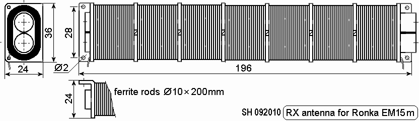

    Did you mean coil like this?
    No, like this:
      No, like this:
      Thanks. I suppose that only reason to divide windings layer in 7 sections is to reach better structural strength?

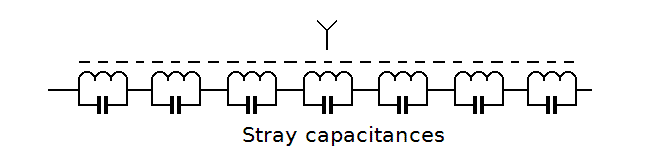

        Not. The winding in sections reduces stray capacitance at multilayer winding. In this case are formed 7 tank circuits, but having very high resonance frequencies.
          How many layer you provide? More than 5?
          "7 tank circuits"? By stray capacitance or by added real capacitance?
          Can you represent this graphically by electrical symbols? It is not clear to me what you mean.
            By stray capacitance only.
            This can be represented not only graphically, but by a formula. The 7 sections of ferrite antenna form 7 coils with its own stray capacitance. Note that capacitances are connected in series, ie the total capacitance is 7 times smaller.
            The inductance depends on square of turns number. If we reduce turns number 7 times, inductance diminishes 7 x 7 = 49 or near 50 times. So the tanks formed in the equivalent circuit has so high resonance frequencies, that they acts as a pure inductance.

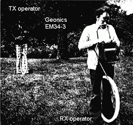

            • Geonics EM34-3
              Geonics EM34-3 is TWO BOX system for measurement of terrain conductivity.
              The intercoil spacing is measured electronically so that the receiver operator simply reads a meter to accurately set the coils to the correct spacing, which can be 10, 20 or 40 meters so as to directly vary the effective depth of exploration given by a table.
              To measure terrain conductivity, the transmitter operator stops at the measured station; the receiver operator moves the receiver coil backwards or forwards until his meter indicates correct intercoil spacing and he reads the terrain conductivity from a second meter. The procedure takes 10 to 20 seconds.
              The coils are normally carried with their planes vertical as shown in the picture (horizontal dipole mode) cince in this configuration, the measurement is relatively insensitive to misalignment of the coils.

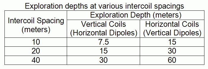

              • Exploration depths
                In the event that the greater depth of penetration is desired, the two coils are horizontal (vertical dipole mode). At this configuration more care must be taken with intercoil alignment. Because of the relatively short intercoil spacing, correct alignment is usually not difficult to achieve. Table below shows exploration depths at various intercoil spacings.

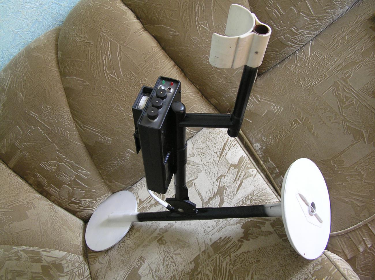

                • interesting construction of two-box...
                  • Hi kt315,
                    This is very nice two-box design ...
                    what about it's schematic and more information... ?

                      • Originally posted by GOLDENSKULL View Post
                        Hi kt315,
                        I read it was done on a base of schematic Two-box of Andrej Schedrin. the books in Russian.

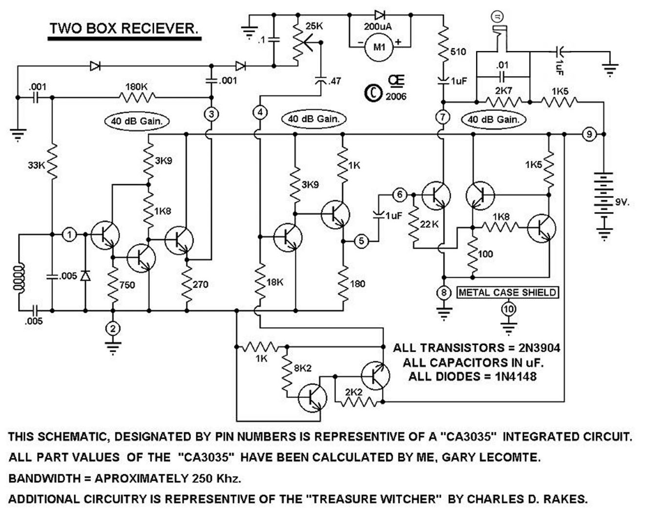

                              • Gary's ca3035
                                I really thank you Gary(chemelec) for ca3035 circuit I have been looking for it for long time.
                                you seem to be forgot the 1uf capacitor which connected to headphones and the earth
                                I tried to connect them in the circuit you made as shown in the attachment:
                                please check it

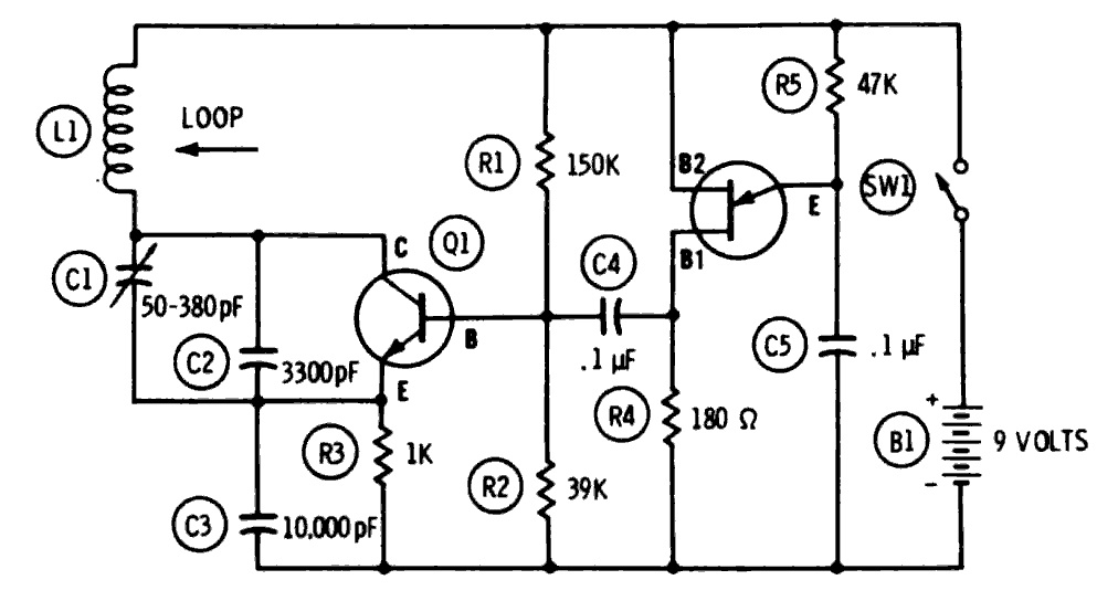

                                And can I really use it with the transmitter circuit made by Charles D. Rakes:
                                And I can not see this project on your website, please give me it's name
