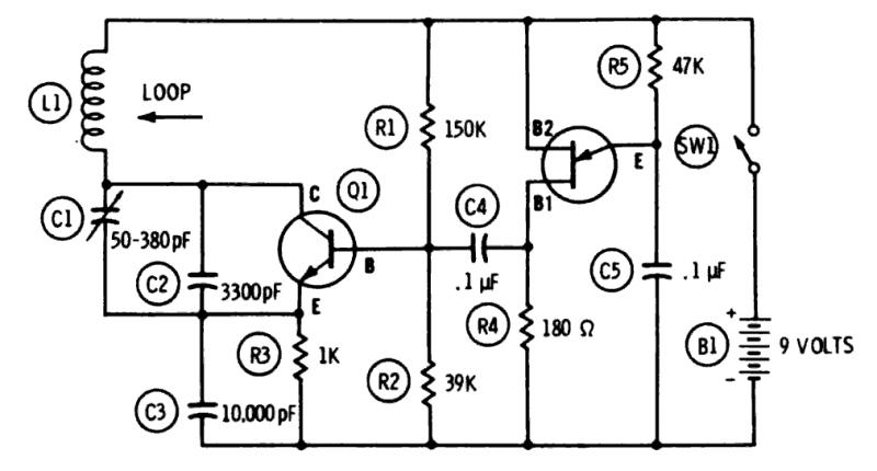

    • Originally posted by Hisoka View Post
      can I also replace the 2n2924 in the transmitter circuit with BC183 ?
      Did you mean that you never used that capacitor in your circuit ?
      Please check this circuit if everything correct after I removed that capacitor :
      I do not know if that BC183 is a good Substitute or not.
      Try it If you want.
      YES I Did use the Capacitor, I Just did Not put it directly on the PCB.

              • I saw your file mehdi but is the ca3035 equivalent circuit for receiving 180 khz or 2 khz
                because in your file it used with 2 khz transmitter circuit.
                Does the loop determine what frequency is received?
                And does the transmitter circuit made by Charles D. Rakes work fine, because I saw in some posts, it may has some problems.
                Did any one make this circuit by Charles D. Rakes

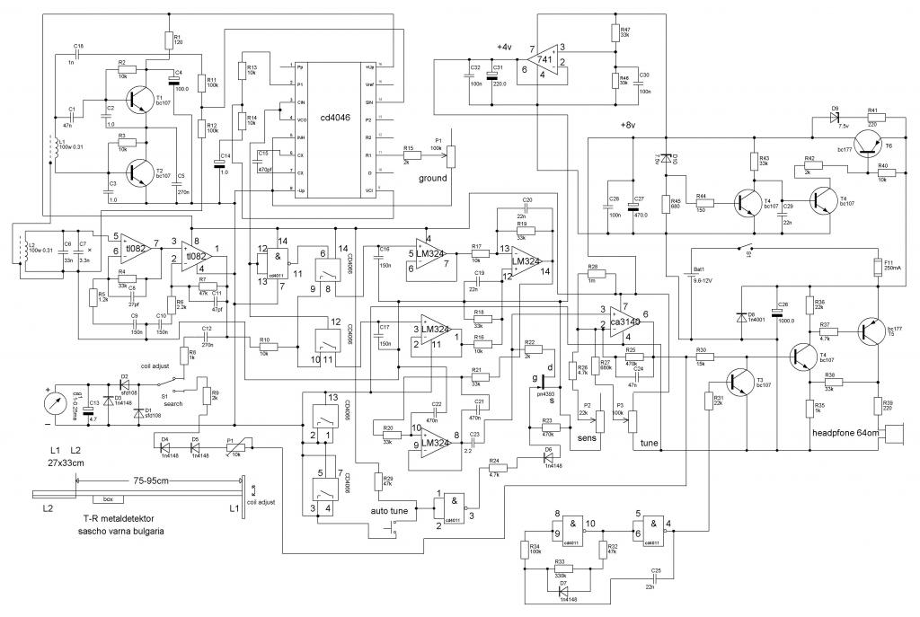

                • very interesting
                  Hi all!
                  The picture(!) in the #267 is very interesting.
                  It is good for idea (for example, it is an extended block scheme), or testing people talents in the school, but include serious errors.
                  For example, from this picture missing
                  - bandfilters,
                  - capacitors between op-amps,
                  - RF-end circuit is wrong,
                  - coils data, etc.
                  For the correct active filter design, see Texas homepage (FilterPro is free.).
                  Good hunting
                  Rumcajs

                          • Originally posted by mehdi View Post
                            Hi
                            can you put here the link, please?
                            Dear mehdi
                            the missing link is (the circuit is wrong)
                            http://www.geotech1.com/forums/attac...1&d=1135838569
