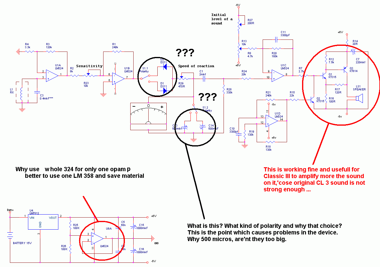

                      2kHz 2 box servizinfo
                      I just made that and it is acting funny?
                      It is acting like detecting somthing but...
                      here is the pic with my notes...If any body can explain...
                      Two Box from Charles D.Rakes works much,much better...even very usefull..
                      regards!
                      • #71
                        regards!
                        A few answers:
                        S1.1 and S1.2 is a single DPDT Switch.
                        500 uF is good.
                        In the supply, Personally I would use a 741.
                        • #72
                          Hi Ivconic.
                          you may build it without switch only one diode one resistor and one capacitor. I believe that 47uF is enough to demodulate the signal. Now for LM324 you can use any other op-amplifier.
                          If you finished it give us some test results

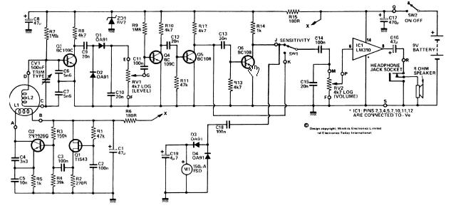

                              Coils are D-38 cm, 150 turns, D wire-0,4 mm. Voltage amplitude on TX coil is 120 V*
                              * take attention on it! are you agree that it is *superior*?!!
                              if you are not agree... then I AM SORRY :mad:
                              • #75
                                KT315 was faster
                                KT315 You are faster in reply.
                                I haven't build a proper coils.In a few days I'll test it
                                and than report.I have noticed something else. There are two
                                pictures, one is IB/T/R or VLF and the other is a TX part of
                                Two Box we are speaking here about. Any simillarities !!??
                                Can we just use the first schematic and add two separate
                                coils and make Two Box? Can we use any other good IB and
                                use it as Two Box? Why not?

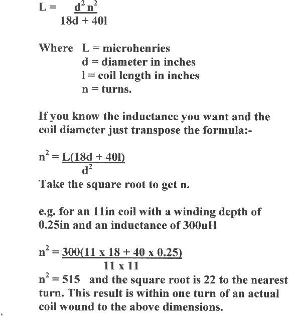

                                Somebody here asked (Roberto I think)for coil
                                calculations....I can offer presented formula.Is it good,
                                well dig that Yourself.Once I opened an original White's
                                coil.Cracked it and count windings.RX was 396 windings and
                                TX was 31, Feedback was 11 aprox. When I put known datas in
                                this formula, it gives me for RX 421 wind., for TX 30 aprox.
                                and for F.B. 10 aprox. So it seems that formula is good enough!
                                If it help U, than cool! About previous of my questions:
                                Can I use OA90 or simillar diodes.Germanium diodes do the
                                better job here.Demodulated signal is weak and decay after
                                a second or two...Thats why I asked.Other...I choose LM358,
                                'cose I saw it in Classic 3 do the job.Instead od 7812 I used
                                7810 cose of batteries of 12v.
