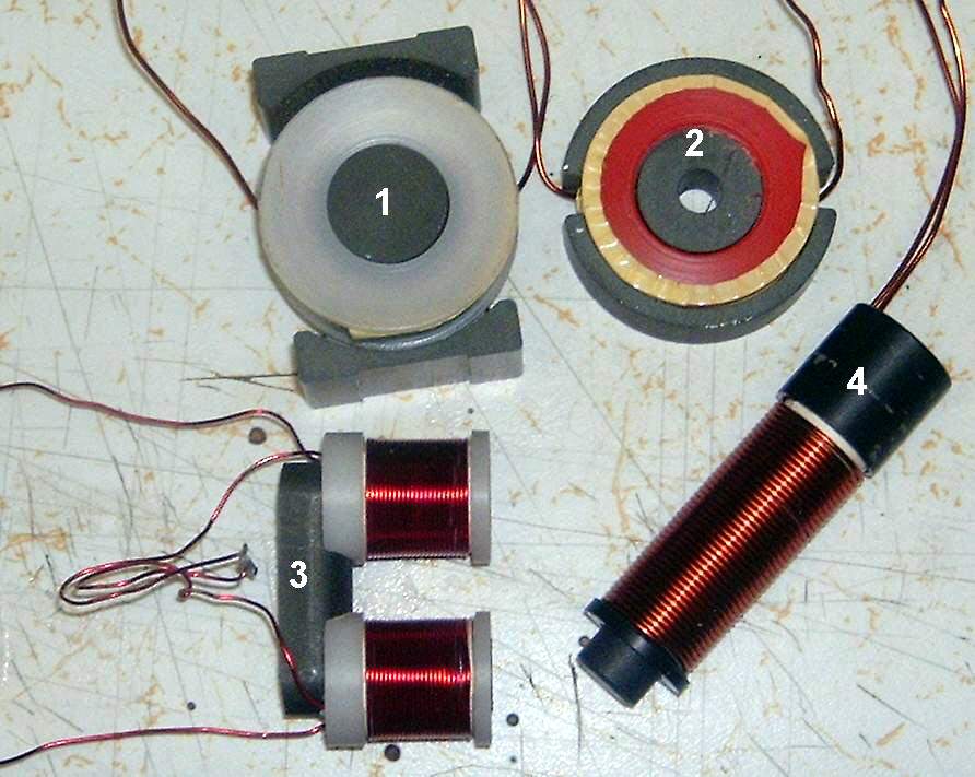

    • Hi Chemelec
      is that possible for you to make an experiment with your ferrite coils for us?
      do you remember your ferrite coils that you give link in coils page.
      with this two box circuits could you use number 3 and number 4.
      as transmitter;
      number 4 ,but on iron core (something like iron sweeper sticks,inside must be empty to have good wave consantration.)something like 2cm diameter and 3cm lenght will be fine.to increase inductance additional second circular coil in diameter of 5cm will be added in series.
      as reciever;
      number 3 , two u cores as I draw(sorry I could not copy it here .but you can see it inpage 2 of two box thread.the fourth one.)this is very stable winding for directional recieving.four legs must have same number of turns.it is in a way four windings in series.
      as result transmitter coils will be between two u core.

      • Yes on these cores, I understand that much.
        But on What detector?
        I have no idea what you mean by this.
        And there are Many types of Iron cores with many different Magnetic properties.
        How ?I do not know but this system enables to discriminate silver ,gold,copper,lead .,iron.
        OK, But What type of Detector was that?
        Gary

                        • Hi Chemelec
                          what is the AL value of your u-core as you mentioned third bobbin in picture.
                          and could you show how to calculate number of turns step by step here.
                          • Originally posted by okantex
                            Hi Chemelec
                            That U Core is a "Fair-Rite" Part Number 9277012002 and it has an Al Value of 1625.
                            It Material 77 which is a Low Loss, Power Ferrite material.
                            Now as to the rest of your question: Sorry, I didn't use any calculation to Pre-determine the inductance of this coil. I didn't even bother to count how many turns. Alhough I knew from Previous experience with this U-Core, Aproximately how many turns were required to get within a ball park of what I wanted.
                            The Nylon Bobbins were also Custom made by me on my metal laithe, so they would fit an appropriate amount of turns when filled up.
                            My only purpose of these tests was to determine radiation patterns from the magnetic fields of Various Syles.
                            So the actual, inductance was arbitrary. Although I did measure them on my equipment at the time.
                            Since I Completed those tests, I have Disposed of those coils. So I can't go back to actually count the turns and do those calculations for you.
                            Possibly I could do another coil with calculations and Tested Results for you.
                            Would that Help?
                            Gary
