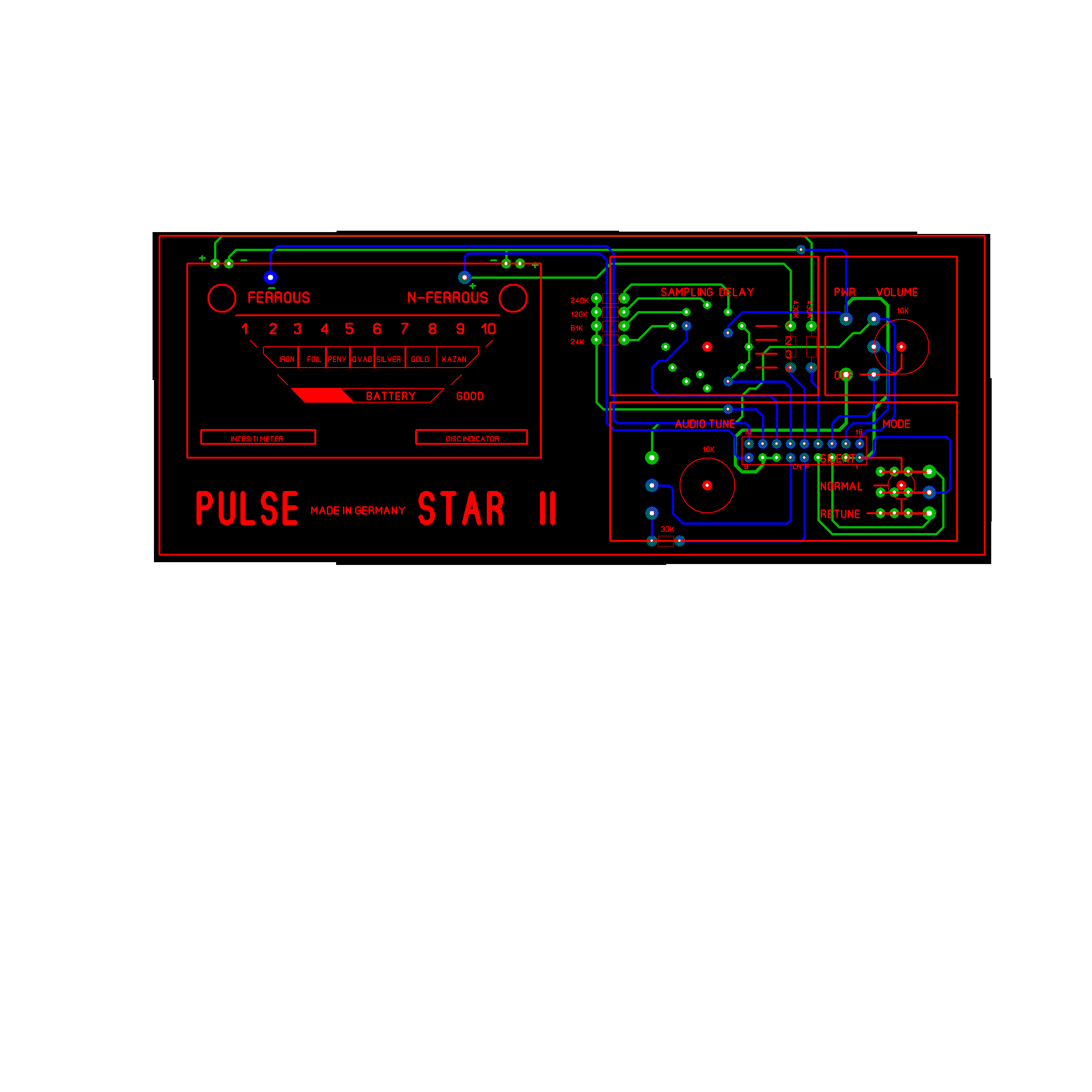

          what about DEEPERS 8AT ?is not it a PI .Seller insists that it has discrimination and rejection of irons.http://www.metaldetection.net/english/
            and for xr71 ,delta pulse and pulse star ;they are almost the same
            why discrimination levels are written on screen like in attecment

              Hi
              yes,I got the same question,how come pulse star II has got discrimination on front panel?

                Hi again
                I check the pulse star II , there was not any thing written on front pannel as
                gold or iron orpeny etc.u better check it too.
                yours fash
                  http://www.tb-electronic.de/prodinfo...nual/chap1.htm
                  look at this page and read please.
                    Hi. I have worked with Lorenz two times. There is not Discrimination, only a rejection to small iron objects. The Pullse Star II manual writes that if you use the large coil 2x2 m then you reduce the ability for Discrimination. Why? What changes at electronics systems for discrimination. Very simple they can not discriminate. They play with Sample Delay. I believe that Eric Foster is the only man who can answer to us exactly. Nobody else.
