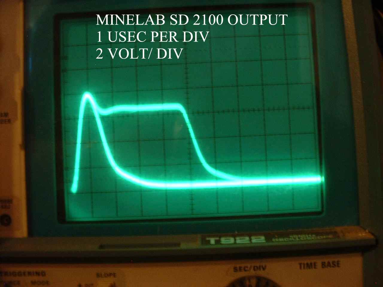

      Hi Paul,
      I screwed up and posted a pic I took quite some time back displaying the pulse signals of the SD 2100. The pic is in the thread where you asked about pics of nuggets.
      Most people do not take pics of the pulse current because it can change simply by changing the pulse width, the FET, any series resistance, etc. What is usually displayed is the decay signal since that is where the sample is taken.

        Reg,
        Thanks for the scope pic! Wow, does ML stand for what I really think. Cool. :-)
        I see two different pulse lengths. Is there a lot of high frequency ac or is the scope simply out of focus? In other words, the scope line is very thick. If it's noise then perhaps a very small cap would help a little. I was trying to see if there were any hidden changes in between the low and sudden high spike. You wouldn't happen to have a faster scan pic would you? I sure would like to see a blow up of just one pulse cycle. It's hard to tell but it seems they are simply charging up the coil and then releasing it as quickly as possible, which of course causes the magnetic field to collapse, hence a huge voltage spike. Is that what you see at faster scan rate or is something else happening in between?

          Hi Paul,
          The "blurry" current signal is more of a problem of the brightness level saturating the camera. I took those pics a long time ago when a SD was available. Unfortunately, that detector is no longer around.
          Minelab simply pulses the coil using a long pulse and shorter pulse. The do change the pulse duration and the pulse voltage. I am not sure why since changing the pulse duration into a low resistance coil will accomplish the same goal.
          One thing unique about the ML is the decay curve is dramatically different between the long and short pulse. That isn't obvious on the pic previously provided. When looking at the decay curve, the longer pulse has a very long decay curve and the short pulse has a fast decay curve.
          Unfortunately, when trying to display the different curves on a scope, the two are superimposed on each other. I have attached a pic showing this. One just has to remember that there are two different decay curves, one for the short current pulse and one for the longer pulse.

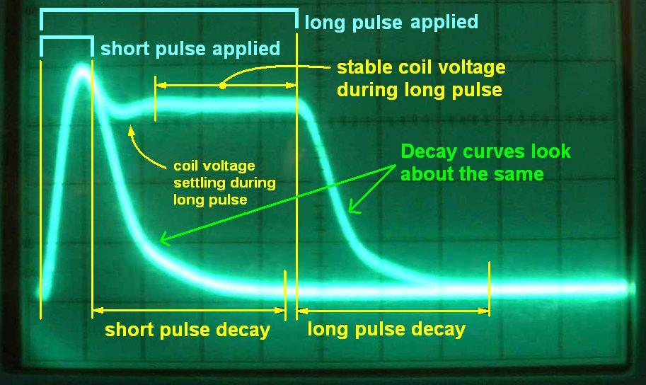

            Interesting. The bottom line represents ground and you're triggering on the start of the voltage spike. So then what's happening is the coil is charged and then the exact next step is reverse in voltage / voltage-spike. Is this true? I just wanted to be certain that the voltage does not momentarily *pause* at zero just prior to the spike. It's hard to tell, but it seems to voltage simply switches polarity without any pause at zero voltage.
            You don't happen to know if the GP 3000/3500 signals look the same do you?

              Hi Paul,
              Sorry, but I can't say just what differences there area between the signals on the SD and the GP's. My best guess is the signals are fundamentally the same, but the applied voltages are a little different. I think that ML is creating the applied voltages to assure the voltages remain constant. Fluctuations result in instability which then shows up as noise or "warbles".
              Now, as for the signal going from the current on pulse to the high spike, no, the signal doesn't stop in between.
              What causes the high spike is the fact the current has been turned off in the coil. Since current can't stop in a coil instantaneously, the spike is generated in an attempt to maintain current flow. The spike then decays at a rate mainly dependent upon the damping resistance. Any oscillation that may occur is the result primarily because of the inducance of the coil and all associated capacitances and resistances. This will include the resistance of the coil, the damping and input resistances, the coil capacitances, FET capacitances and all other associated capacitances. I am sure I have forgotten a few minor things, but the basics are there.
              Reg
                Hi Reg,
                This is a nice scope picture you posted. I am having a hard time understanding what I see on the picture. Maybe you can help.
                I assume this is a picture of the voltage applied to the coil before waiting to see the target's return signal. From what I can see, it looks like 2 applied voltage signals superinplsed over each other, with the short pulse stopping before the coil has reached a stable voltage level.
                It appears this short pulse decays exponentially immediately after reaching a peak voltage. The second trace appears to be the long pulse which reaches a peak, then oscillates slightly before stablizing around 6.5 volts. The long pulse finally decays exponentially in a curve that looks similar to the short pulse. The only difference I see is the long pulse has a 3 usec stable pulse width at 6.5 volts before decaying.
                Am I reading it right?
                  Hmm, now I'm confused because I thought that was the collapsing magnetic field; i.e, just after the coil pulse.
                  Paul
                    Hi J,
                    On the SD 2100, I took all pics just using an external coil and a loading resistor. Now, when you look at the pic I posted on the other thread, you will see the pulse train of this detector. That pulse train indicated two different pulses are happening, a short pulse and a much longer pulse.
                    Now,when trying to look at just what happens when the pulse spike occurs, one can't readily separate the two on the scope and what is displayed is the short pulse decay time and the long pulse decay time with one superimposed on the other.
                    As for the decay time, I usually refer the time from when the FET is turned off, which is basically represented when the voltage suddenly rises. On your pic, this is about the time of the first vertical yellow line. So, the actual decay time would be from the first yellow vertical line to when the particular decay curve levels off. This would be the time needed before a sample could be taken.
                    The actual pulse applied signal is not present on this particular pic. If you go back and look at the pic I attached under the thread of electrical resistance of gold nuggets, you can see the actual coil signals of the SD as seen using a coil and a loading resistor spaced a finite distance from the ML coil. On this pic you will see the current pulse or current on time as the small vertical down step before each high spike. I have labeled the LP coil current time, where LP stands for long pulse.
                    Time wise, the LP coil current is on about 250 usec or so. The short pulse time is about 50 usec
                    Hope this helps.
                    Reg
                      Hi Paul,
                      You are correct, the two signals superimposed are in fact the signals that are generated by the collapsing field. One of the reasons ML has such different decay times between the long pulse and the short one is the fact that ML tries to recover some of the energy used in the long pulse. So, it tries to divert some current into a capacitor where it can be used again. This results in a much longer decay time.
