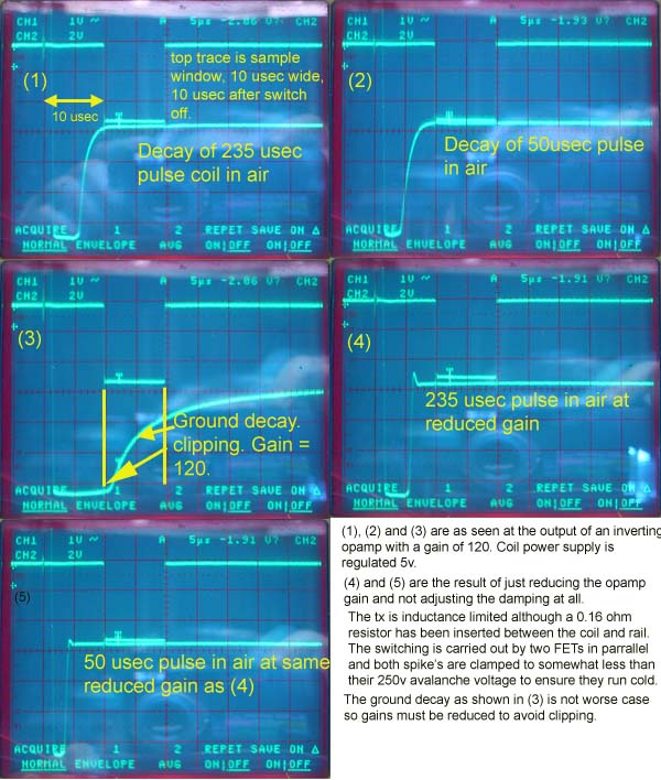

I found a piccy that I put together some time ago and re-edited the layers slightly for this thread.
It is basically self explanitory I hope. This design uses inductance limiting tx similar to Ml's so there is a huge amount of energy in the long pulse's spike compared to that of the short pulse as the current at the end of the pulse climbs to vt/l. The tx methods that use resistance limiting may show much less difference in spike width when using different pulse lengths because the rise to maximum occurs in the same time.

Now, referring to Robby's pics, they display a couple of things that one should realize. The items are not that obvious, but are there. The difference between pic 1 and 2 is minimal, but does display a slight difference in rise time of the signal out of the preamp. This shows that the shorter pulse could be sampled a little bit sooner than the long pulse. The time difference is probably only a usec or two, though.
Now pics 4 and 5 clearly show the advantage of reducing the gain of the preamp. The signal clearly rises faster which would allow for a shorter time before sampling if necessary. This normally occurs because the gain characteristics of the opamps involved are severely limited, speed wise. So, when comparing the sets of pics, one can see the distinct advantage of reducing the gain out of the preamp as a primary means of allowing for a faster sampling time. It also shows that simply changing the gain will also change the damping of the coil as seen at the preamp output. If you look carefully at the signals, you will see a small overshoot before the signal levels off. This indicates the coil is very slightly underdamped. When looking at the two pics, 4 and 5, one can see that the longer pulse now causes a greater overshoot (at the point where it levels off).
What isn't displayed is the fact that as the gain is reduced, the bandpass is usually widened. Yes, it does show that the IC comes out of saturation faster, but the gain may be different during the first few usec's on a very high gain circuit. This can cause some strange results. Eric Foster posted some results along this line quite some time ago.
Now, where am I going with all of this? Well, what I am trying to point out is the answers you may be looking for are not as simple as just saying this rock is at fault, or that is at fault, or this should happen or that should happen. There are so many interactions that it is scary. This makes it very difficult to determine just what is happening or what is the best ultimate solution.

I like your pics. They tell me a lot and also want me to ask a couple of questions. What opamp was used in the pics and the second question was how much was the gain reduced on the pics 4 and 5? The 50 usec pulse pic shows a signficant reduction in recovery time.
