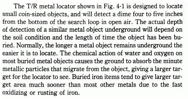

                            • From Charles D. Rake's book (pages 56-57):
                              • Halo Effect
                                Halo effect
                                In the ocean, a silver or copper object can create a halo of hundreds of feet over a certain amount of time. How does this work?
                                Sea water is a very aggressive environment. It oxidizes most metals and leaches ions out of coins. Not only the surface, it actually manages to penetrate deep into metal surfaces. To remove the salt from within silver coins that have been submersed a few hundred years, demands a lengthy electrolytic process. If not done that way, the coin will tarnish again within a very short time.
