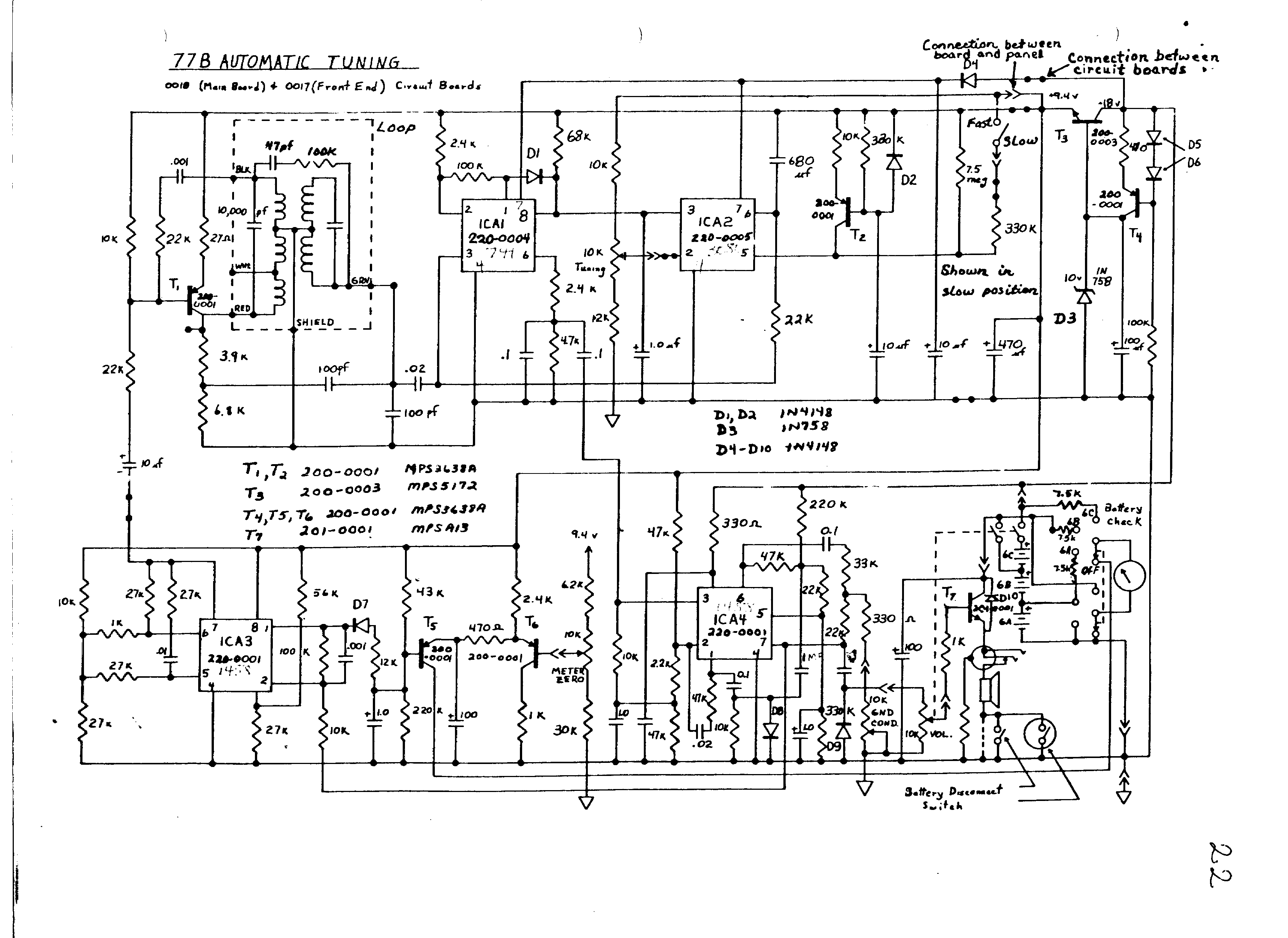

    Hi All,
    I was just wondering if anyone has the schematic for the old Compass 77b. I have one that doesn't work and would like to get it going myself if possible. Unfortunately, I dont' have time to try to reverse engineer it.
    Since someone just happened to have the Judge 1 schematic, I guess I can hope someone has the 77b schematic.
    If no one has the schematic, anyone have an idea of how close the Judge schematic is?
    Thanks,
    Reg

      You may want to check with Keith at www.broken detector.com and see if he has a schem on it, he also works on Compasses.
      Steve(in MS)
        The 77B,77 auto and Compass auto legend are 100KHZ units. They are the best of the Compass TR units. They don't go as deep as newer VLF's designs and have no disc except they do not react to small nails, they are the best units to use in highly iron nail areas and have great see through ability. I don't know where to find any schematics on them other than the maybe the website above.

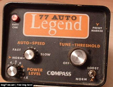

                I have an older 77B automatic
                Hello Reg,
                I don't have the schematics to the 77B automatic but do have a good working one. If you can't find the schematics and would like to compare mine against yours I can sent you my 77, You can send it back once you figure out the problem with yours.
                HH, Paul (Ca)
                  Please, Compass 77 Automatic Tuning.
                  Mrand
                    Mrand, thanks.
                    The anotations on the IC aren't very clear, but I can read these:
                    - ICA1 = 741
                    - ICA2 = 308
                    - ICA3 = 1458
                    - ICA4 = 1458

                        ICA2 is 3080 not 308.
                        Mrand
                          Thanks, you're right!
                            Just wanted to say that the old Compass 77b is up and running now. Turned out to be a bad opamp.
                            Thanks again for all the info.
                            Reg
