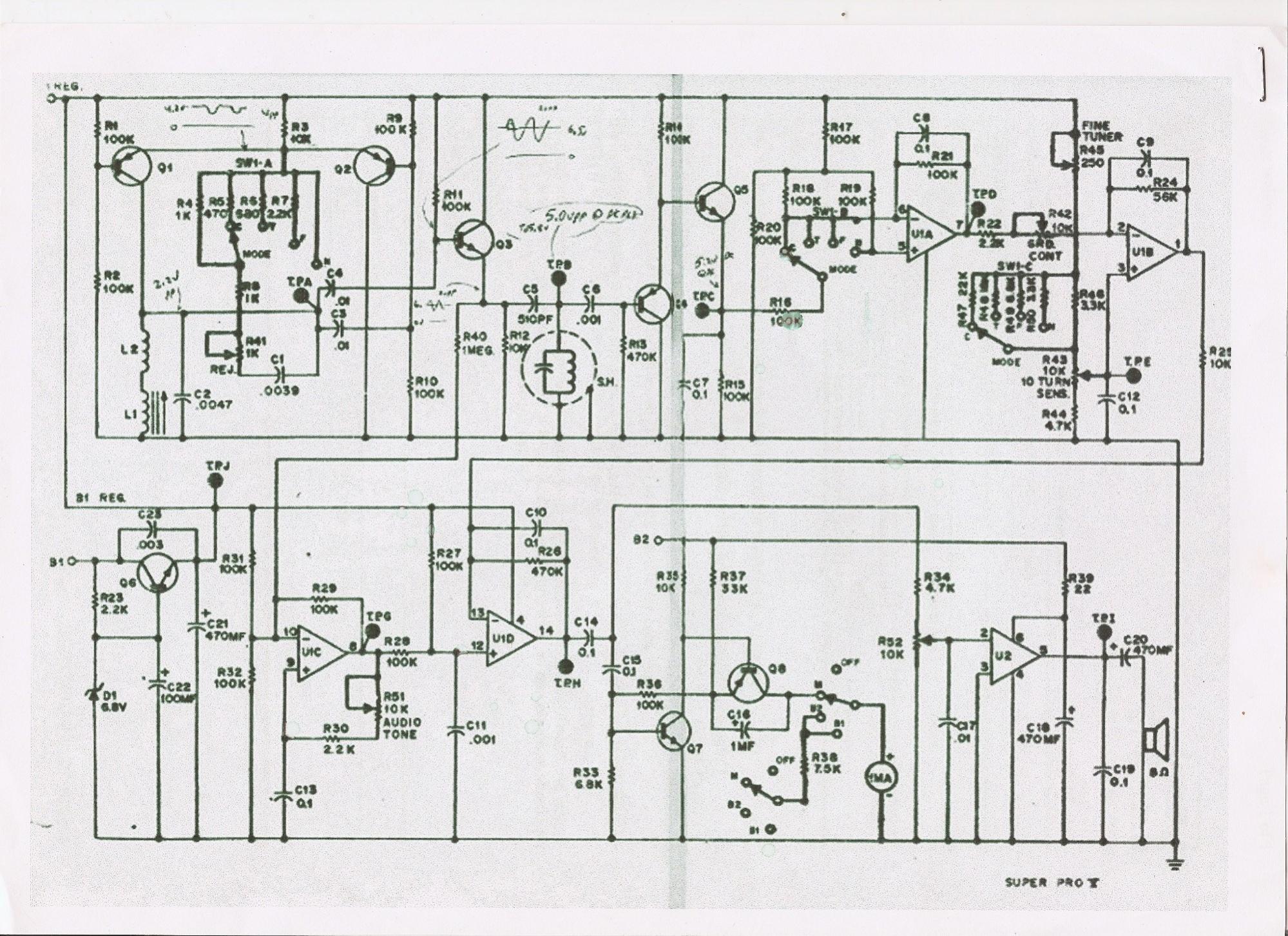

      Super Pro V Schematic
      Success! Allen has sent me the schematic.
      Now I need to find some time to repair this detector.
      Hello do you still have the schematic for the Super Pro V
      I have recently been given one to look at.But the coil is in pieces
      and no way of knowing what to replace with.Powers up and sensitivity is adjustable and meter works,but with out a coil is not much good.
      The coil seems to have a 10n capacitor but coil winding is only a guess
      since the previous hands butchered the tiny wiring.Any suggestions on how to make up something or replacement from another maker like old whites,Garrett,Bounty Hunter to use their coils
      Cheers to all

        Sorry for the delay ... I had to search for the paper copy.
