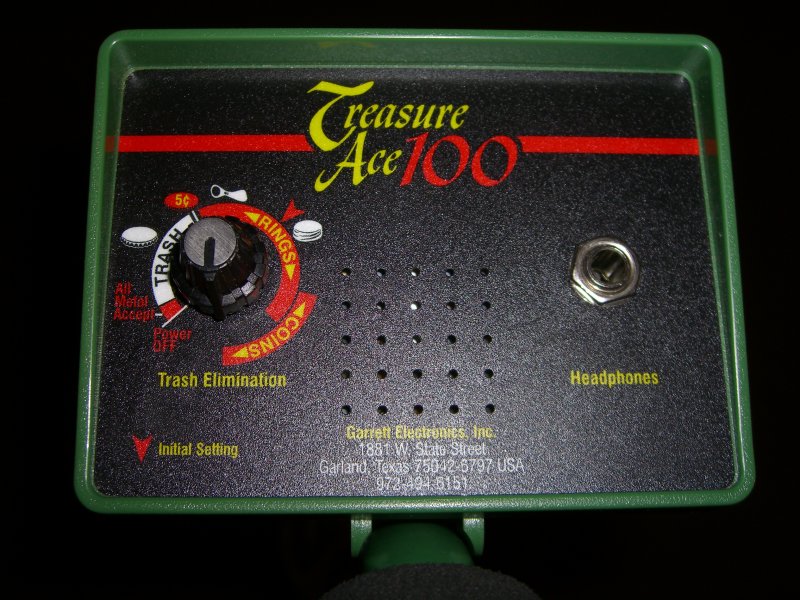

    Recently I made some tests on the Garrett Treasure Ace 100:
    This is not a deep seeker, but the discrimination is very good. I also found that it was good in trashy or iron infested areas. It has an 8" Crossfire coil that can locate small nonferrous targets easily.
    Here's some results of an air test:
    All tests were made with the discriminator control set to reject a large iron nail. This corresponded to the 5 cent setting on the dial. Depth measurements were determined by a consistent signal, and were recorded to the nearest 0.5" (rounded down).

    In "All Metal Mode" there was an increase in depth of between 0.5" and 1" depending on the target type and size. In some cases (such as the U.S. dollars) there was no change.

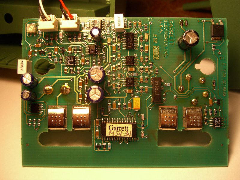

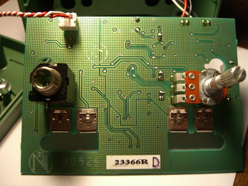

    See photos below:
    Note that there is a small potentiometer on the PCB (top left - second photo). The original setting is in the middle. This was tested in various positions, and it was found that only the sensitivity appears to be affected, but not the discrimination.
    In retrospect this small potentiometer appears to be the factory set ground balance control. Since this control is located on the PCB, and the control box needs to assembled for the batteries to be connected, I had to re-adjust the GB setting using crocodile clips (to connect the batteries) and an icecream tub full of soil.
    This is always the problem when you can't help messing with things.
      can you write type of chips , or give clear picture to see elements value?
        High resolution files uploaded here ->
        http://www.mytempdir.com/1137436
        http://www.mytempdir.com/1137440

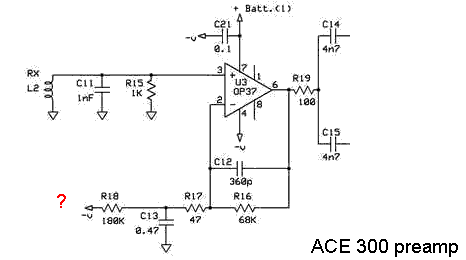

            Ivica, I have several questions about your circuit of ACE 300.
            Are you sure that U3 is powered by battery voltage? How is generated supply rail 5V? There is something wrong about operating point of U3. Please check again where is connected the left lead of R18.
                              I searched through my files and found out that actually i never finished tracing!
                              So i can not properly answer your question.
                              I just added additional files here:
                              http://www.geotech1.com/forums/showt...795#post135795
                              Maybe you will find the answer there.
