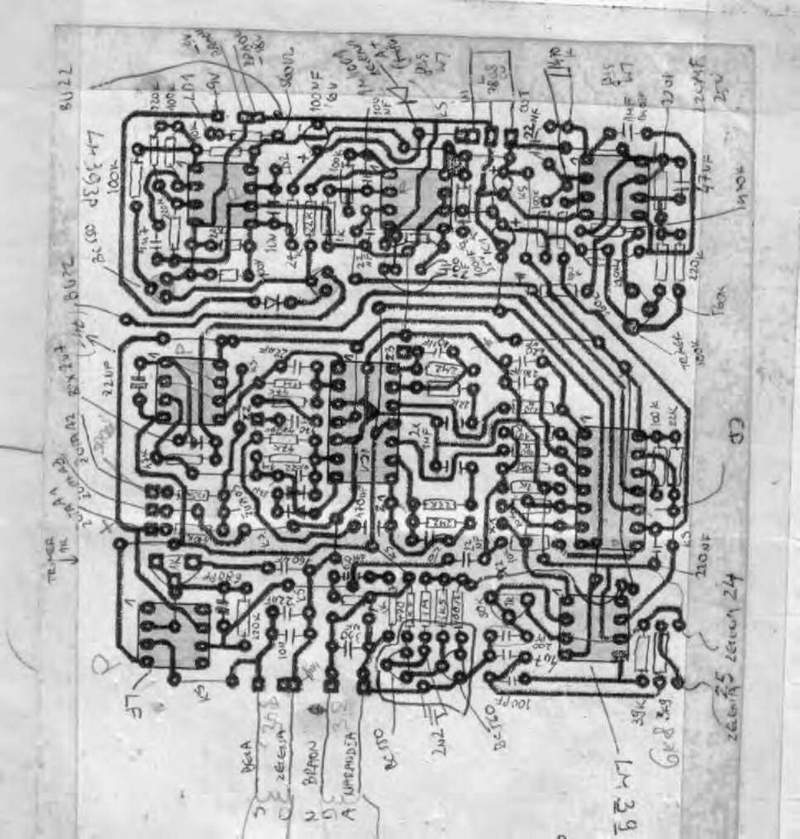

    Hi. I made the pcb for cl3 who Ivconic sent at forum. The pcb is a little difference :confused: than Jackdetect's pcb because maybe Ivconic made modifications at schematic. So I want Ivconic to send me the modifyed schematic.
    Ivconic something else. If you have the plan how to put the components on the board please send it to me.

      Huh! Geo you gave me hard task to do....Let me explain...
      First time i saw this,it was 4-5 years ago....No schematic,no project,
      just ready made device....I done reverse eng. on it with a lot of
      success. Since i was in a hurry, i didnt have much time to prepare
      proper documentation for it at the time.
      I started to make those.I used my hand writed (posted here) documentation.
      Kind a used ond this, by time i became inert to make better documentation.
      Therefore i ended with this...
      Now when i have to help you, it is a sort of trouble.I do understand very well
      how to use this....but how to explain,now, to you how to use this???
      First step for you is to put jumpers on pcb...lot of them!
      Carefully look on picture and compare with schematic....Slowly!
      A lot of jumpers due to pcb remain small...
      There are 3 jumpers "hidden" without already prepared holes for those!
      Look on IC4 and IC7....IC4 has 2 jumpers over it and IC7 one jumper!
      Also on IC8 on 6. pin there is resistor 22K connected only one side on
      pcb,other side you must solder in the air and connect somehow with + pole.
      As you can see, i marked those points as x1 and x2 on photo...
      Also there is one unintenional mistake on the pcb. On IC1 there is wrong
      connection on resistor 220K and cap.47Nf... You should cut a small piece
      between those and pin 8. and leave pin 8 just for +....Resistor and cap.
      you should connect with pin 7. on IC1...It will be easy since those are
      very close....not big deal....
      But if you trace this pcb while look in schematic...it will be so easy
      to find out all those...
      No other mistakes for sure...
      I havent made any other changes...Just respect schematic and posted
      pictures and it will work fine...
      Now, start soldering jumpers and the rest of components...Later we will

      One more thing;
      Once i did serie of pcb's for CL3...but i made mistake and did it
      REVERSED !!!! Can you imagine?
      I didnt want to get rid of those,i felt sorry...than i decided to
      use those anyway....
      I had to distort/twist back all the pins of IC's and than solder those
      on pcb "mirrored"....Ha,ha,ha....Somehow i managed not to destroy even
      one IC....All worked perfect!
      Somebody might be thinking that i did that intentionally...but not!
      It was accident....But it will be so confusing if someone try reverse
      eng. on those...ts,ts,ts!!!!
      That is the reason why i posted reversed pcb here...but i forgot to
      mention that....Sorry again...
      If you have to twist pins like i did,best way is to use knife and
      slowly "catch" all pins from one side of IC and very slowly,pushing
      oposite you twist those....Do not be affraid,you not gonna break
      pins if do carefully and slowly....
      Than solder those as should be in mirror and that's it!

                  Hi. Something is going wrong, last time everything that i make don't work .
                  I finished the classic III but don't work .I didn't find some components and replace them with other but i think that this isn't the reason:confused: . I replaced LF4111 with NE5534. LF444 with LM324 and MPSA13 with BC517. With a ready coil i have an oscilation at 6.24 Khz ( really what is the freq of CL3?) . the 5534 amplify about 250 and general all seems that the detector works but there isn't sound. When i move a object near the coil i see at scope a positive voltage (at base of bc517), the generator gives a pulse 1.9Khz at the audio driver but no sound. All the circuit is 2 transistors and some resistors. nothing else. I looked the circuit again and again but no results .
                  So i replace one's the transistors and then i will try the audio fo Zagori (4n35.555 etc).By the way i want to replace the 3 batteries 9v with one pack 6v or 9v. If i make the circuit that Ivconic sent at forum (gives 6V and takes 18v) i will connect it at the position of 2 batteries 9v. But remaining the sound (another battery 9V). So if i make a bridge at the out of 7808 to the input of 9V for audio is there any problem? I am waiting for tricks.

                    O.K. Geo! I was absent few days....I am here now and i'll try to dig why your detector
                    isnt working properly....
                    Let's go step by step...
                    "...I am afraid about some capacitors (670pF, 76nF.4n2) but i will put 2 or 3 parallel..."
                    No,you dont need to "torture" yourself with precise components values for now. Just put any
                    nearest value you have....for now.
                    "I have read often about classic III Turbo..."
                    I do not have a clue about that??? Never mind!
                    " I replaced LF4111 with NE5534..."
                    No! You can not put 5534 just like that...For testing purposes you put LM358...later you
                    will put some else.....
                    "..LF444 with LM324 ..."
                    Yes this is O.K. I am using LM324 also in my devices....Good choice!
                    "...MPSA13 with BC517..."
                    BC517 is very good...but pay attention on pin assingments...oposite than MPSA13.BC517 (CBE),
                    while MPSA13 (EBC)....
                    Also i noticed when switching in pinpointing mode,if holding for 10 seconds or more BC517
                    is getting very hot and burn easy!
                    Better choice is 2N2222...but sound is not loud enough.Other hand with 2N2222 you can work
                    in pinponting mode for hours without any risk of burning it...
                    "With a ready coil i have an oscilation at 6.24 Khz ..."
                    Very good! CL3 should work from 6.35 to 6.9 kHz...(you have trimmer to adjust it)
                    "...(at base of bc517), the generator gives a pulse 1.9Khz at the audio driver but no sound.
                    All the circuit is 2 transistors and some resistors. nothing else...."
                    O.K. this is obvious that device is working properly but audio stage not! Look&check again
                    all arround audio....Check again BC517....replace it with 2N2222....but pay attention on
                    pins...(ECB CBE ...etc..)
                    Also it is very easy to find MPSA13...if you can not find it in shop,than find some old
                    modem (ISA or PCI slot) and almost every model have one MPSA13 on it....Ha,ha,ha!!! Very easy!

                        All are going wrong
                        Hi Ivconic. I am here again. I put a 2n2222 but audio don't work . I replaced NE5534 with LF357 (New one). First stage don't work with LF357 but work with 5534 . What to say. Now i haven't pulse at the input of bc517 (why?:confused: ).Pin 3 of LM358 has a input pulse when i move an object near the coil but pin1 has not pulse. I relace lm358 but nothing. I relace lm358 but nothing. I relace lm358 but nothing. I relace lm358 but nothing. I will see at afternoon.
                          :confused: :confused: :confused:
                          Very strange..????
                          I guess there must be some mistake, you made while assembling it?!
                          Check again, did you cut that mistaken connection on pin 8. of ic1 (ic 1 from my placement photo-posted here)??
                          Resistor and cap. should be connected to pin 7. not to pin 8....Just cut 2-3 milimeters between pins 7. and 8. and resistor and cap. should remain connected on pin 7.
                          Also you should check all those jumpers from upper side of pcb. Also you have 3 jumpers on ic's i ve been talking about...
                          Check all over again...must be some mistake for sure!
                          It is all arround LF357...maybe some mistake at MPSA13 or arround it???
                          It is quite tough for me to dig now what should be the problem since my devices always works fine from start, so i guess must be that you made some mistake because you do not have proper documentation...
                          You can go step by step....ask anything...i'll try to help..

                              Perfect
                              Hi Ivconic. I finished the CL3 . It works. How it works ? Ohh PERFECT . Thanks Ivconic. All are working, Disc and Pinpoint, sens, audio at pinpoint(fron trimmer) . The coil that i have works very good. I will fine adjust it (with capacitors) because it is tuning for 6.95 Khs and i work it at 6.295 Khz but without tuning the Rx. I want to tell me how to fine adjust the detector with existing trimmers:confused: . Tommorow i'll try to make the new audio with 555and 4n35. I have a detector housing with robs and coil so i will put it inside this box. The box has an instrument so i will connect it at the audio input via a op.ampl. Do you have any Idea?
                              Ohh..about stability. EEEEEE......Perfect. I work it as you said with one 12V bat.
