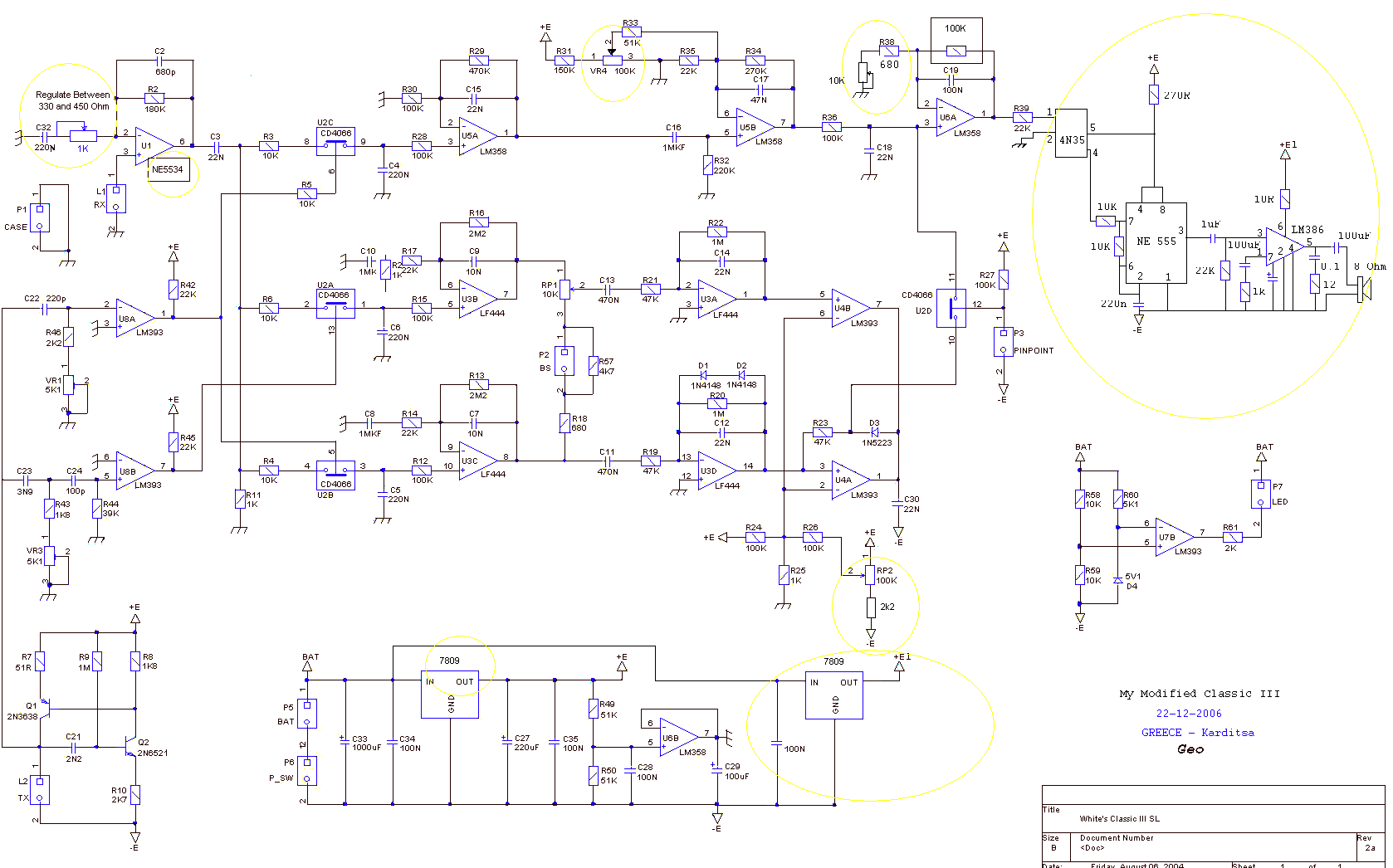

        Modified schematic
        Hi. I attach here the schematic of CL3 a little modified for better sensitivity, single Power sulpy 12V (13.2 is better) and different audio . I tried it for 2 tone audio (one for ferrous and one for no ferrous). It operated but it want one op.amp yet :confused: at one channel. I let it, maybe another time .

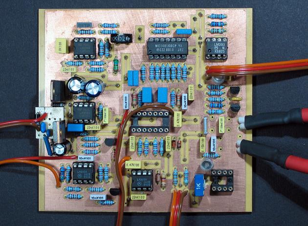

          Trying to build CLIII... pcb from Jackdetect protel file.
          So here are some questions...
          Can't find LF444, TLC274 and LF411 -> any known good replacements for them?
          Now I have to make the coil (my first IB coil) - this will be hard work as I do not have oscilloscope... but Ivconic's said that's possible.
          Can I detect ballance of coils with DMM (when I add or substract windings from feedback coil - Tx oscillating, Rx on DMM)?
          What are inductances of Rx and Tx coil?
          Also opened to any other suggestions..

            Hi Leto. Congratulation.. Very good work...nice pcb.
            You can use LM324 for LF444 and NE5534 for LF411. I made my CL3 with this IC's.
            If you have not scope it is a little difficult to regulate the CL3. First regulate the trimmer at LF411 so the resistance to be 330...400 Ohm. If the resistance is lower you have better sensitivity but you will not have discrimination. Now about the coil... if you have a good digital multimeter do as follow: Connect only the Tx coil and power on the detector. Set the multimeter at 2V AC and try to balance the coil. A good balanced coil must have an output about 5mV. An indication between 5...15 mv is OK. The detector oscillator works at about 6.5 Khz so the multimeter must have the ability to measure at this frequency.
            Good luck

              Thanks Geo.. I used your replacements (NE5534, LM324)..everything is on board now.
              *I connected device to two small (OD 13cm) testing coils in DD configuration (Tx 80turns,0.4mm, Rx100turns, 0.2mm) and nulled them to about 4mV dc
              *Tuned the Tx coil with total 110nF capitance to 6.5kHz
              *Tuned the Rx coil to highest response at 6.5kHz with total 210nF
              (searching whole web and this forum I could not find well explained procedure for tuning the coils with caps - but I guess the setup is the same as free air resonance test??)
              This is what I get:
              No sound in Disc mode ,
              output of NE5534 pin6 is at 0.093V, when I close up my iron hammer -> CLIII is just a bit scared and voltage rise to 0.330v - is this enough?
              Still no sound but LM393 (U7) pin1 has 400Hz pulse.
              In all-metal there is constant sound I can trim with 100K trimmer.
              If I close my hammer again very close to the coils (2cm) pitch of sound changes so there is detection but very poor one .
              Any suggestions??
              How critical is tuning of Rx coil to Tx frequency?
              Whats the purpose of Led on U7?

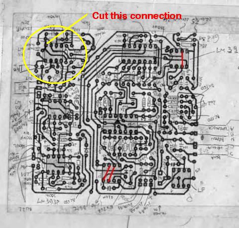

                              DEJA VU...
                              Yo!
                              Besides everything mentioned here; i noticed a mistake on your
                              (very nice) pcb. Jackdetect didnt marked this in his work, why?
                              I do not know!?
                              But, at present pcb you MUST unsolder that 22K resistor from
                              pin 6. of 4066(4016). Other side of resistor should remain
                              soldered on pcb as it is. Unsoldered side of 22K you should
                              solder to vcc....for example, nearest point is pin 8. of LM393.
                              I tried to present this on posted picture below...
                              Also if you check schematic you'll notice quite obvious mistake
                              there....

                              Also there is another - LAST mistake on pcb....Cut short line between pin 8. and
                              res.220K+47nF( should remain connected only with pin 7. - make that connection)
                              So finally we established 4 (four) unintentional mistakes on pcb.....I am not sure
                              that those mistakes are mentioned in Jackdetect's files...
                              Anyway those are all....no more mistakes and pcb is very usefull. I made over 10
                              devices so far, using this pcb...All works very good...
                              If this helps you than i'll be glad...if not.....i am sorry!
                              best regards!
