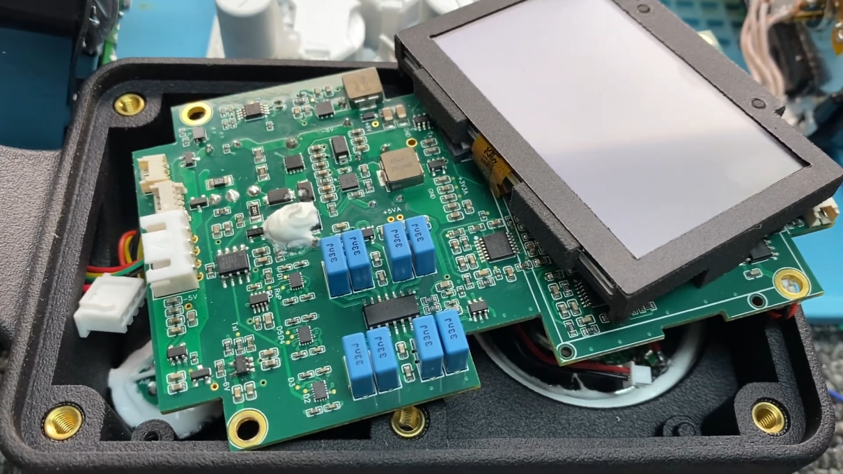

                Hi Guys, I just did a tear down of the new algoforce E1500, it’s up on my YouTube detectormods chanel.

                  Woody, when you had the thing apart did you see an external ADC? Even though the STM32H7 has pretty good 16b ADCs I would expect them to use an even better external ADC.
                    Hi Carl, I never investigated as a a super duper ADC along my lines of thinking is at least 14 bit, 80 Msps and decent heat sinking. Seems like I better take another look.
                      Haha like the AD6645? That was the last pure ADC I designed for Analog Devices: 14 bit, 80 Msps, and 1.5 watts. Geez, that was 25 yrs ago.
                        lolz Try ADS8354 , I was going to put a pic up of a string of resistors.
                          They are using analog demodulation, I don't think they would go for a fast ADC, 4 simultaneous ADCs at 24 bits would be a better option IMO, however with a slight amplification the internal 16-bit SAR will be sufficient.

                          you see the preamp then three 4053s in the QFN package followed by a quad opamp as differential integrators then perhaps some filtering and off to the ADC.
                          pretty straightforward, I like clean designs, unlike the GPX6000 which is just overkill IMO, in like how better the GPX6000 is compared to this AlgoForce or the Axiom? I don't think much, the Axiom is also very clean with differential preamp and just direct sampling ADC.
                            Thanks, when I saw all those thru-hole caps I also assumed analog demods. Even then, I would probably use a simultaneous sampling 24b ADC, like the ADS131E04 or E08.
                              One thing about this unit catches my eye, and that's the "obscene" of any apparent shielding.
                              something tells me the whole plastic work is impregnated with graphite, otherwise, the capacitive coupling of the fingers on the UI would cause trouble, it's right on the preamp, The LCD cover looks suspiciously different, so much graphite made it rough.
                              Woody, can you meter the plastics? if you have 30sec on hand.
                              thank you.
                                This 2.2 microfarad capacitor implies a full ( or half ) bridge driver and this capacitor is connected in series with the transmission coil. detectormods , can you please us with a video about the current through the transmission coil ? Half-sinusoidal pulses have been used for many , many years for geophysical surveys.
