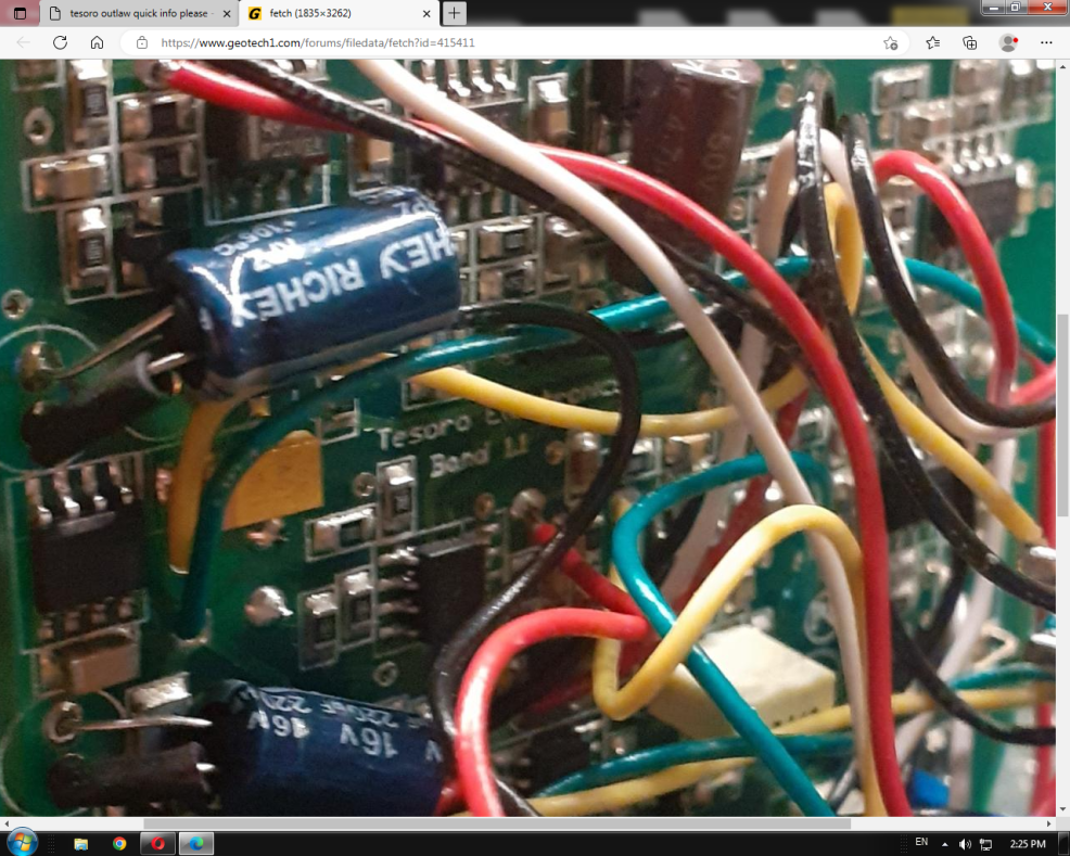

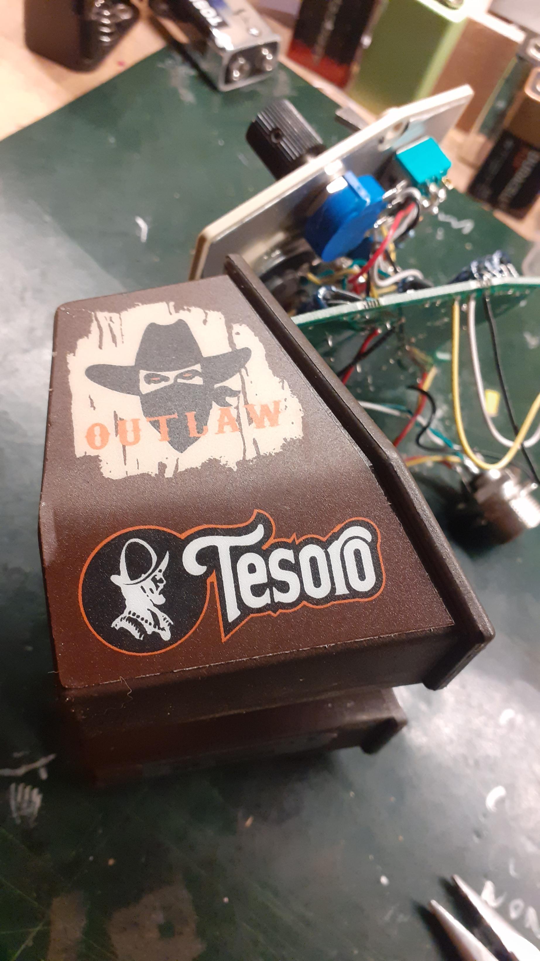

    the Tesoro Outlaw detector is a microcontroler unit ???
    I have opened mine to make a modification and i found no microcontroller... I'm confused... my tesoro silver umax does have a microcontroller on it..
    cannot edit my post... I found on the net that maybe the tesoro outlaw is the remake of bandido II, if someone can confirm, thank you.
      no data on the pcb. if you give the pics i could to seek and compare then with other tesoros. bandido II is fully analogue.
      if you see uMAX in a name it is either with small board in SMT or done with PIC chipo. in first case it is old model, second new/last one.

          I also assumed the Outlaw used a micro but I don't see one. The layout is physically different than the Bandido II uMax but I'll bet the design is almost identical.
            thank you. Carl is sure right. i did not find similarity with other boards. however i see its circuit is complicated. it has 4 lines/channels.
            some kinda like oldie Inca, Pantera, Royal Sabre. without microcontroller, clear analog circuit.

                i see markings on the pcb. Tesoro Electronics and below it Band, can you tell what you see Band II or Band 1.1 or what

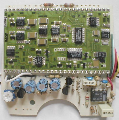

                  No, uMax was applied to all the models with small housings. The first was the original Bandido uMax, which had a ceramic hybrid board with printed resistors. There were several uMax models before they added micros.
                    Click image for larger version Name:	image.png Views:	0 Size:	1.10 MB ID:	415426
                    the marking is:
                    Tesoro Electronics
                    Band 1.1

                      thank you. yup, this is a hint on 'bandido' circuit... there is so small place for whole word... it was stripped off. so 1.1 is a revision of the board.
                      IMO.
                      maybe it was last version before they transfer to ceramic hybrid small subboard, that Carl told. so yup, it is Bandido, in the schematic.
                        And, of course, Spanish "bandido" translates to English "outlaw." Apparently Tesoro literally recycled an old design.
