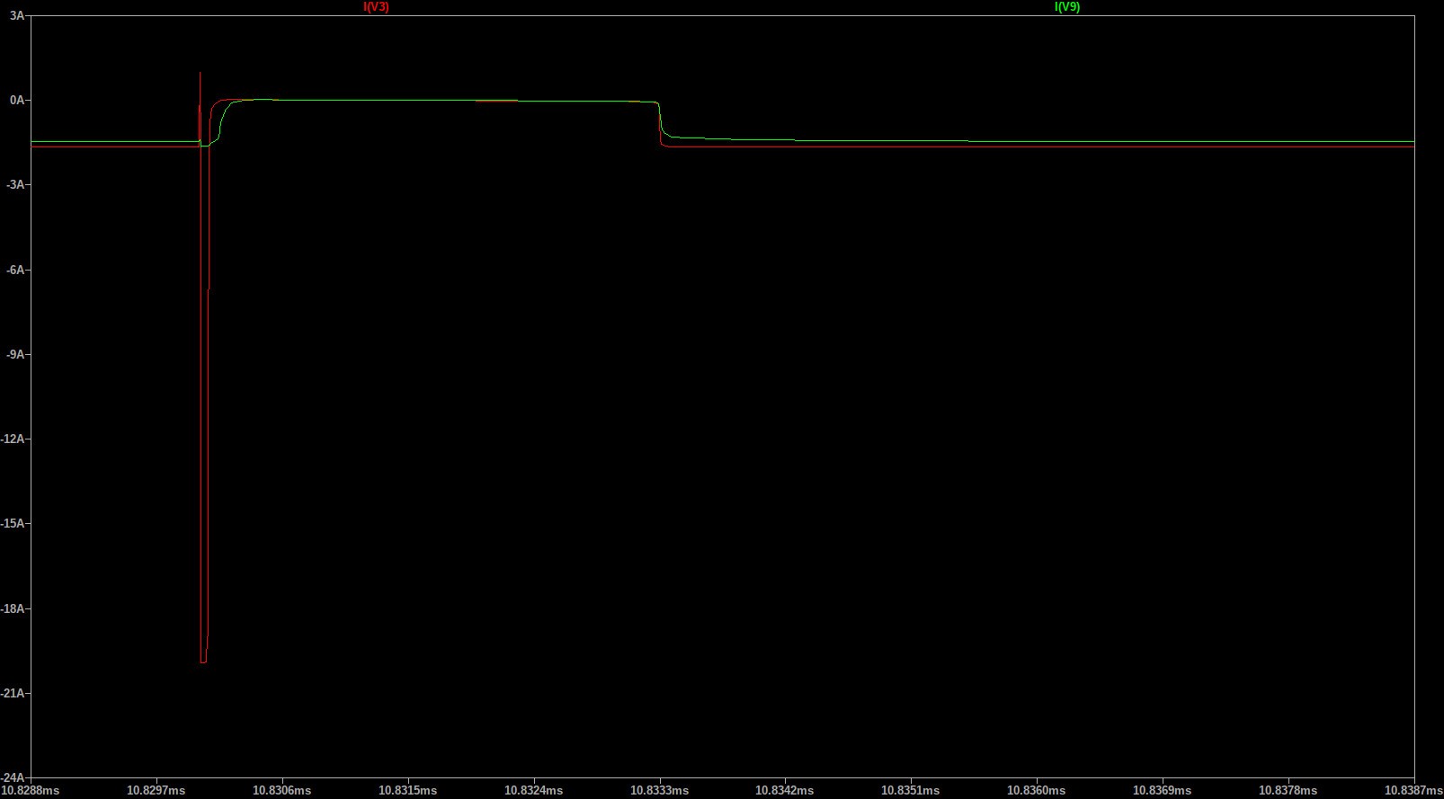

      OK you wanted to know whats wrong with your schematic ( AKA CCPI )
      So I redrew the ARMD TX configuration so you can understand it .
      There is "shoot thru" if we were designing a mains switcher this would be a major problem but at 2 volts DC ... meh !!
      The shoot through on my circuit is about 75 - 90 nanoseconds on every transition ... but since the transitions are every 60 to 120 microseconds I did not worry about them.
      So your schematic does nothing really to fix the shoot through .. playing with the transition timings is messy and could degrade circuit performance.
      The solution ( a solution ) that I like ... is to put a current snubber ( not voltage snubber ) in line with the DC power supply. This prevents the shoot through from occurring.
      I just used some random values for the snubber ... you can calculate an optimal value I will leave it as a challenge for you.
      The pics below show the improvementd D3 R2 L8 below. The red trace is a 20 amp ST. The green trace is the ST eliminated.

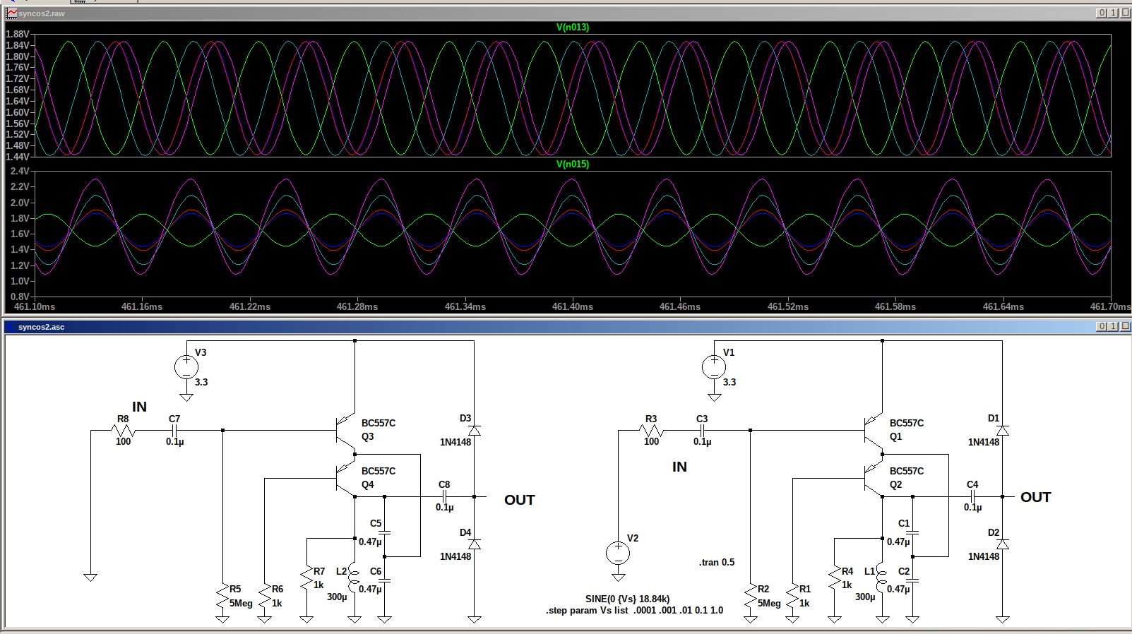

                  Yes it works on the principle that two loosely coupled oscillators will synchronise ... we use one oscillator that is "weak" and wants to be driven by a periodic signal ( even buried in noise ) that is close to its natural beat frequency.
                  This principle will also work with harmonics.
                  eg two clocks on the same wooden beam will synchronise ( eventually ).

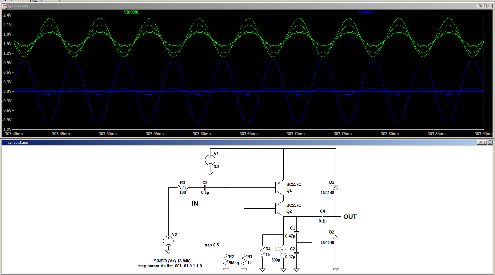

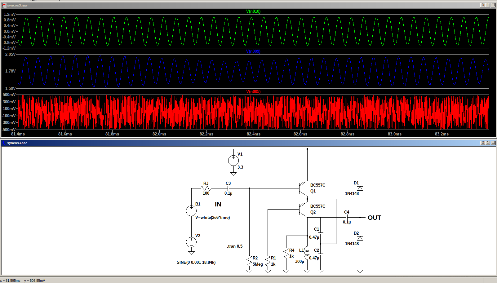

                    Here is the performance of the circuit pulling a 20 millivolt peak to peak signal buried in 1 volt peak to peak white noise. No problem and no phase slip.
                    The green trace is the recovered waveform.
                    The blue trace is the sinewave at the input before noise adds.
                    The red trace is the 1 volt pp white noise and 20 mv pp signal added at input to cct.
                    CHALLENGE QUESTION : This circuit seems almost too good to be true ... What is the the downside ( there is one) ???

                    • ...the same circuit locking in on a 1 millivolt signal in 1 volt pp of noise ... the wanted signal is below the noise floor of the white noise.

                          Interesting. What I see at first glance:
                          The circuit is basically a Colpitts oscillator where the emitter resistor has been replaced by a current source. I wonder if it still oscillates when there's no input signal.
                          The biasing of Q1/Q2 is very sensitive to beta and temperature variations. You can use the LTSpice command .step temp list 0 25 40 to see what happens.

                            • Originally posted by Teleno View Post
                              Thats a good point about the temperature dependance however it is not the answer to the challenge question above.
                              I make it a point now not to publish "theoretical" ltspice simulations on Geotech unless I have checked "real world on the bench circuit" as well.

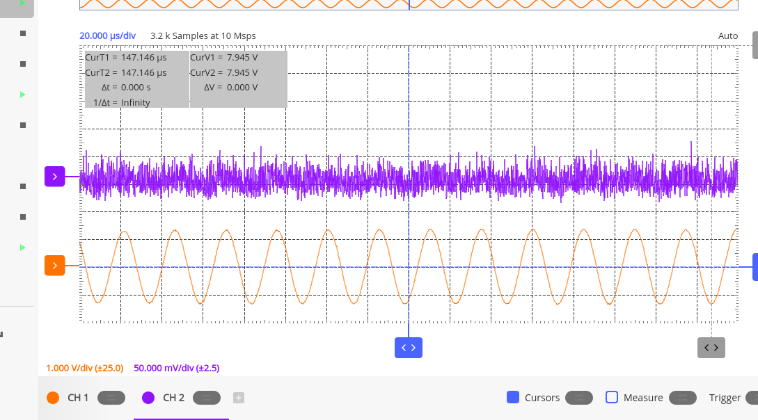

                              The circuit does oscillate without input and it does not demonstrate any temperature variation dependancy I know of from around 10 to 35 celcius ( not expecting it to ).
                              Below is the actual CRO capture of the "real circuit" locked on a noisy input. That circuit is running at around 40 Khz so it has some different component values from the ltspice sim above.
