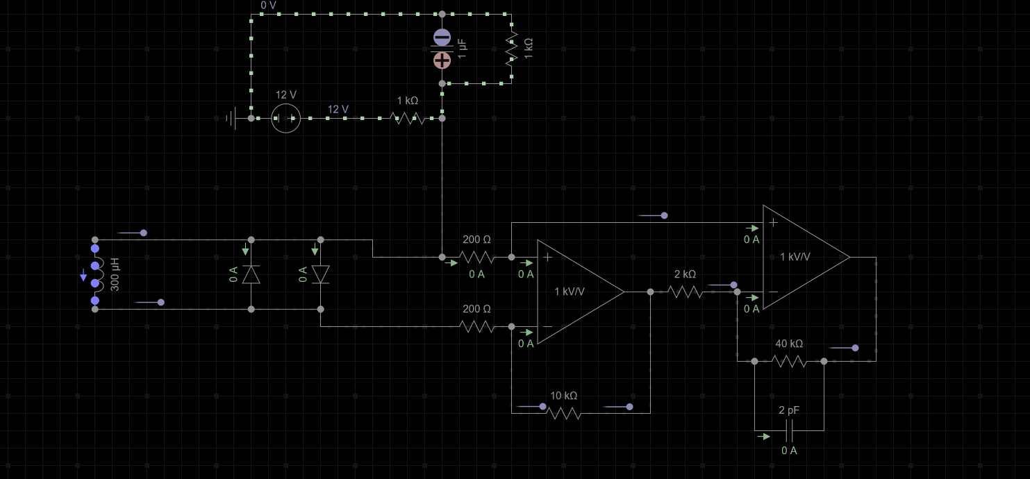

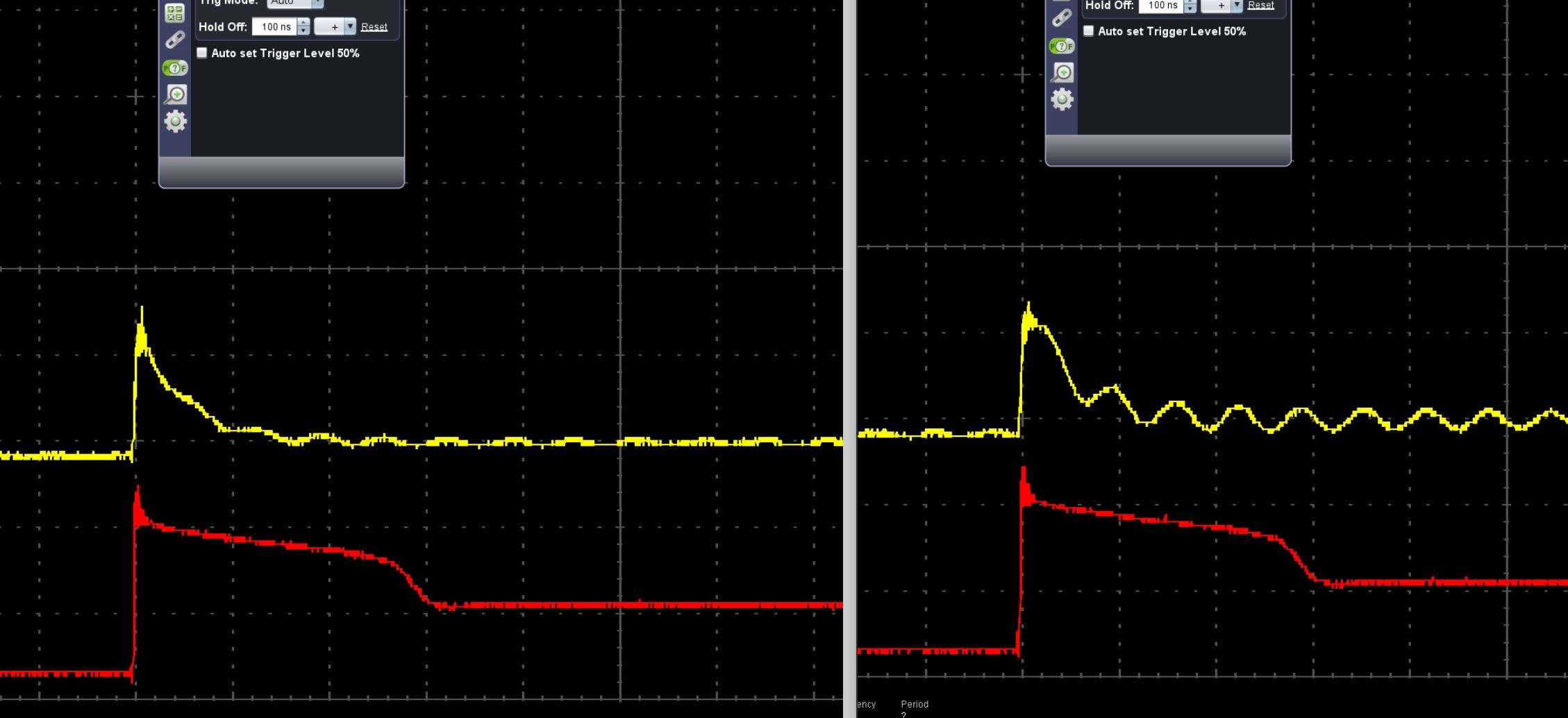

    Hey guys working right now on a DD PI at arround 750hz. i did my tx signal work just fine. now on the rx i struggle abit. Image A show red(tx) yellow (rx) without any circuit small wave idle more wave with a hammer 15cm away.
    now moving to the schematic just ignore the second opamp. when i dont connect the bottom site ob the coil to ground i get a signal like (ba) after the opamp but when i connect it i just get a 12v high.
    do i did a misstake on my circuit?
    You have a 6V "virtual ground" applied to the top of the coil, if you then apply ground to the bottom of the coil then you are shorting out the 6V (through the coil) and, yes, the opamp will likely rail out at 12V due to the DC resistance of the coil. The schematic exactly as you show should work, although you normally want to buffer the virtual ground.
      how to buffer because the signal is pretty weak... after the opamp have tryed till 1m ohm
        The signal out of the preamp is usually not very strong. You then demodulate it and apply A LOT of gain in the back end circuitry.
          idk because i have it on the beadboard.

            I guess I don't understand what the problem is. If all you have is a preamp then the signal will be weak. You need to add the rest of the circuitry.
              all good so far this is the probaly test circuit.
              i dont have build it up yet.
              on the bottom the transistor mosfet gate will be switched later for a IGBT driver
              its all on a pretty early strage right now. and still work in progress

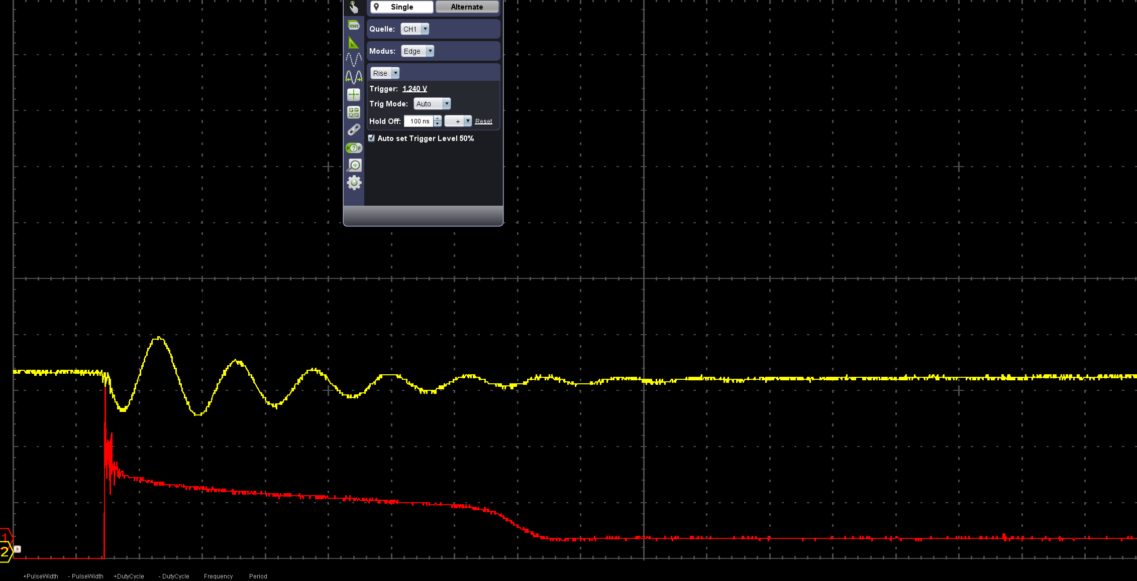

                      was not able to edit the post befor to insert the image
                      first one is idle signal the both spikes are prety high but dont matter.
                      second image = wow signal
