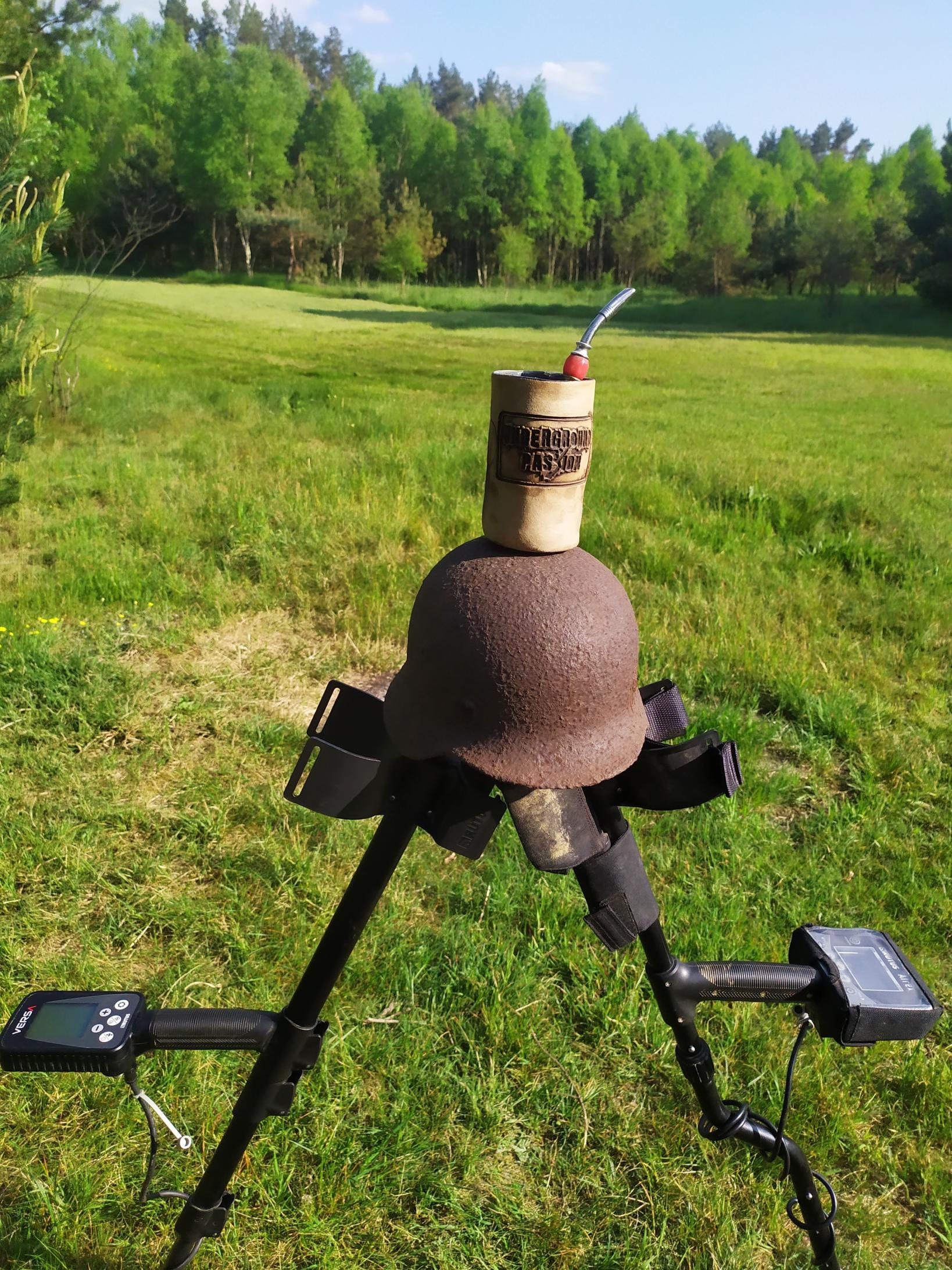

              Currently made detectors with 11 "coils are capable of reaching a depth of 125 cm for objects such as a military helmet...or for a silver coin in the size of a silver tolar or a dollar at a depth of 40-45 cm..
              if you have a problem getting a signal on a 15" /37.5cm/ large target.. at a depth of 125cm, the problem will probably be that this target is very highly conductive and that is why some detectors have a problem seeing such a target not only in the ground but also, for example, during a test air test ... or they can see such a target but have reduced sensitivity and range... because they are not well calibrated for this type of target..
              I myself use for control testing a Russian military aluminum field bottle from WW2.. which is one of such difficult targets../Russian imperial aluminium field bottle from WW1 is an even more difficult target/..​
