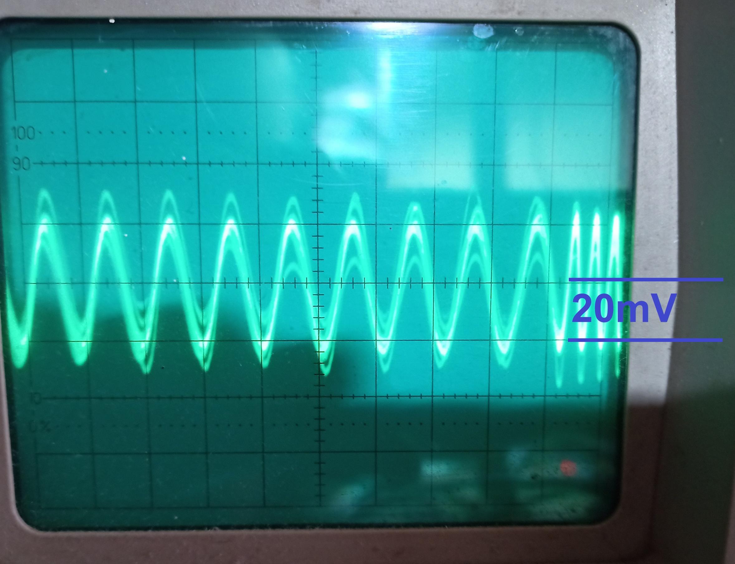

    Without losing the frequency: 30mV,
    if I lower the signal further the frequency goes away...
    Click image for larger version Name:	IMG_20230903_141841_978.jpg Views:	0 Size:	320.9 KB ID:	414770
    frequency losing = synchronisation losing = ok = good balancing, then you connect amplifier U5A

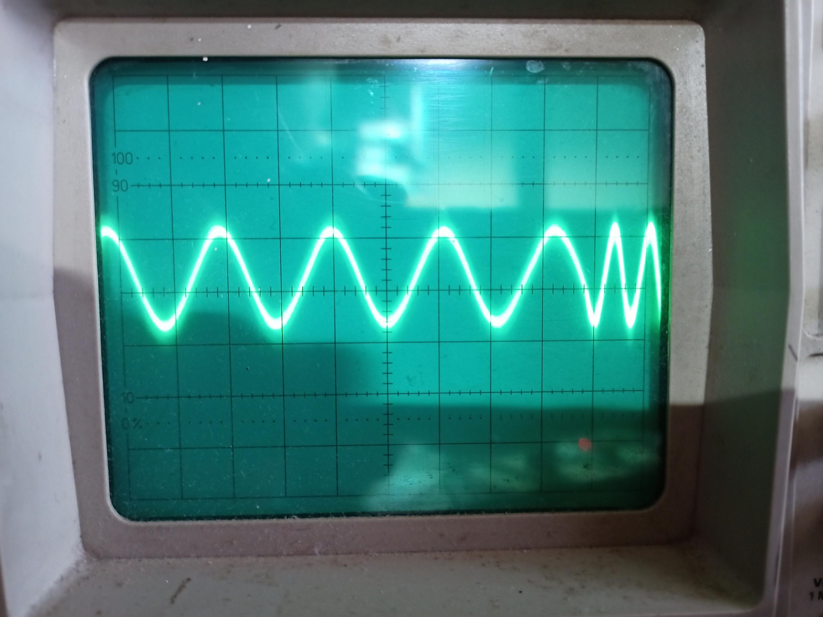

        • On the collector of Q1 I have 22.5V
          At 6 meters one coil in front of the other I get 10mV
          This is the minimum signal at 66cm perpendicular ~40mV
          Click image for larger version  Name:	IMG_20230904_124928_627.jpg Views:	0 Size:	453.8 KB ID:	414809 Click image for larger version  Name:	IMG_20230904_124907_004.jpg Views:	0 Size:	286.4 KB ID:	414808

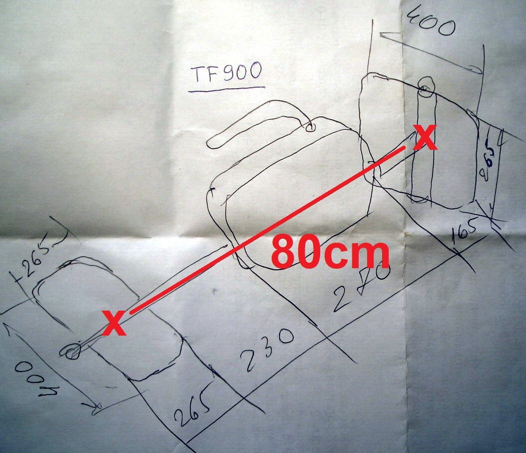

                For the tests I am taking into account that the centers of the coils are 80cm from each other, which I think is the distance between centers of the original,
                regardless of what the coils are: round, square, etc.
Name:	TF900 sizes.jpg
                • Up to 6 meters there is a good signal and frequency, at 8 meters the signal is 10mV

                      • Post #219
                        He doesn't have harmonic, he has interferences from 50Hz power lines.
                        This is sine with harmonics, second and third

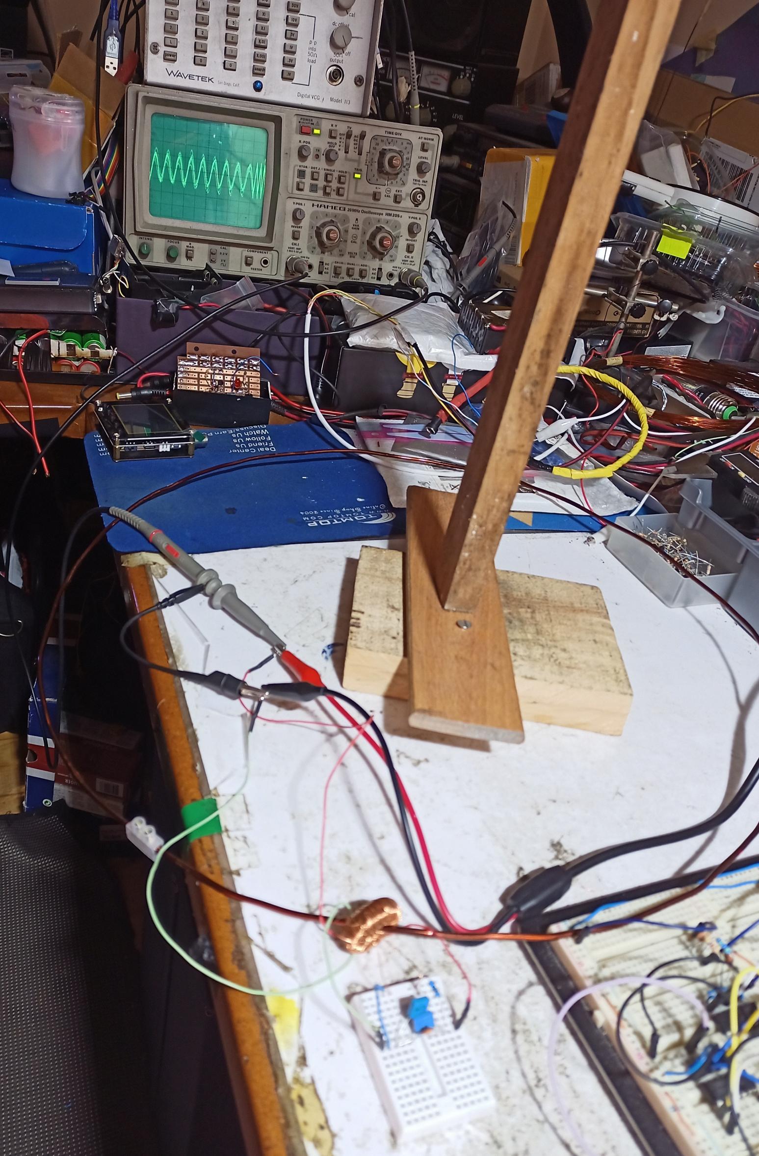

                          • You need a larger piece of plywood with a post as in post #195 so the Tx coil can fully lie on it, attach the Rx coil to the post with hot glue, metal bracket and screws can also be used, then adjust the Tx position for the minimum signal in Rx, fasten the Tx add U5 and see what sensitivity you can achieve.
                            Put Rx,Tx on stool or coffee table.
                            • Yes, that is 50Hz interference since I have the house's electrical panel in that place.
                              Anyway it is just a test of the circuit's operation.
                              I wanted to test the frequency with the 420Khz xtal, freq. real 418Khz approx, -> 6,533 in output, also the change to the CD4040 and the output of Q1 to the TX coil, and this seems to work perfectly.
                              I'm going to order the PCB and when it is assembled with the components, then it will be time to make the final coils and more tests....
