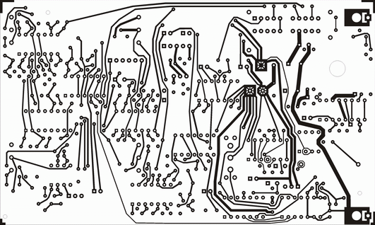

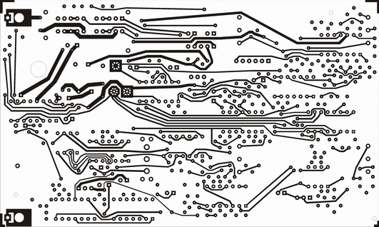

                      TM808's PCB
                      Finaly here it is.
                      All the work was done in AutoCad and exported into CorelDraw and therein converted to raster files. Attached in .zip file are 600dpi .bmp and .cdr files.
                      • #41
                        TOP
                        Preview 1
                        • #42
                          BOT
                          preview 2
                          • #43
                            Bravo!
                            Bravo! Thanks!
                            Regards!

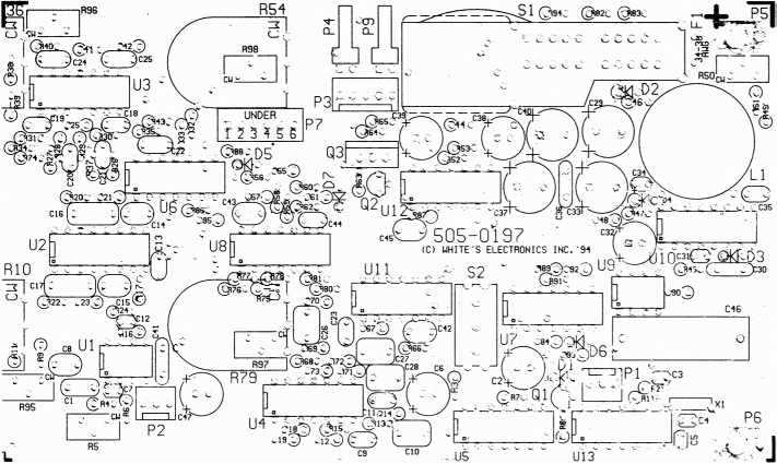

                            • #44
                              There will be small problem with components placement since there isn't a picture with the boards +components values
                              • #45
                                Parts
                                This is not such a major problem as pictures of the board are posted right in this thread ... but to make things even easier I extracted parts placement from scans and here it is.
                                GTK I suggest you assemble board looking closely at shematic (parts placement only for quick help) this way you'll learn much more of the project, also this way you will check the board for mistakes.
