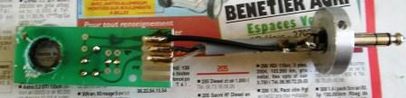

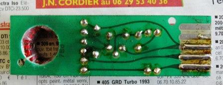

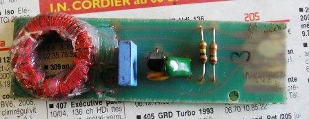

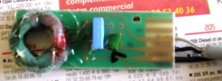

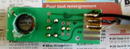

          does anybody know the specs of those resistors and capacitors?
          why is it here http://www.geotech1.com/forums/showt...oil-inductance different? Or isnt it?
          • #95
            i meant of those...sorryClick image for larger version

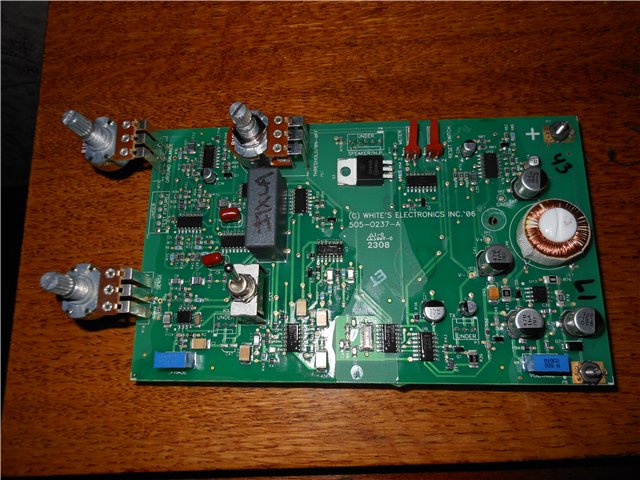

              veltex informs that White's uses SMD board in new tm-808. this is his photo.Click image for larger version
              • #97
                thanks for your quick reply kt315.
                but its without cave mode then i guess. And with the new board (resulting from the new schematic from the forum i guess) i wont need these little platines?
                The new schematic leaves me with a lot more questions than the old one from 1994... so i would prefer the old type.
                Do you think, the new type is somehow "better"?
                Did anybody in this forum finish this project and built his TM808 including coils??
                Would be interessting...

                    • veltex did share the PCB photo in hi-res http://zalil.ru/33974909
                      enjoy.
                      • Ive already seen this foto... thanks anyway
                        kt315, would you build it with or without the cave mode?
                        greets
                        • only one man had built the TM-808 and got an result, his board was been in SMD. I wrote his nick - veltex.
                          good luck
                          • Ok thanks again... i´ll ask him for more details...
                            Whish you the best!
                            Manuel
                            • I can not write to him, for whatever reason. Too bad.
