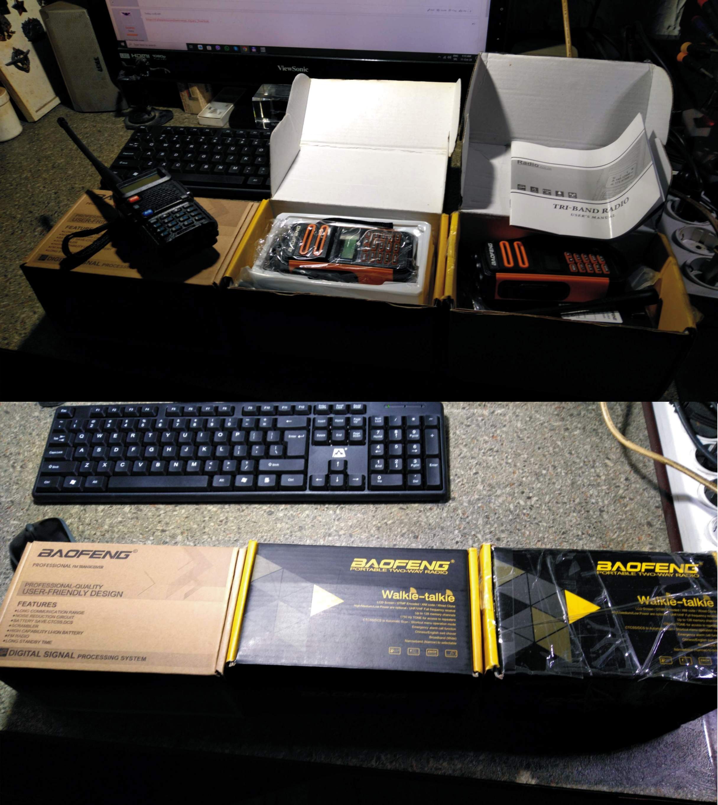

                I also have these 3 (I had a dozen of various modes, people come and take them... but don't remember to return them). All 3 have the possibility of receiving Airband.
