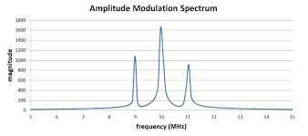

      Modulation
      8kHz, 12 kHz, 16 kHz

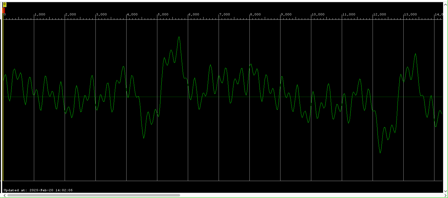

        OK, I've gotten very ambitious and have managed to generate and combine 8 x sine frequencies in the FPGA.
        These are 1.2kHz, 3.2kHz, 9.6kHz, 12.8kHz, 16kHz, 19.2kHz, 51.2kHz and 96kHz.
        The resultant waveform shown has equal amplitudes at each frequency but I can adjust relative amplitude of each.
        I can also change frequencies on-the-fly in 100Hz steps - just so long as I keep them all fitting nicely within my synchronous demodulator sampling window which is 2.5mSec (1920 samples at 768k sample/sec).
        Even though it kind of looks like a mess, the synchronous demodulator successfully extracts the correct amplitude and phase of each.
        It's unlikely that I'll use all 8 simultaneously, but I can if I need to

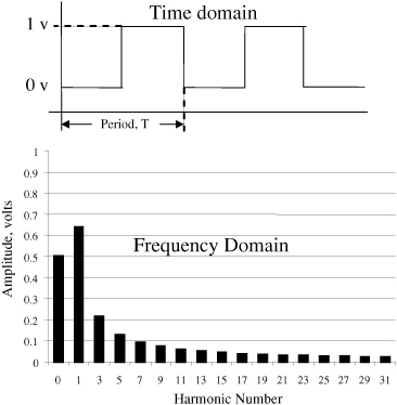

          square wave has a lots of harmonic,

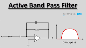

          to select them band pass filter needed

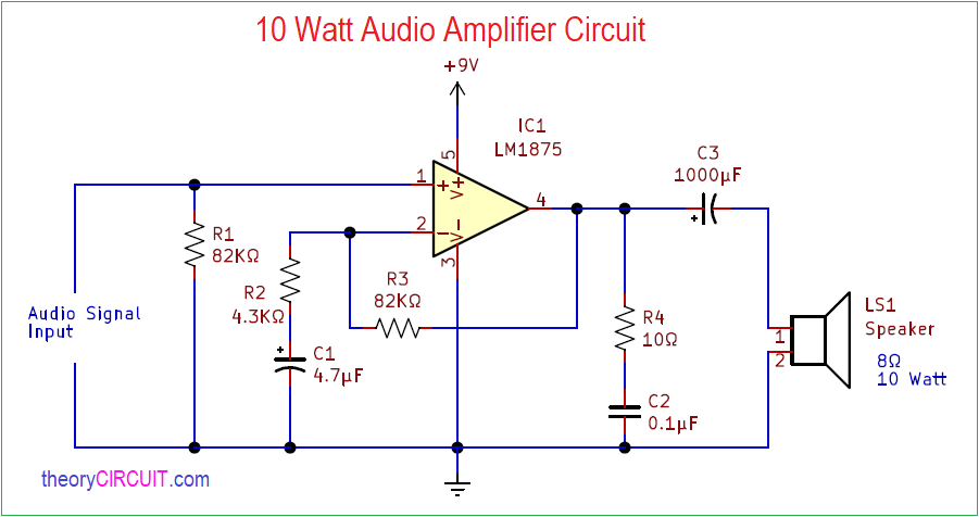

          then 10w audio amplifier

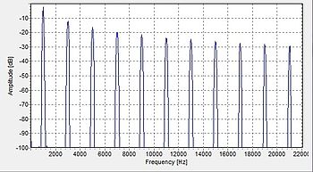

                  The problem with using the harmonics is that the amplitude decreases with increasing frequency, whereas realistically we might need the amplitude to increase with higher frequencies.
                    Use a sinx/x or sinc transfer function and the spectral response is flat. Very easy using an FPGA.

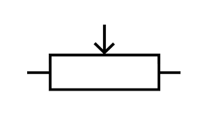

                          from 5V square waves you will have to big amplitude so you need potentiometer to adjust it to tens of millivolts = sensitivity of audio amplifier.

                              OK, I'm very happy with my sine wave generation and demodulation now! I'm driving this out of the FPGA via a 16-bit R-2R Ladder DAC.
                              I'd like to just hook this up to an off-the-shelf audio amplifier for lab testing, but these don't normally approach anywhere near the 96kHz I want to go up to so I'll probably use the LM1875 as a starter (Thanks for the recommendation Pito).
                              It doesn't go quite as high as 96K, but it does have a 70kHz bandwidth so it'll be good for initial experiments.
                              • #45
                                Found an LM1875 kit on Amazon, all parts plus PCB for under £6. Arriving tomorrow...
