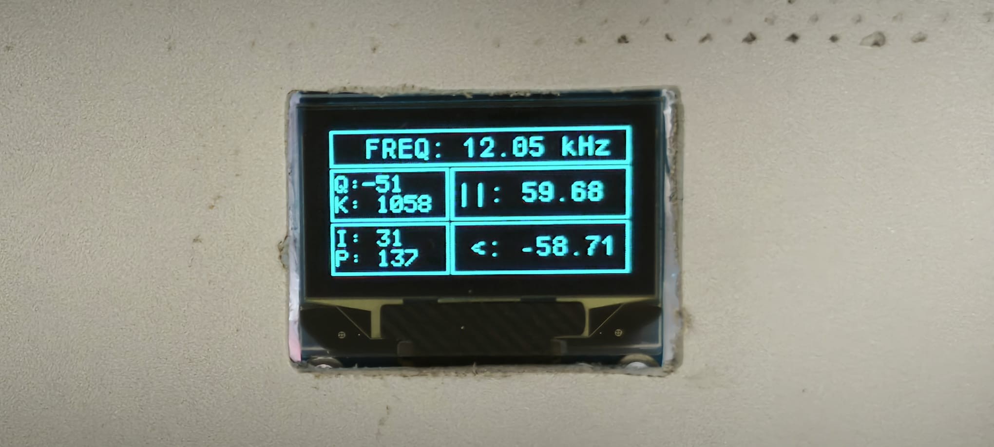

      And here it is a view of the display. It shows the measured TX frequency, Q and I channels (whith their K and P indexes to minimizes them, controlled by the encoder), module and phase of the received signal. I am now working on the code level in order to perform better averages of the values in order to minimize noise. The magnitude is too noisy to use it as a trigger for detection, I am still using Q as a target detector.
        That's what everyone does.
          I tought I could do something a little more sophisticated, but it is not really important.
