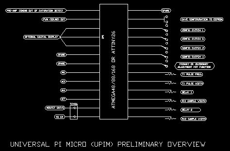

                    Universal micro for PI experiments.
                    For a while now I have been thinking about making a PCB with an ATMEL micro that is set up to be used in a variety of PI experiments. The ATMEGA48/88/168 would be the optimum choice for the following reasons.
                    Very inexpensive.
                    6 * 10 bit AtoD
                    Easy to use/replace 28 pin PDIP package available.
                    Enough spare I/O to make the micro configurable with jumpers and pots rather than the user having to buy the programming tools and learning a new language.
                    16 bit PWM for generating sound.
                    EEPROM for storing favoured settings.
                    The board will be configurable for either N or P channel MOSFET's via jumpers and a dedicated MOSFET driver chip.
                    Pot inputs will be available for setting TX pulse width, pre-sample delay, sample width 1, inter-sample delay, sample width 2 and battery voltage or threshold.
                    If there is enough interest I will go ahead and charge just the material costs and postage.
                    If you are interested or have any suggestions on features and functionality let me know.
                    It won't take long to set this up as I have done a lot of the work already for my own PI and have nearly 20 years experience programming a variety of microcontrollers.

                          UPIM overview
                          hi bbsailor,
                          Attached is a broad overview of the UPIM.
                          The number of I/O (ie keyboards, displays etc) is virtually unlimited if the SPI is used to drive shift registers.
                          The number of AtoD inputs can be expanded also by multiplexing.
                          The chip can be driven to 20MHz but that requires an external xtal. My experince has show that the std 8MHz is sufficient with the micro executing delay loops most of the time.
                          I agree with your idea of a Hammerhead type start with the option of ground balancing. With all key parameters variable by the user via adjustable pots & switches then virtually any coil can be accomodated.
                          I have added an option called "Pre-amp coming out of saturation". This optional input would allow auto adjustment of the first sampling delay.
                          The TL426 chip is a MOSFET driver (30 ns to switch 1000pf) The spare gate is used to generate the +5v (above battery plus) negating the 7660.
                          bugwhiskers
