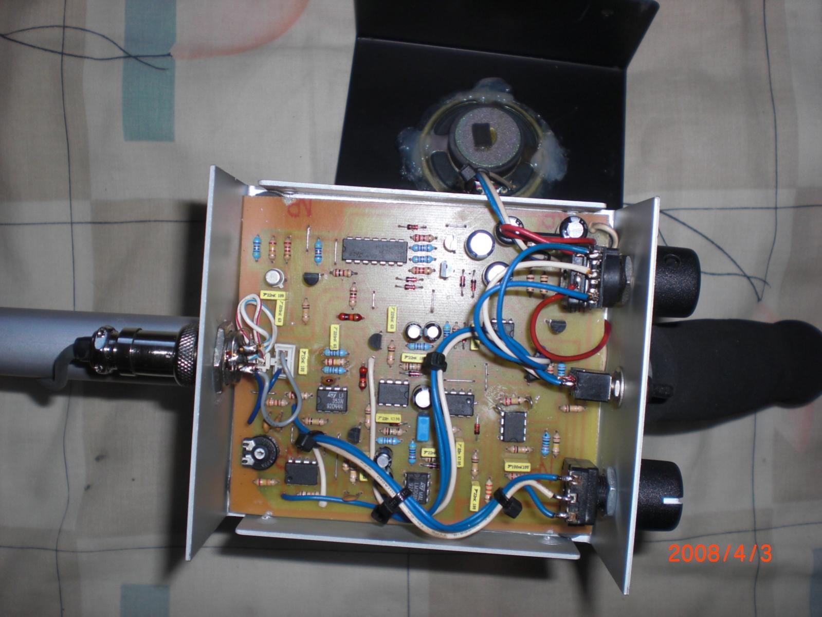

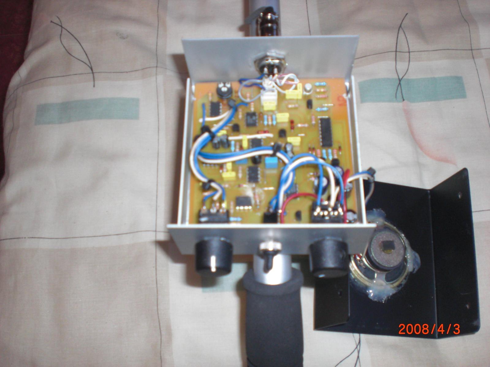

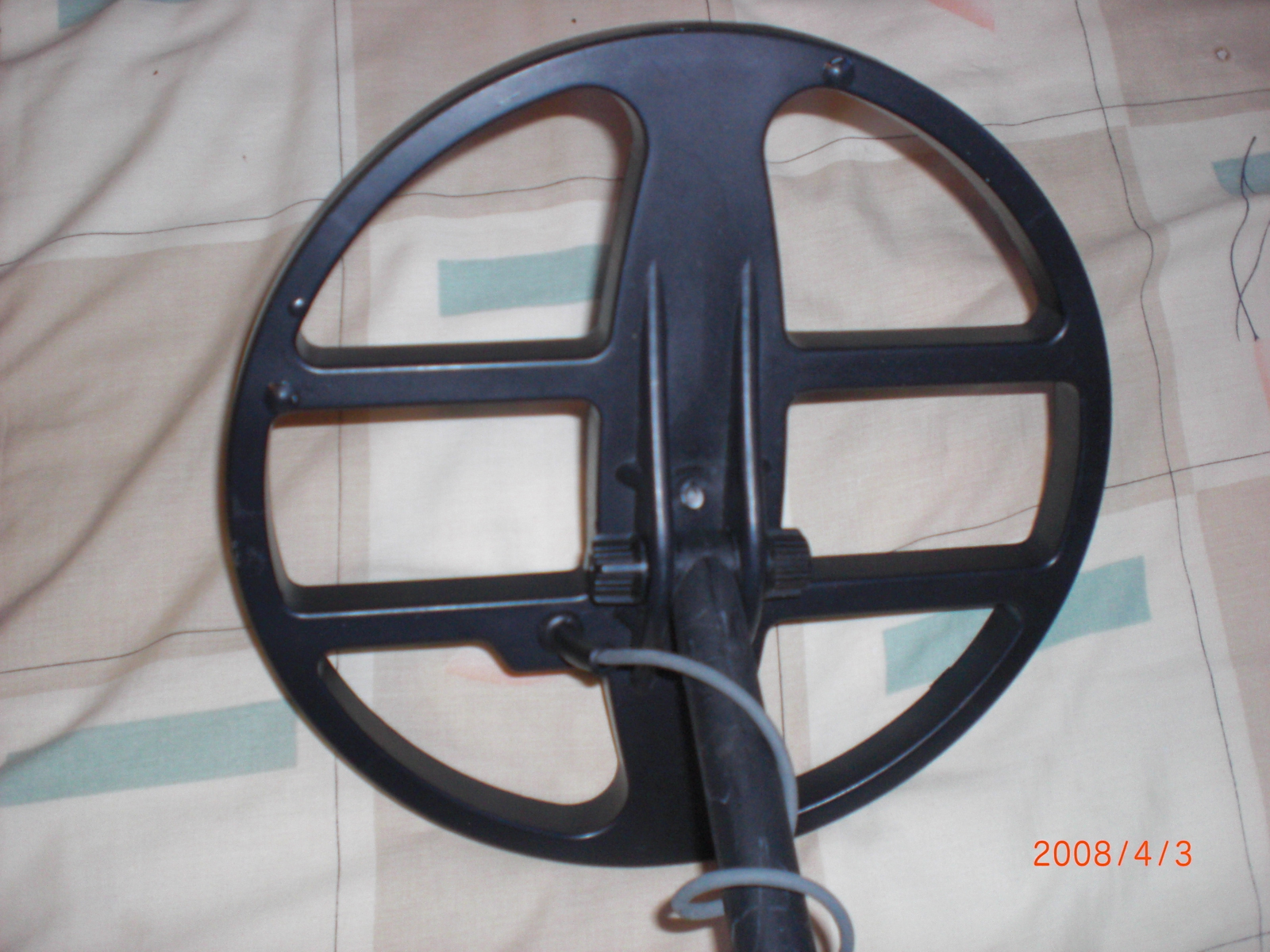

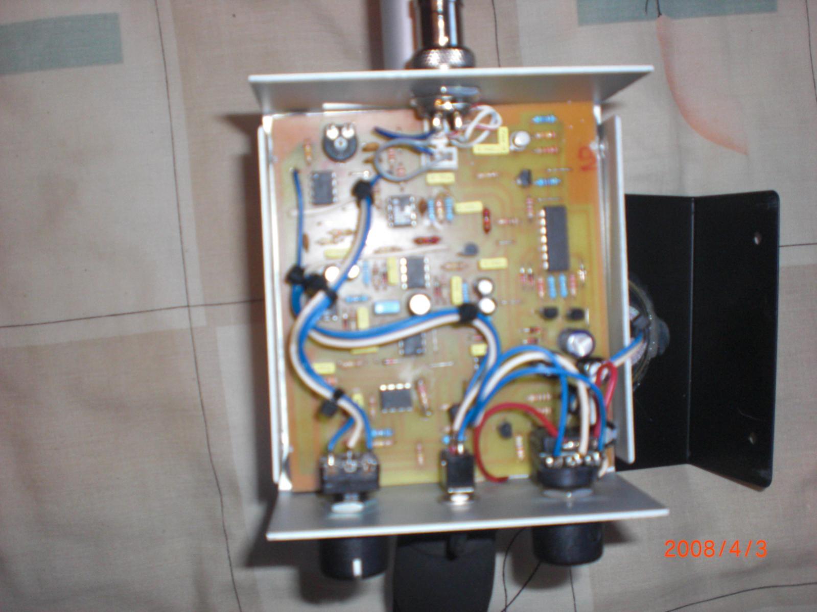

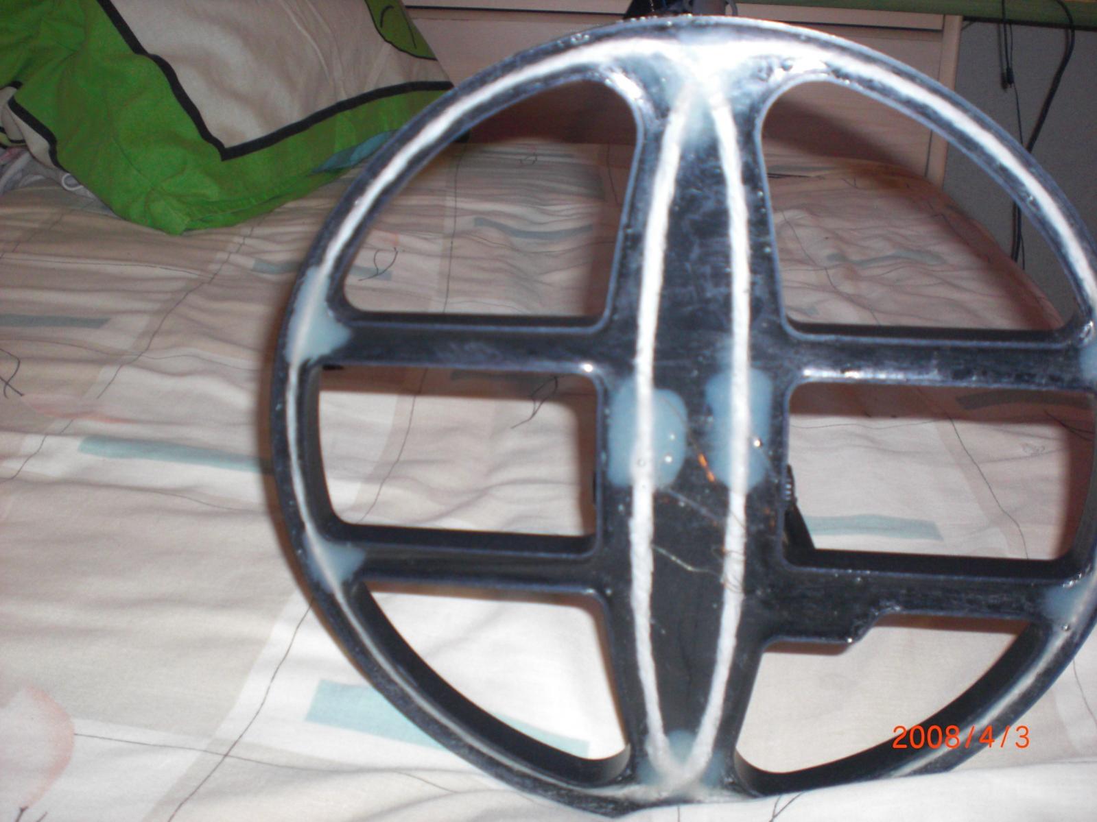

              • Hi I am posting my TGSL circuit is tested and works great no errors and maximum sensitivity to cop a gold wedding ring to 35 cm in the air the cancellation of the coil is 4 mV.
                • TGSL
                  • TGSL
                      That is great eduardo! Good work! I was not able to open your files, but it looks like you are getting very good results on your tests. I am at the stage of making the shells for my coil and have been there for a while. I hope to be able to get back at it in a week or so. Have had some medical problems.
                      Jerry
                      • Ditto on the file extension- can't open
                        Can you use a different program to send the files??
                        • Originally posted by turtlebowl View Post
                          Inside the zip (and rar) is a LAY file. This is the format used by the SPRINT PCB software.
                          • Sprint Layout 5.0. Regards!
                              TGSL
                              Hi eduardo1979:
                              Is this a new layout you made? If so, what layout did you start with to modify?
                              I like that speaker is connected with short ground trace to power supply ground. But the speaker circuit looks different from usual TGSL. Different resistors, no big capacitor????
                              Can you post schematic your PCB is for?
