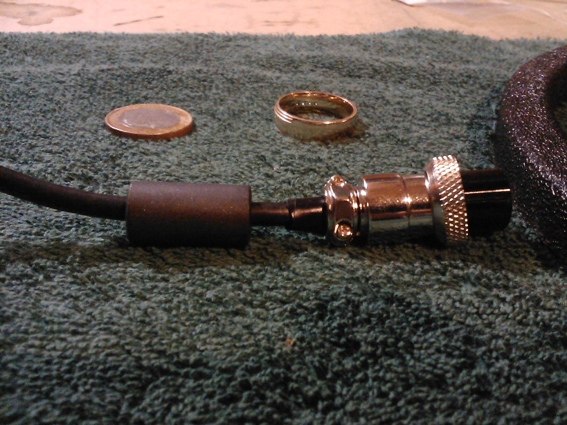

              • TGSL - promising improvement
                In one of the other posts entitled "Metal Detector -Upgrade for Greater Depth- 25% to 30% " I decided to dig a little deeper on what this guy was selling, and here is the only thing I could figure:http://metaldetectorsnow.co.uk/4-99-...garrett-etc-2/
                Certainly not my idea .. but with the way that the TGSL reacts to EMI - robbing detection range, why not try a quick and dirty experiiment.
                I clipped this off of an old PC power brick and Voila! Pretty early to tell, but it believe it DOES tend to improve detection range. I have to get out of subjective mode now and take some hard measurements. Noise measurements to follow.. Simon, you HAVE to try this..
                Don
                  Don

                      Sorry for the bad link. Here it is again:
                      I have been doing some additional reading on ferrite beads and metal detectors and there seems to be some contoversy on thier effectiveness. Maybe others on this forum have investigated the usefulness of the idea before? I guess they have their place.. Just wondering if it might be here..

                              I haven't tried it yet, but trying to think how it might work. I'm guessing it chokes off any "common-mode" signal coming up the cable -- of course we don't want it to block the 14.5 kHz differential signal. Maybe it will be more important with the "grounded RX" coil configuration than the "ungrounded" RX coil configuration, because the ungrounded configuration has better common mode rejection???
                              One question I have is how a shielded cable responds to such a choke, and if that is different to a side-by-side pair such as a power cord. I think they work the same, but just wondering.
                              I still suspect that the worst noise is picked up by the RX coil and looks like the normal differential target signal, so the choke wouldn't stop it. The only way I can think to reduce it (so far) is dual RX coils which cancel the noise but don't fully cancel the target signal. But it makes a very awkward search head. I've started experiments on that.
                              -SB
                              • They reduce signals running up the braid.
                                If a device sources a lot of emi noise, these ferrites serve to reduce noise on the way out.
                                Same the other way round.
                                I would fit it at the box end, rather than the coil end.
                                if you are in a noisey environment and 'one' helps-- 2 should be better and so on.
                                Schaffner make a good one.
