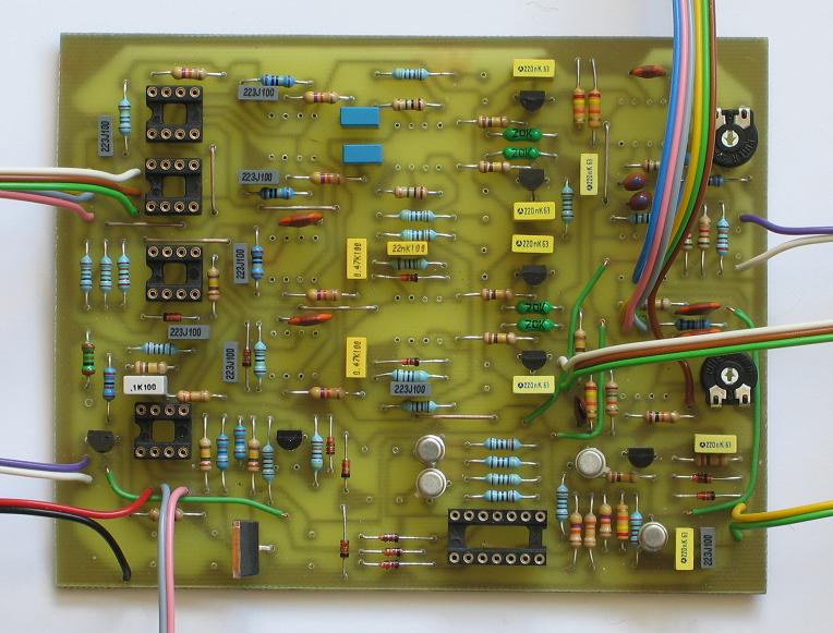

          • This is my TGSL pcb.
            A képet a Képfeltöltés.hu tárolja. http://www.kepfeltoltes.hu
            • Originally posted by Ropcsika View Post
              Please help me! I build TGS. If you connect the tx coil it beeps continuously. What is the problem?
              Hi
              Before you jump in at the deepend the most common fault for the symptoms you have is wrong connections on your 2n2907s and your 2n2222a, check the pinouts because theres at least 3 diffrent type pinouts depending on what manufacture made them.
              Far as your hef4024 leave it alone theres nothing wrong with it.
              Your boards look ok but always worth doing continuty checks on the traces with your meter before populating.
              All the best

                Okay, I check everything
                • YEEEAAAHHHHH....
                  It's working, soldering defect
