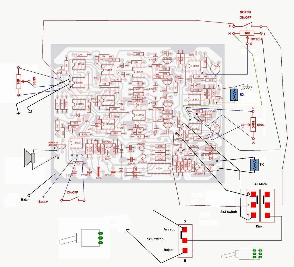

  • that may depend on the particluar board version you are using
    I have this layout, it may help

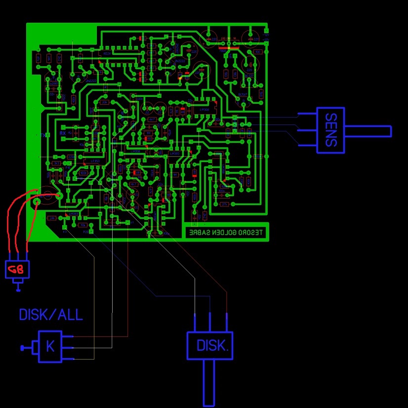

            • when I see it the TGSL-EDU version haven't ground potmeter? (just: sens, disc, and all metal switch)
              • Originally posted by Biogas View Post
                Found my TGSL-EDU picture, Ground pot is pcb pot (bottom left) - you can replace it of course with external pot

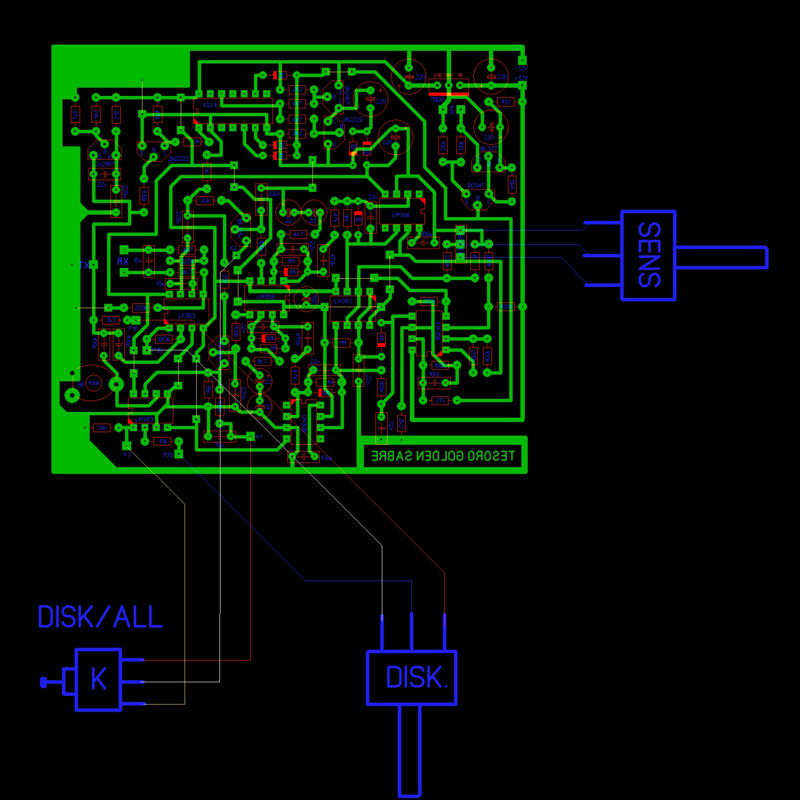

                • Hi Silverdog!
                  Thank you very much the picture! But I dont understand the explanation: where is the connecting points for the ground ballance external pot?
                  THX
                    Hi Silverdog!
                    THX
                    Like this ?
                    • Originally posted by silverdog View Post
                      Like this ?
                      [ATTACH]21397[/ATTACH]
                      I don't think the third wire is needed on the CW side.
                      • of course not that pad is not connected - it was drawn to show where the existing pot is on the pcb
                        I should have left the third wire off
                        • It is perfect, thank you!
                          • Hi evrybody!
                            The TGSL-EDU version have on/off swich or pot?
                            If yes, wich is it?
                            Thank you!
                            • THX Silverdog, I try it!
                              • Pot
                                Hello!
                                The ground potentiometer is what value? 100 k Lin?
                                The sens potentiometer is it the 100 k or is it the 10k?
                                Thx
