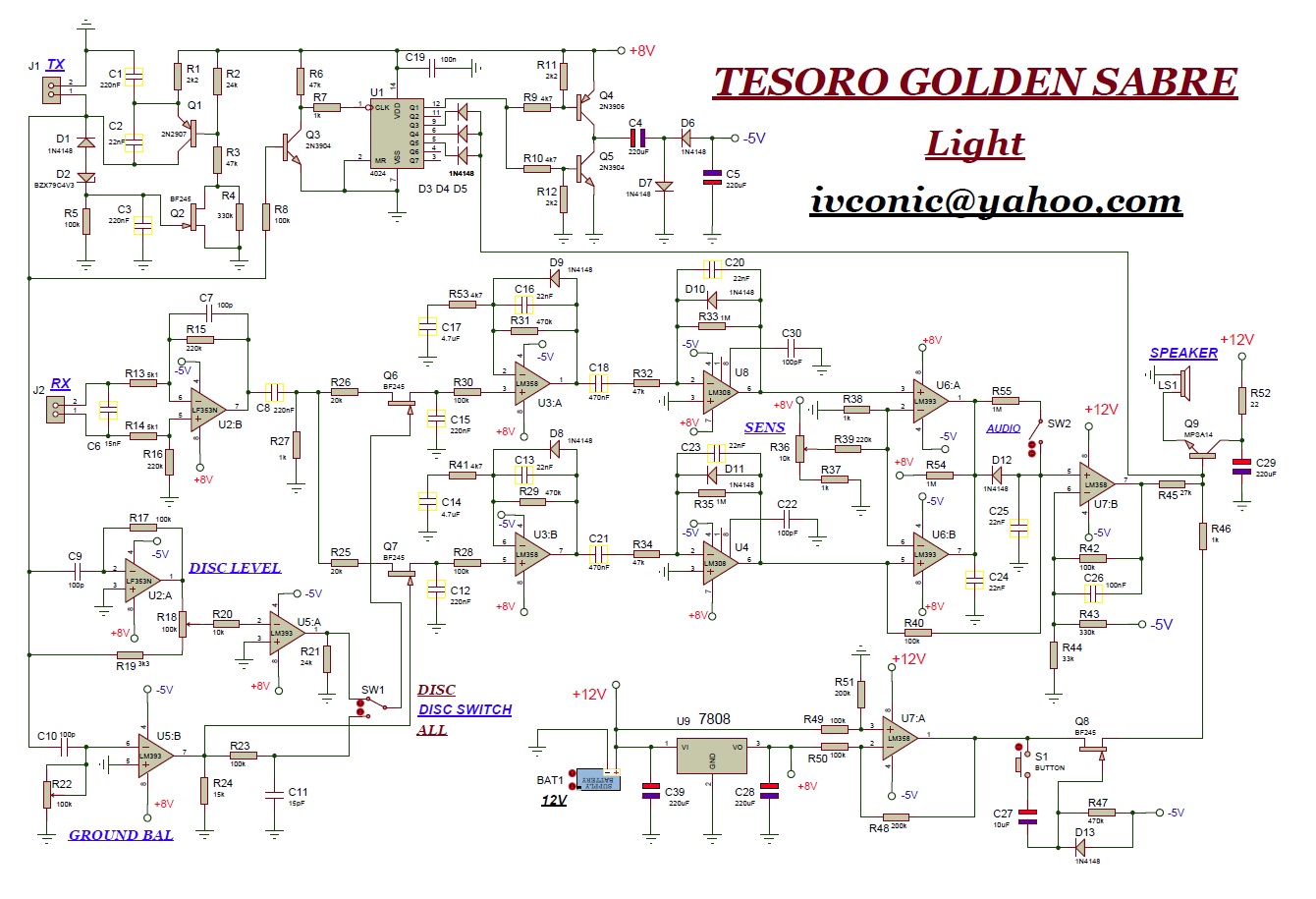

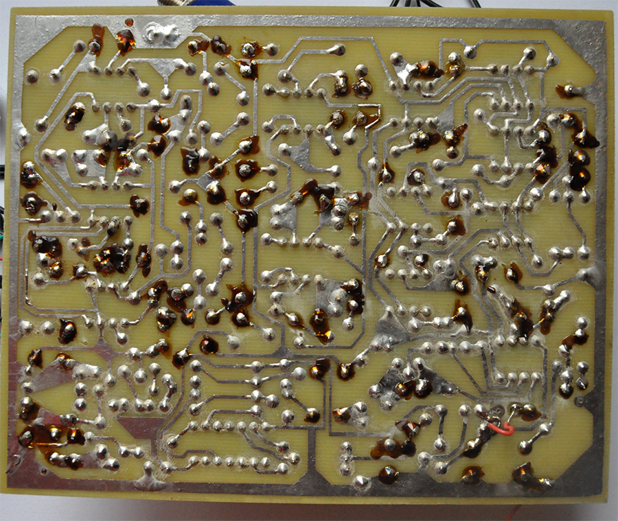

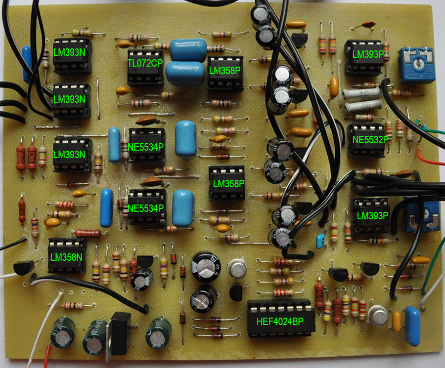

Your picture is not clear about what you did so far with your board. I tried to enlarge it and rotate in various ways, but I'm unable to read critical points. In case you connected capacitors in parallel, yes it can be a cause. Also if your op amps are not according to the schematic you can experience problems as you described. Problem is with some op amps that they behave completely unexpected if input voltages go beyond common mode voltages. LM358 is fine, and you can use it even as a comparator, but TL061 goes bezerk if any input goes down to negative rail.
As you'll want your rig to behave as it was designed to, it is advisable to replace those capacitors with proper values, and best choice are the non-polarised ones. You can't expect it to work properly with wrong time constants in filters. Once you fix that you'll see if the buzzing problem persists, and seek further if it does.
