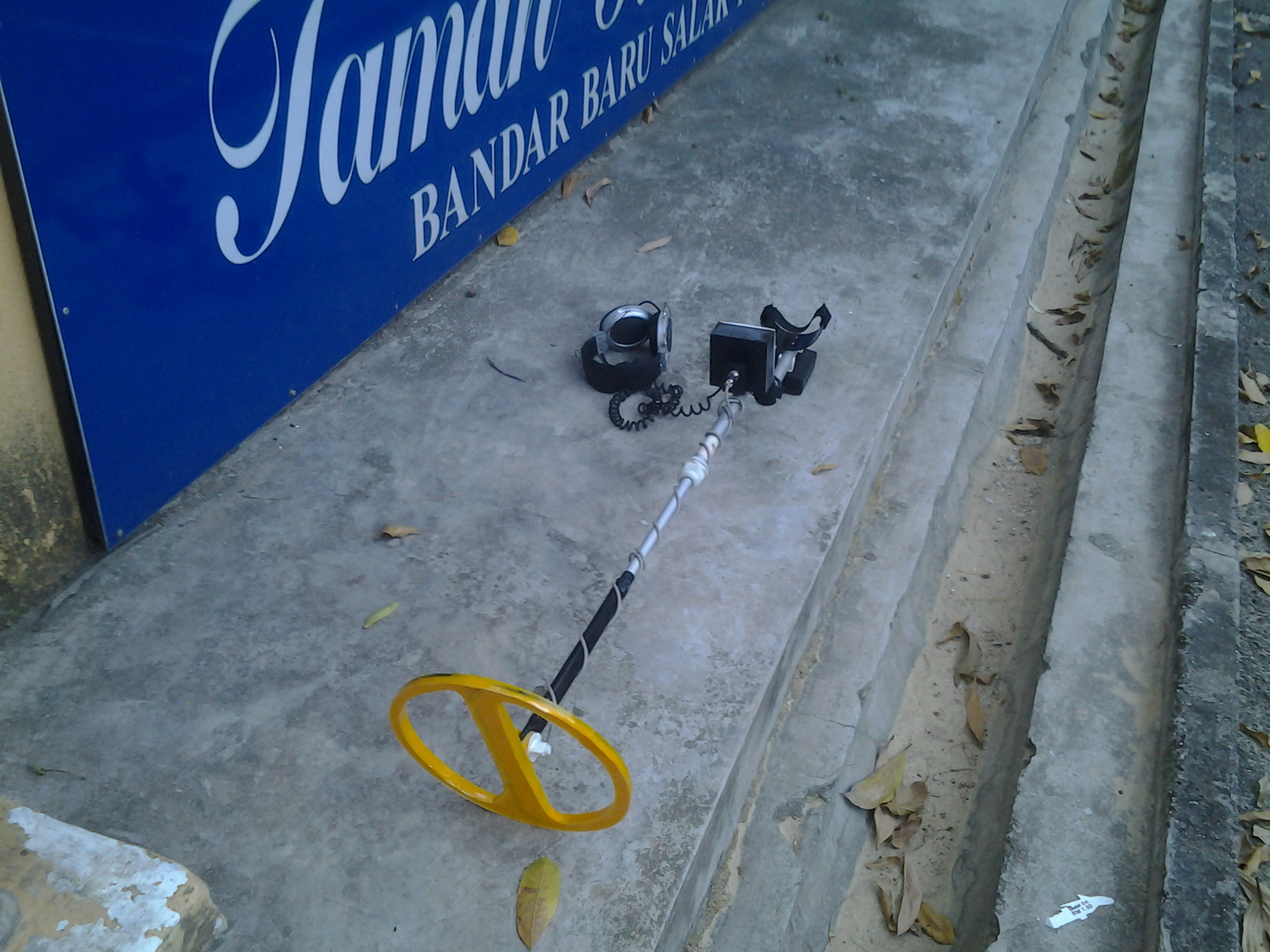

                • got it, thanks anyway.. turns out the -12v wire was nearly spoilt.. heres a picture of my finished tgsl.. thanks to veryone for help especially to fabian for the small pcb design.
                  • Nice work!
                    What is the weight of the coil by itself, and the whole unit?
                    Would like to see a vid of it in operation.
