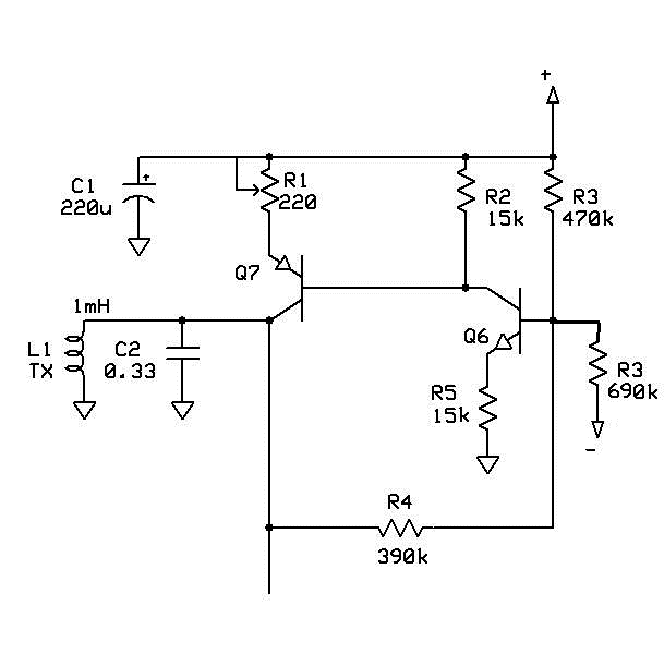

    • I was just playing with the minelab oscillator and managed to get it to run at 14.7 khz
      just like the original TGSL one and using the AB/C configuration it only draws around 4ma!
      I needed 0.124 uf to tune my 1 mh coil to 14.7 khz. It puts out 19.3V peak to peak and
      draws 3.9 ma in AB/C mode (normal mode is 9.9 ma). I had another coil that was a little off
      somehow so had to adjust the resistor to the -9v to 770k (from 681K) to make sure it stayed
      running.
      It's a nice oscillator. I could adjust the frequency from 9 khz to 15 khz and the amplitude
      stays the same. Current is up there without the AB/C mod but it traps a lot of current in the
      coil (150 ma!) and with the mod the power use is reduced when the negative supply comes up.

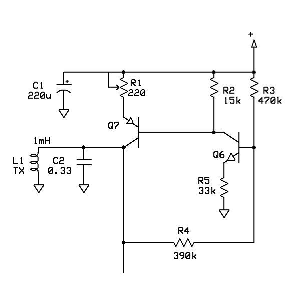

            • Opps I had meant to post the schematic;
              Original
              AB/C
