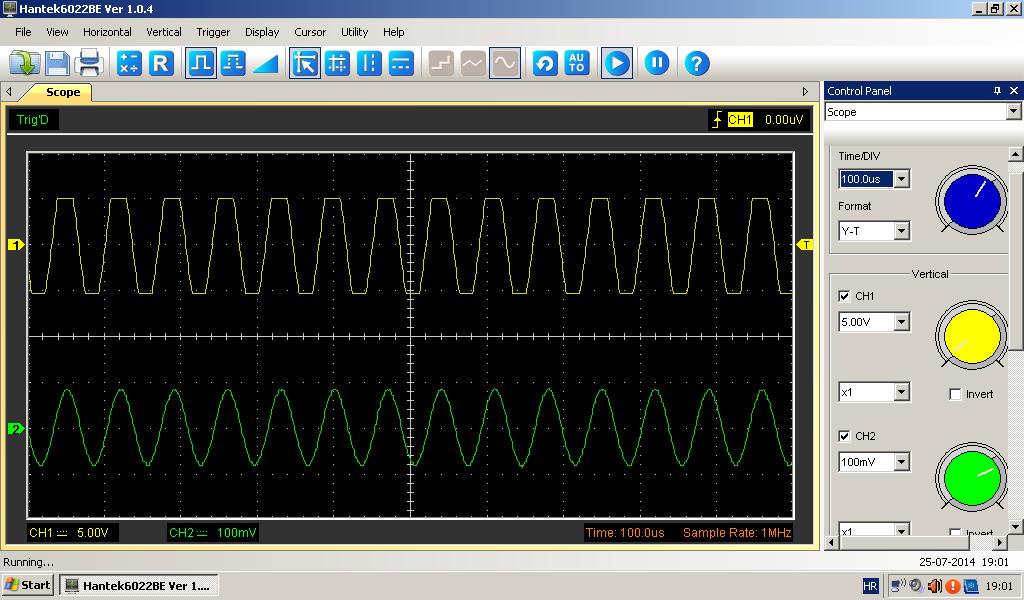

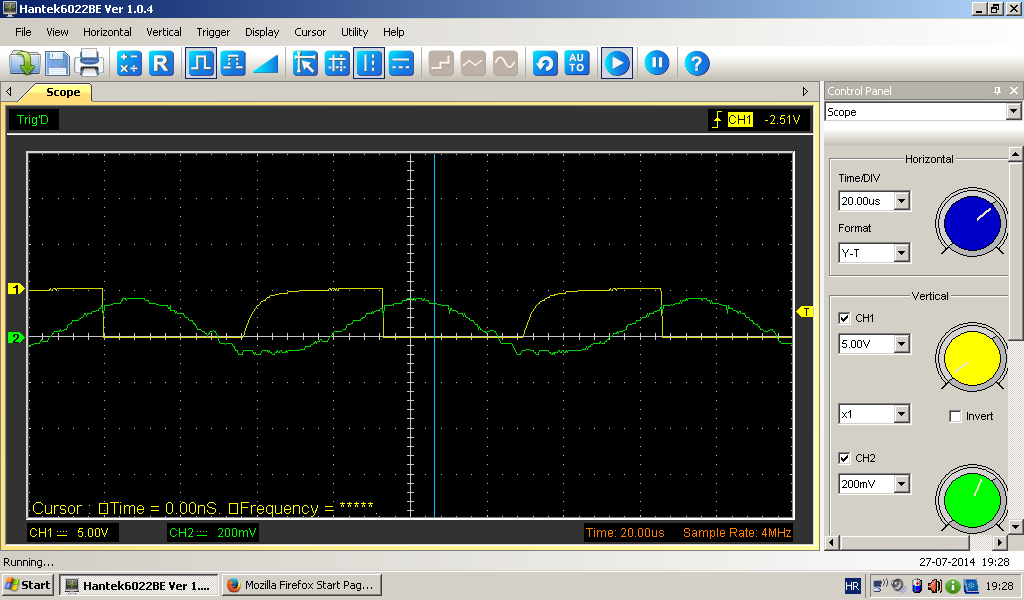

  • I have strange TX graph ... it is cut off
Name:	tx-rx on connector.JPG
    TX is cut off, RX is one sine wave.
    Maybe it is not adjusted with board or ...

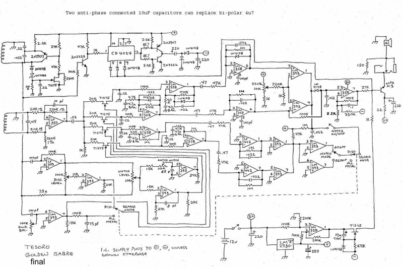

                    All i see on schematic Pin 4 is 5v and pin 8 and 7 is 8v

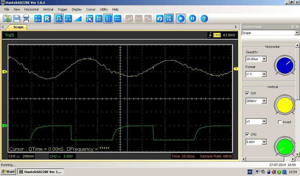

                      U101 and gate or TR5
                      With lot of EM fields.
                      If I get metal close to coil it clears - sine wave.
                      Only coil shield (USB cable shield and coil shield - mylar) is on GND and one of two wires TX (from PCB)

                          • Well reducing the 1meg in the first filters to 470k is a start.
                            The original had a small TX 8.X volts as I remember so adding
                            the FET stabilizer will tone the TX down.
                            These designs are sensitive to TX and RX changes. I'd recommend
                            building as per original schematics before doing any mods.
