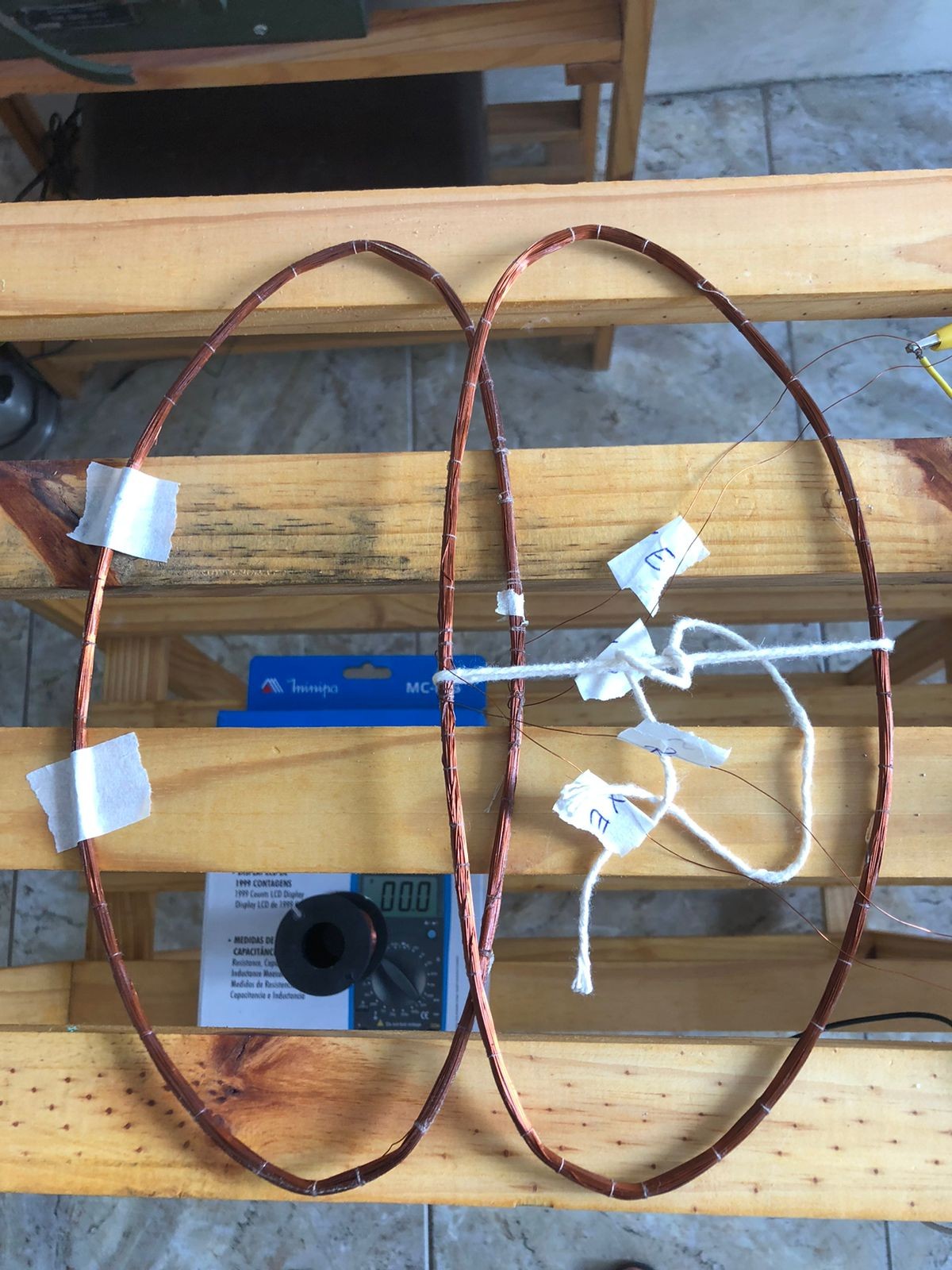

                  • What I remembered when making the coil for the TGSL (and other Tesoro copies) is that you should stick to the ratio of the difference in inductance between the TX and RX coils around 0.5mH.
                    RX is always for 0.5mH more inductance than TX.
                    Second, with the Tesoro models, the two capacitors in the oscillator always define the frequency factor.
                    They are mostly rounded values: 223+224, 333+334 or 473+474.
                    And because of that, it was shown and proven to me that it is best to wind the TX between 5.6-5.8mH and the RX between 6.2-6.3mH.
                    Of course, different inductances will work, but then fine-tuning the capacitance is an additional effort.
                    For the sake of easier balancing of the coils, it is preferable to always keep a difference of 0.5mH inductance between RX and TX.
                    Another thing that makes it easier to balance the coils correctly is the geometry of the TX and RX coils.
                    I think I strictly mentioned this once upon a time because it makes life a lot easier for hobbyists.
                    The geometry published by Artyom is "crueler" and it will be easier to balance if both "D" halves have a "belly" towards the middle.
                    In other words; if instead of flat sides towards the middle both "D" halves are elliptical.
                    How will this affect the performance of such a coil?
                    Balancing will be 50% easier to do, and the coil will lose about 10-30% in the width of the "focus" of detection.
                    That is, the "focus" will be narrower and shorter.
                    If the hobbyist has the conditions for machine winding coils; then a better choice is the geometry that Artyom posted, of course.

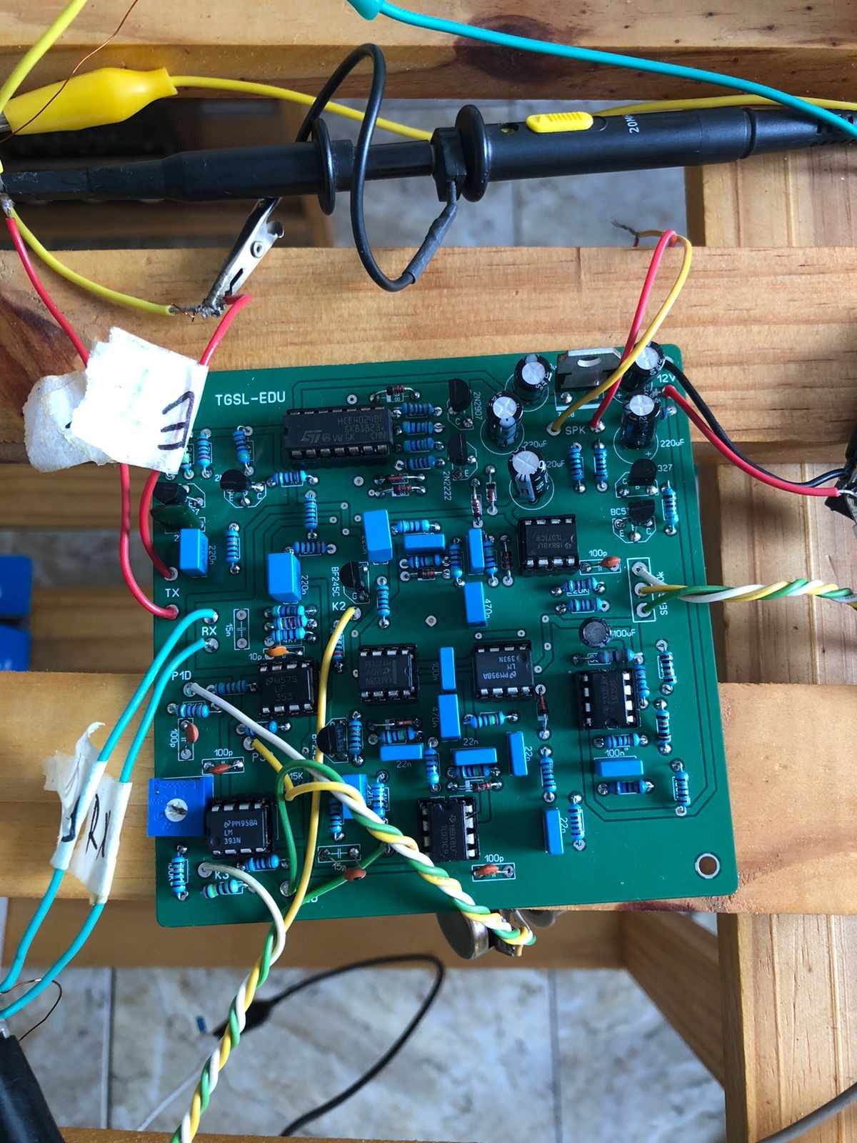

                    • Nice, My coils are 6.0mH and 6.5mH more or less and I made the elliptical format (copied from a tesoro widescan 9x
                      Coil:

                      EDU board:
                      I noticed that I added the TL071 with the 100pf cap, I'm waiting for LM308 that will arrive today to see is something changes in performance (I dont know if these ICs has something to do with it).
                      • I forgot the precise specs, but I think that 071 is not good substitution for LM308.

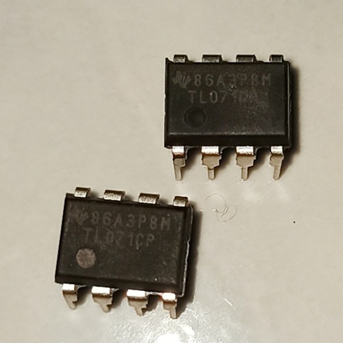

                            Hello Cristiano, at a quick glance I can see that your TL071s are fake.​TL071 original from Texas intruments does not have this half moon​. Follow the image of the original below:​
                            perhaps the same reason why your performance is lower
                            Click image for larger version  Name:	54b2f000-e576-444b-a08a-358dfd524515.jpg Views:	0 Size:	37.6 KB ID:	433082
                            • Originally posted by Emersonpaz View Post
                              Hello Cristiano, at a quick glance I can see that your TL071s are fake.​TL071 original from Texas does not have this half moon​.
                              Thanks, Emerson
                              I'm waiting for LM308s now, lets see if they are real, anyway, imported some more LM308s from other countries to see what we can get.
