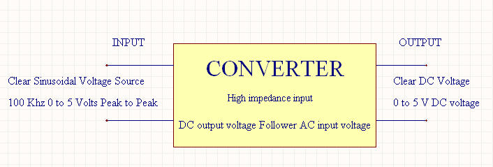

                      hi all
                      can somebody help me for make this converter :
                      I have make inductance meter and need to this converter
                      something like buffer but with convert AC to DC
